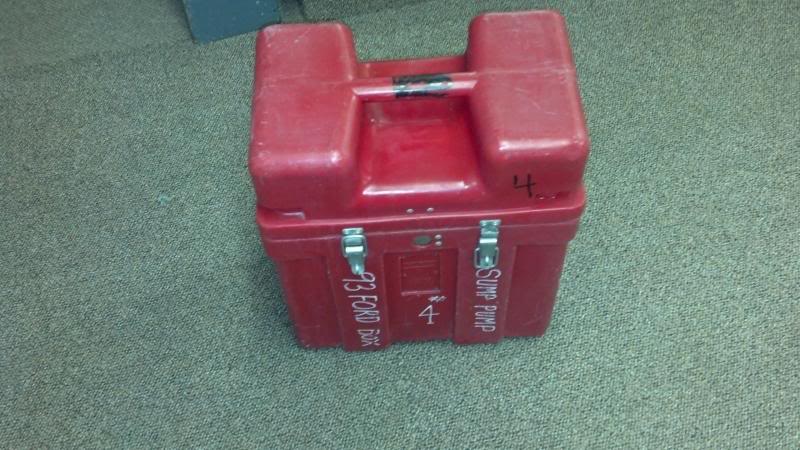

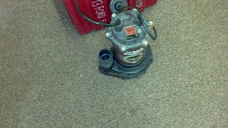

Bill I can't read the label it's either 1.5 HP or .5 HP? Something bought at the big box stores, Lowes Home Depot. We just screw in the PVC barb and you can use 2-inch vac hose off your reel for pumpout.
Cleaning Professional
That PVC nipple is 1.5 to 2 inch. It's usually used to thread into the dump valve .
If you look at the pump the base serves as a strainer and works very well
That does look like a good one. I'll have to try one of those, I like the 2-inch port. You can move a lot more with vac hose than garden hose.
