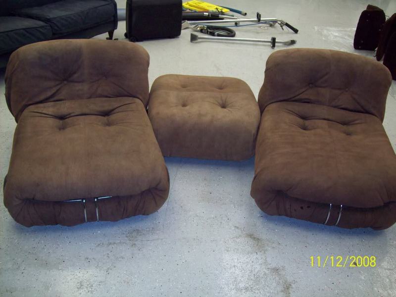

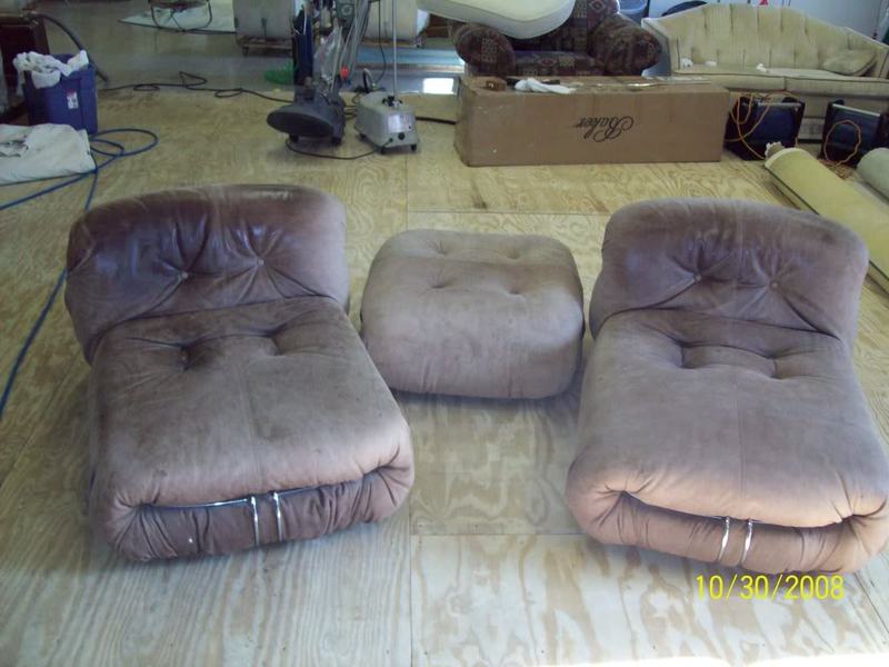

Pictures show the before and after “Leather-Safe” cleaning; it was without any coloring, see how the color comes alive with leather rejuvenating (hydrating and fatliquor replenishing) it!
#1 before
#2 after

Great job Roger. The after pic looks like brand new cushions.
Do you have classes where I can learn to do that?

Roger Koh
Feb 7, 2008
175
Thanks for your interest!
Pictures you see were a job done by someone in Detroit, USA; with the revolutionized leather-safe system made easy.
Well, they have not done any formal leather training yet; only taking instructions to produce such surprising result.
Starts looking for leathers and see how easy it is to “earn and learn” in the real world of leather.
Should be looking for the high-ends leather, the rest would be easy!
High-ends leather would be such as Nubuck, Naked (vegetable-tanned), Pure-Aniline, Aniline Wax Pull-up, etc.

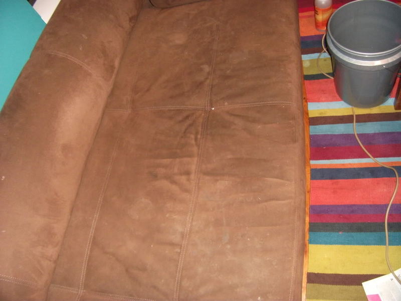

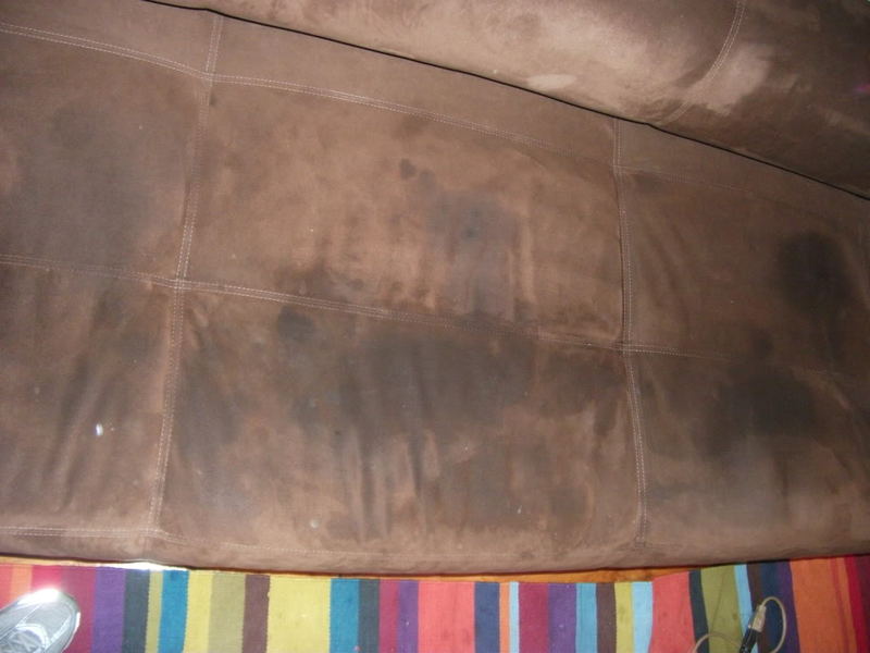

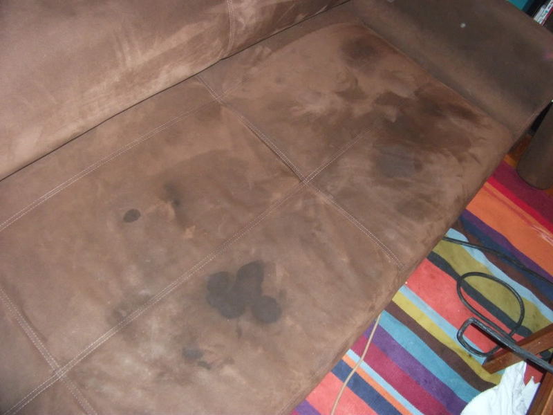

I used a leather master product and just used the foam..i did ok. I thought it looked like shit and i was shitting my pants in the middle but I made it through..and the custy LOVED IT...lol. It was my first one...here goes.
before treatment..dusty and milk and sippy cup stuff..

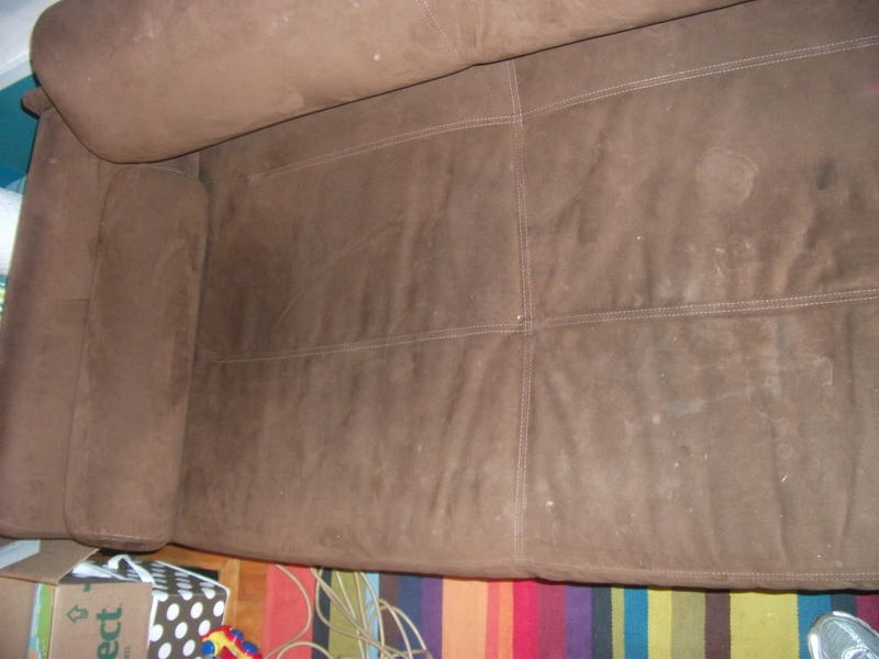

me starting to apply the foam..on dirty spots
me getting gangsta with it all over the couch..i was all in already so I just went for it..i was so scared I was laughing, good thing she was giving the baby a bath in the next room.
finished..and it drying some.

At least the customer was happy and it's good hands on experience, which should lead to less reluctance in the future to tackle leather.
I think it looks pretty good considering.....

The milk wasn't coming off the way I thought it would..other than that, I know i did the absolute best I could.
Roger Koh
Feb 7, 2008
175
Milk is a protein based stain and all protein has this coagulating effect which makes it tougher than most other stains.
It would need a specialty high pH 10 leather-safe cleaner to deflocculate or breaking-up the stain.
Thereafter neutralize with another matching specialty low pH 2.0 acidifier.
All these mentioned products are easily image searchable when Google it for leather, nubuck or suede protein based stain removal kit.
Test it out and you will be ready for the next leather job!

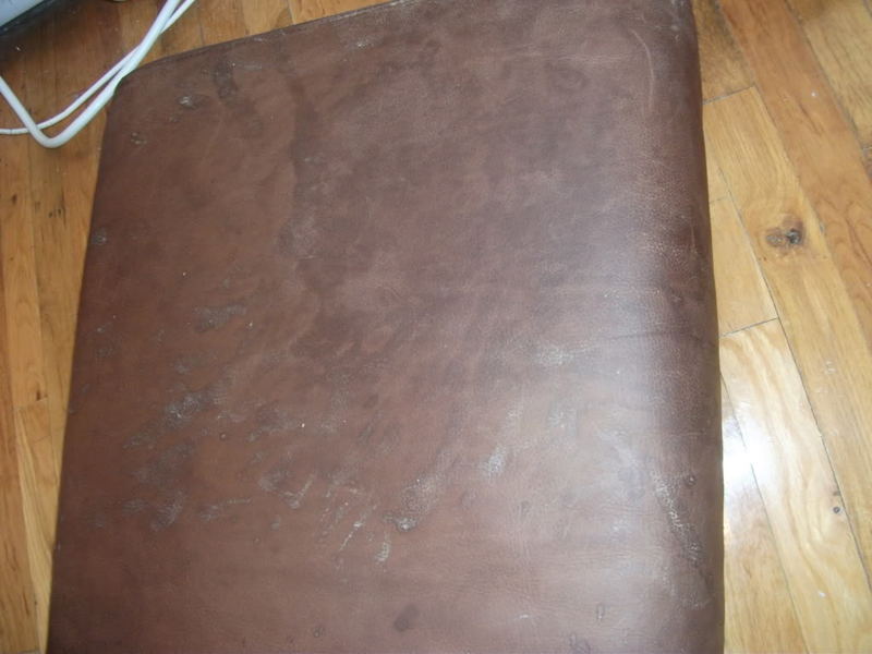

Hey Roger,

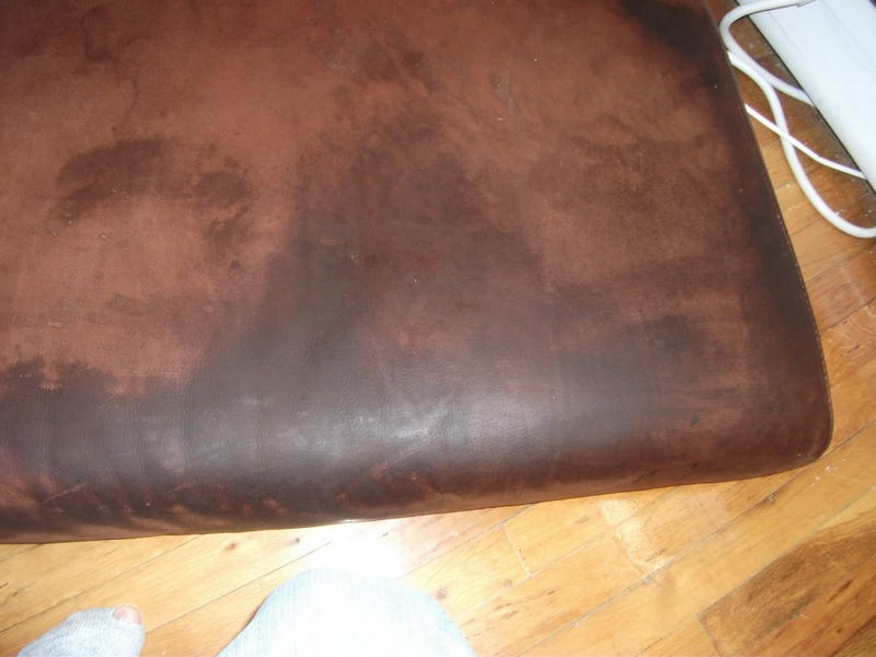

Thanks for your help. I dont know if thats a trick question, but Im going to say yes..what I cleaned was leather. I have this other one with puke on it..
It smelled so bad..I took some molecular modifier from CTI in a towel and over a few days applied it..it got the smell mostly out. After each application, I would use some Chemspec conditioner ( which i dont care for) to add moisture because it would start to dry out. Personally, I liked good old Lexol conditioner..I gotta find some.
Roger Koh
Feb 7, 2008
175
lust1kiddo said:
Hey Roger,
Hey Roger,
These are aniline leathers with a gloss Topcoat-79G.
It smelled so bad..
The bacteria are having a party – you will need a leather-safe bactericide with a pH of 3.7 to sanitize it.
These two conditioners mentioned may have a darkening effect and to remove these darkening side effects you may need a pH 2.2 leather-safe degreaser!
To simplify the processes, here is the recommended sequence.
1] Specialty Protein Stain Remover.
Use pH 10 d’Protein-10 to remove the coagulating protein based stain.
2] Neutralize the pH 10 with a pH 2.0 acidifier.
This pH neutralizing will stabilize the protein fiber by bring its ionic charge to positive (+) so that the hydrogen-bonding with the other mostly ionic negative (-) leather constituents especially the dyestuff and the fatliquor from breaking its bonds and leach out as bleeding and stiff when the leather is dry; moreover it is to control the leather finishes from becoming sticky or slimy in worst case scenario.
3] Sanitize it and Hydrating with a leather-safe pH 3.3 hydrator.
See all those waves marks or solution marks, these could be a combination of the leather constituents of dyestuff and fatliquor that moves away from the center of the alkaline over exposure.
To even out these uneven markings, the entire leather thickness is soak with the leather-safe hydrator and film cling wrapped for up to 72 hours; with in-between wiping and extracting the wick-up foreign contamination and constantly keeping the leather damp.
4] When the leather takes on an even appearance as seen through the clear film wrapper, it is remove to let natural dry with the final wick-up reside removed with a leather-safe Eraser-4.
5] Inspection for satisfaction of appearance.
6] It is now to replenish the original fatliquor and return the leather for the desired suppleness with softness and strength – the leather scented version is recommend for such deodorizing job.
7] Any topcoat surface damages from previous wear is restored with a matching Topcoat-79G.
8] The final finish is treated with a non-stick, rub-resistant protector with an unforgettable classic leather scent.
If you follow diligently these 8 steps to these puke leather, you will never by disappointed.
You would send you customer “over the moon” to see such services…
Image Google search – aniline leather bacteria odor killer kit - and see what you will find…
