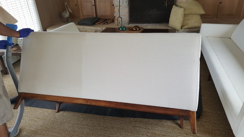

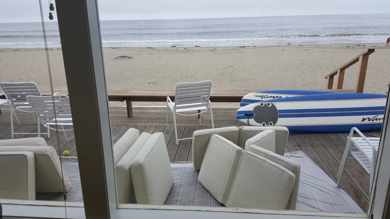

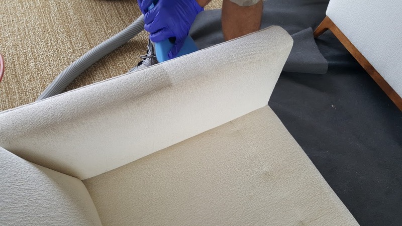

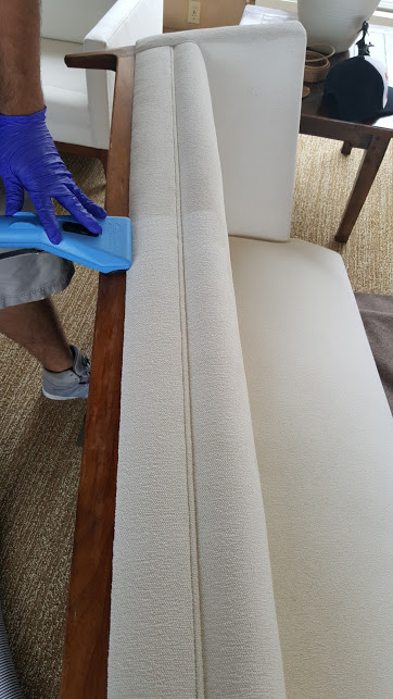

usually this stuff is outside and tortured before we cleaners ever see it.
This was three years old and in dire need of FPA..
which hopefully we'll be applying soon when we go back to do all the wool wtw

Looking at the texture of that fabric-- I think That's my favorite to clean-- as you demonstrated nicely.
