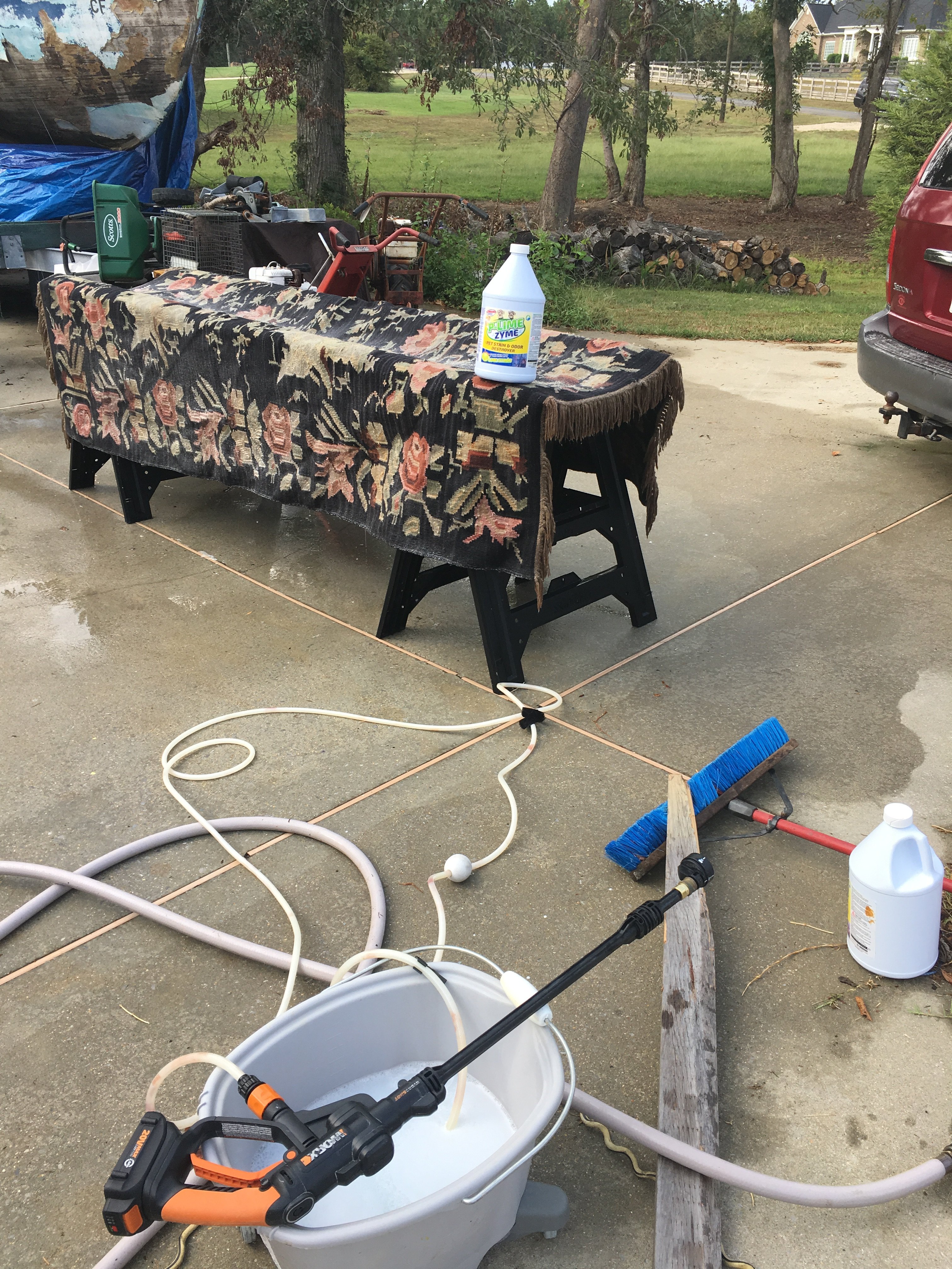

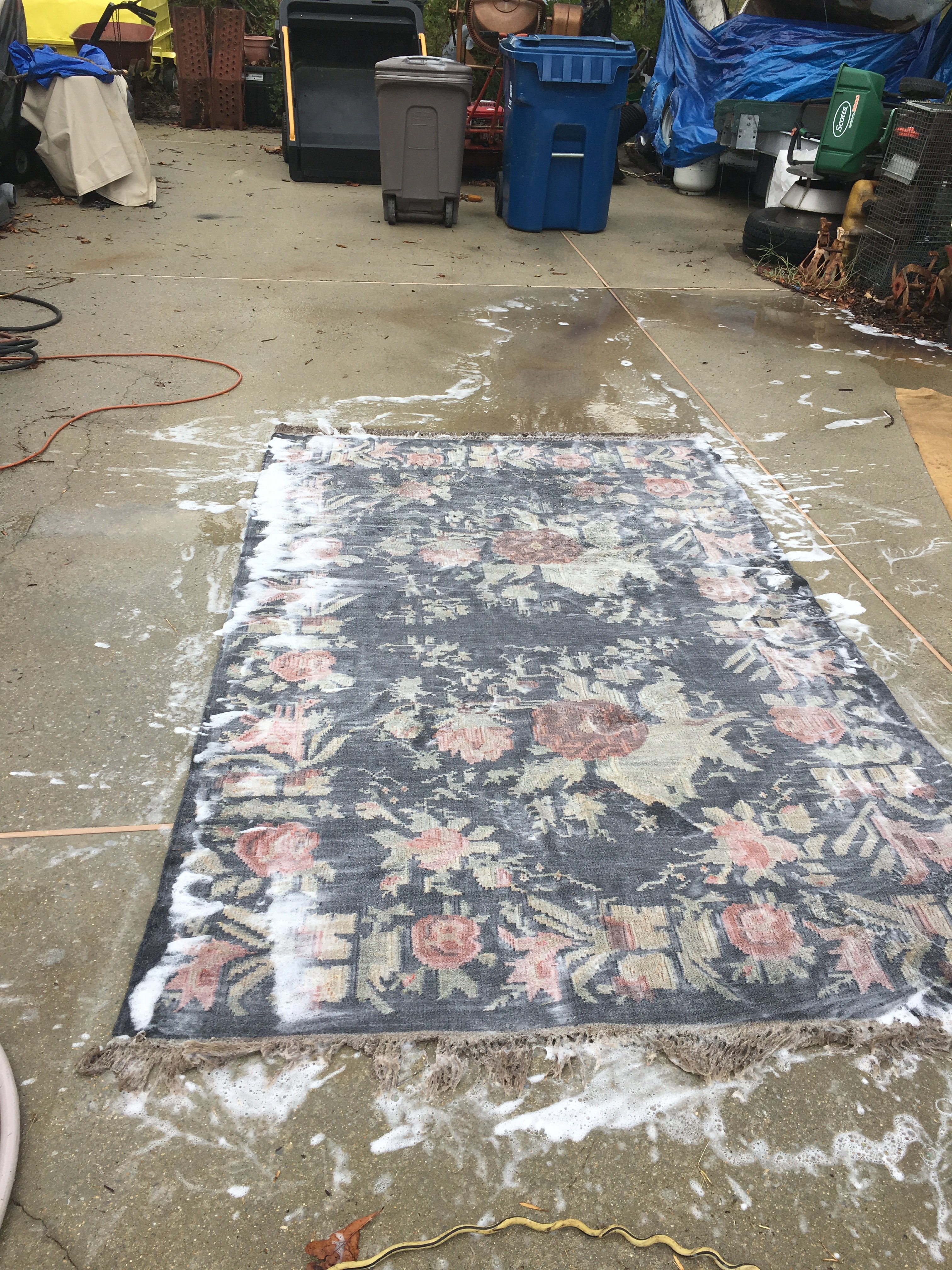

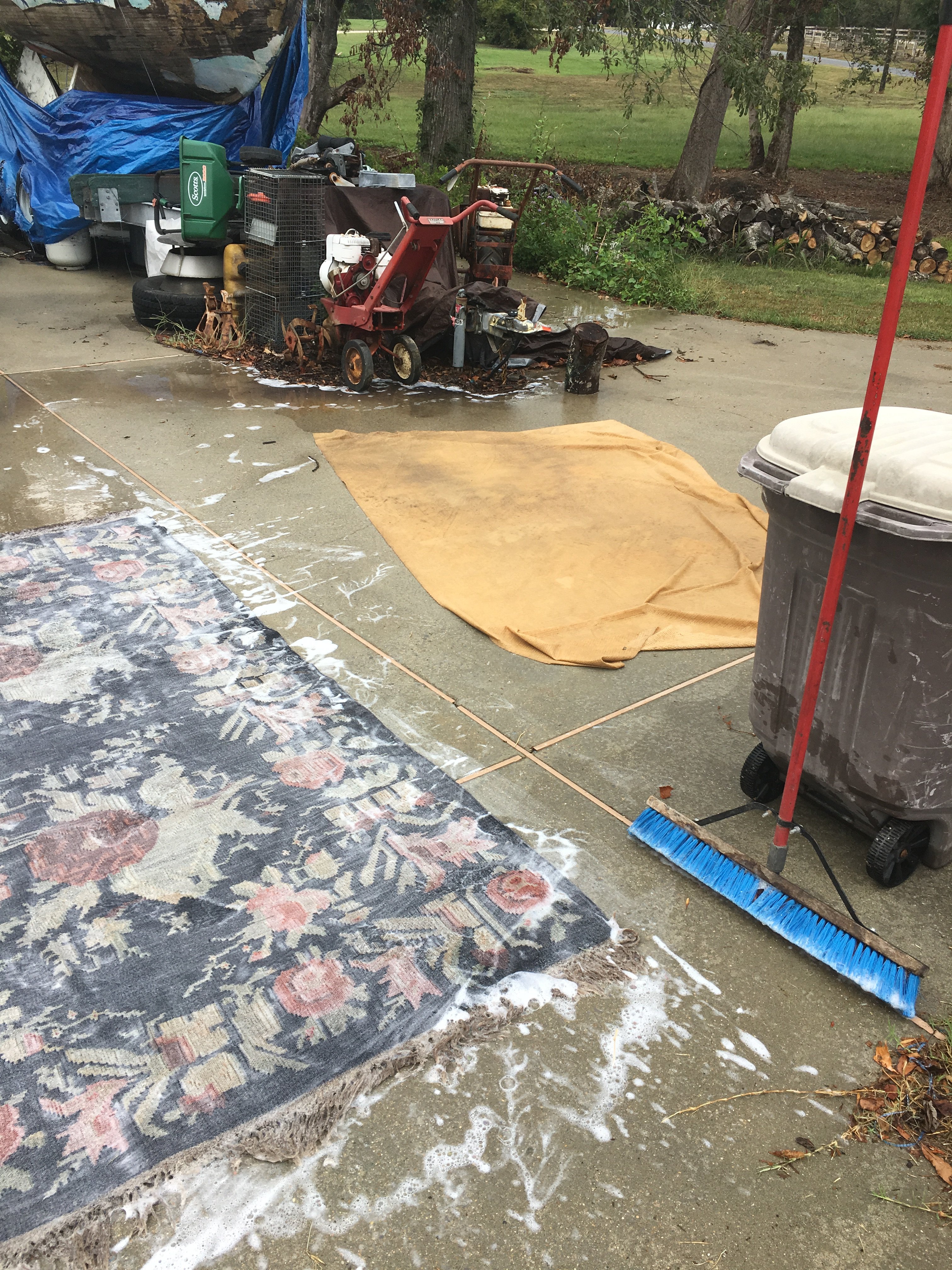

Progress: Took it out of the bag and rinsed it until it ran clean. Then I applied 4-1 mixture P-Lime Zyme and brushed it in, timed 30 minutes, flipped it and repeated. Rinsed until it ran clean. Then I put it up on sawhorses, rinsed it top and bottom and applied P-LimeZyme top and bottom with the Worx Sprayer.
The mat I bagged and tossed; screw his cheap ways.
The rug is nearly piss odor free, but rather than use a combination of other products I intend to rinse and apply P-Lime one more time and see how it smells afterwards.
