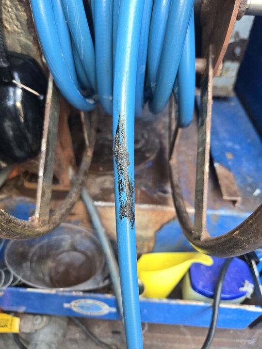

The parking lot splooged a bit of tar on my solution line. I'll watch out for the patched areas when I am laying out my lines from now on. Any solvents you guys have found work really well at getting this stuff off?

I use pog on a rag. If i need something a little stronger i use rubbing alcohol. But pog generally works well. Use a wet towel afterwards to remove the pog
Reactions: Bryce C
50,032
Acetone from your paint store or Lowe’s or Home Depot.
No it won’t soften your hose like somebody’s going to say.

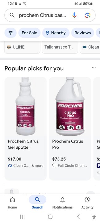

Forgot to mention (because i use it in place of pog) is citrus based spotter. I use pro chem citrus pro and citrus gel(gum remover) to remove tar stains on my hoses because it worksand is on my truck. But when i do it at my shop i use odorless mineral spirits. Only because it works and is handy i have a part's washer with 30 gallons of the stuff handy

just get some goo gone and a razor blade. spray, scrub, and shave it if it doesn't come off

The day it happened I wrapped some painters tape around the tar splooge to prevent any further catastrophes.
