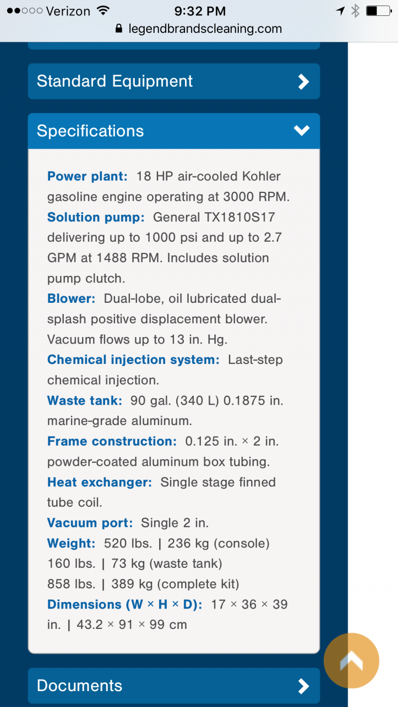

what's it weigh?
Nice low mile 1/2 ton vans are much easier to find

It is not 800 lbs. I pulled mine out of one van and slide it down motorcycle ramps. I then slide it up motorcycle ranps into another van by myself . ( of course I am country boy with alot of grit and used ropes ) 1/2 ton van works great for these little machines
