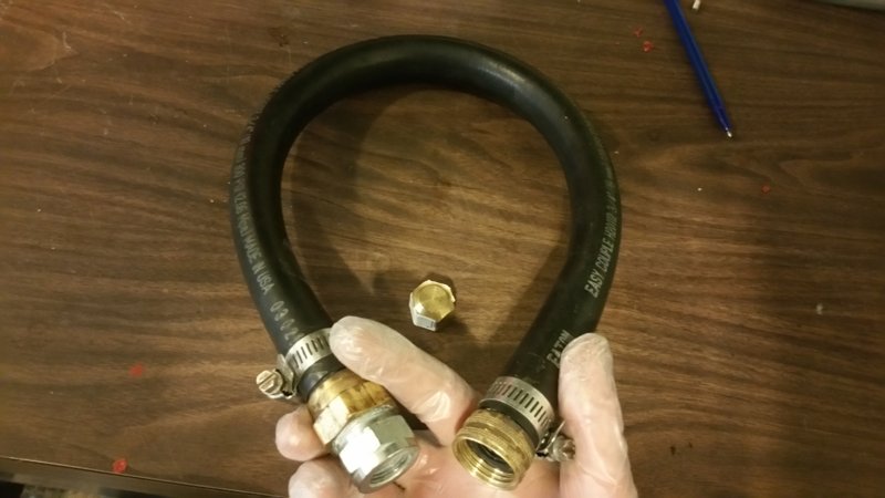

If you are not able to run the unit you can make up a hose and pressure test it with the pressure from a hose(though it's not high pressure).. From the coolant HX'ers I have seen go bad regular hose pressure will be enough to let you know if it's broken..
Here is the one I made up for prochems..
Cap one side and water hose on the other..
Note:I did a brake job on my car today so I had to put on the rubber gloves for the picture. I don't need Nate picking on my rough dirty hands with no fingernails..:lol:

cap off outlet of sol side
and make a plug to inject air into the intake
listen for a leak
