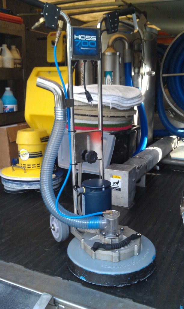

Just curious. Why the black tape or whatever that is around shroud?
It was originally a demo unit from Jon Don. Before I used it I put some painters tape and then black duct tape to protect it. Never took it off.
We were demo'ing the unit on 70k sq ft of cubicles. Figured it would get banged up. We actually did pretty well.

The hose is too stiff. It has to be long enough so when the handle is lowered it still has play in it. The result is an ear punishing noise coming from the o-ring under the center plastic vac port. I had it working for a little while but the hose will move further on the two ports over time. Maybe needs another 3-5 inches to have some play - but this will cause the hose to stick out farther than it already does. Not as functional as it is pretty. It also may soften over time.

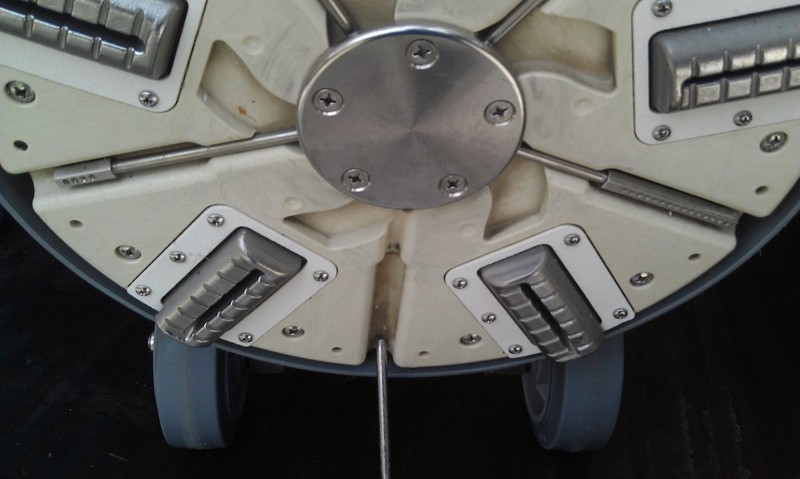

got the new generation Hoss in for the second truck....some good changes were made....
the handle bars are 2 inches narrower and are turned in some....I wish they would of turned the vacuum hose connection a little more inward so the hose did not stick out so much and have to maneuver it not to scrape the door jambs....
glad to see they took that trigger guard off and put a slider switch guard (?) on it...
I had to unscrew the other one and bend/tape it out of the way because it would hit everything real easy.....
also noticed that there was a grease fitting and a grease breather in the gear box....( the older mode did not have this )
they went ahead and wired the motor and put a twist lock on it...much better then having people try to wire it them self's....
replaced the site glass with the blue one that is supposed to handle the chemicals better...but I am concerned about the rod..that did not change...broke 2 of those already....
got the kit and went ahead and pimped out my older one....
hose was stiff but the length was fine.....

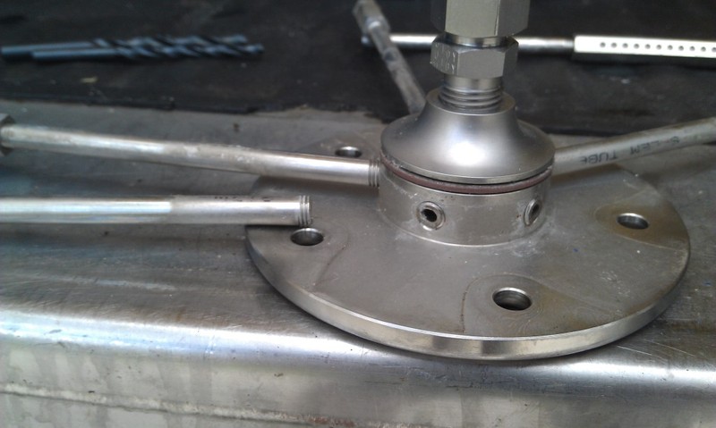

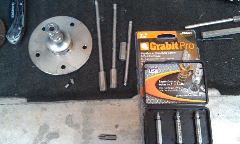

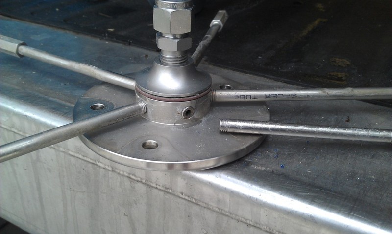

Had a small issue yesterday. One of the large bars just broke off while cleaning. I have no idea why, was working on a thick short plush carpet. Then was trying to take another large bar off and it broke as well. I got the other ones out ok. I'm going to switch to all large spray bars and make sure to anti seize on the new ones. I would suggest others do as well. Scott was very helpful at Sapphire Scientific. He is replacing those rods with the new thicker ones. I will have an extra one around in case of
I had never used these type of easy outs before - they worked very well. Thought I would share in case any one is looking for a good set.
Jim Martin
Arizona
Jim Martin
I pound mine...every day on every job..it has been on every type of carpet out there and no problems with a single bar.....the ones that broke on yours...were they the small ones or the longer ones.....I have all longer ones on mine....
