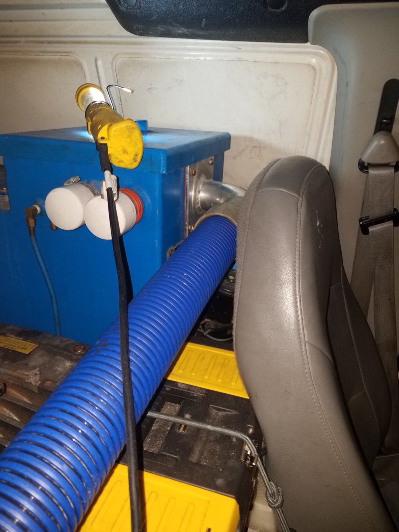

I would mount it to the lid.. I was having some issues so I decided to mount it to the side.. The issues I was having had nothing to do with where it was mounted.
14,546
My lid has a 2.5" opening capped off, but I can't find a good 90degree like that one

Keith, wouldn't that flow better with a straight shot going into the waste tank? Remember Mike talking about air flow and using the Y's. Do the elbows restrict flow?

Doesn't matter two 2" hoses have more inside area then 2.5 hose, it's a wash that close to the machine.. It isn't a tight 90 more of a sweeping 90..
14,546
Nah...if I'm gonna go 2.5 from the machine, I want it all the way to the tank

You could also use a PVC bulkhead fitting also if you wanted a straight shot..
