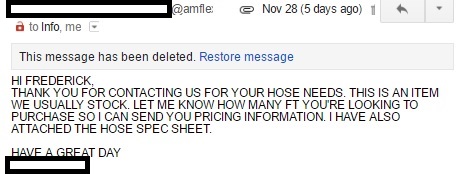

When I asked Amflex a few days ago if the hose was available from a more stable supplier they told me it was in stock and asked how much I need. So direct from Amflex may also be an option

If you are going to go 2.5 don't cheap O on the hose, I only know of AMFLEX and because I have used it I can tell you it is more flexable than some stock 2.0 that comes with some TM's. When I was all into this stuff the Amflex 2.5 was so fleaxable I ran it right to my wand ( I wouldn't do this now but I did at the time) The wrong 2.5 will BREAK YOU in a weeks time it is NOT easy to deal with and in the cold weather the coils as your rolling it up can flip and put a huge dent in a car that well you would have to pay for.....Its coiled strike is faster/ and as lethal as a King Cobra on a hot summer day!!!

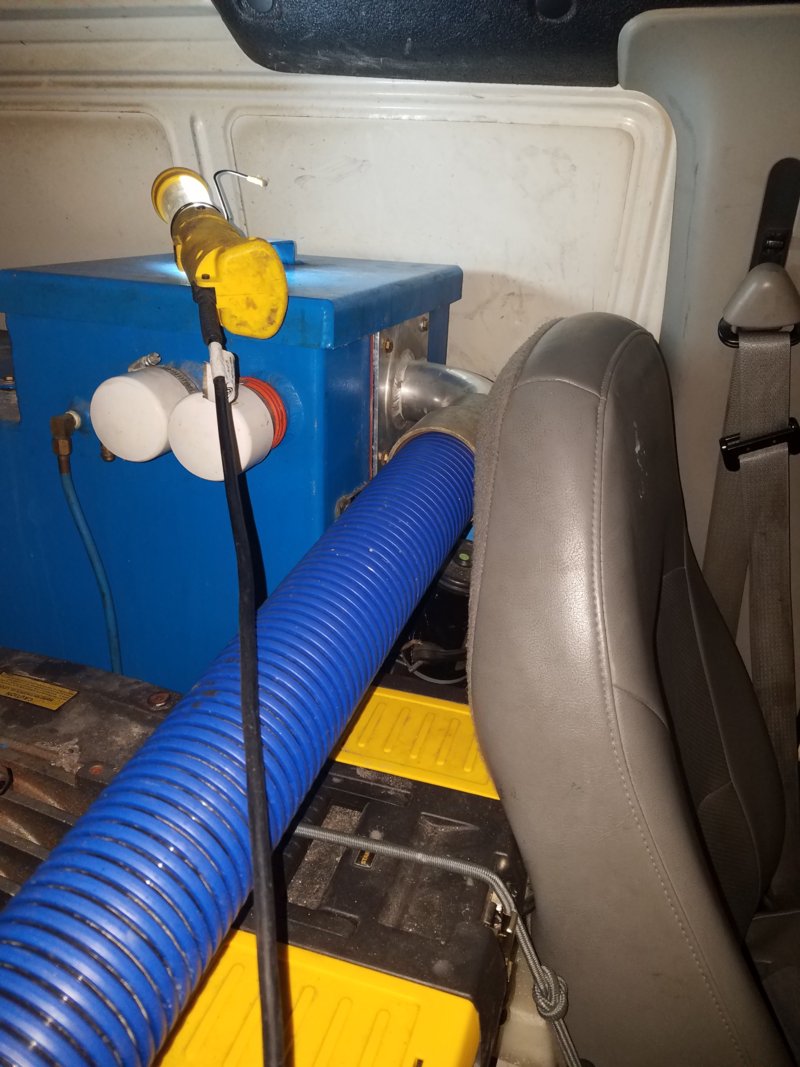

I'm going to 2.5" too. I've had 100' of it sitting in the shop for a year now.
Devastator Tom allowed me to swap the 2" setup I won in Nashville for a 2.5" version. It came in this week.
What's the best way to get 2, 2.0" ports from the top of my Cleanco waste tank to 1, 2.5" port on the Devastator?

Hey Russ I have the same cleanco truckmount setup that you do. I run 2 8 foot sections of 2 inch hose to the Devastator that has a double 2 inch intake on the truck mount side. On the other side of the Devastator is a 2.5 inch Outlet. The nice thing is if you have a lot of 2 inch hose you can continue to use it directly to the truck mount if necessary for something like a water damage extraction and you're not modifying the top of the cover of the waste tank.
Thanks Jim. Tom just sent me a shiny new Devastator that's 2.5 on both ends.

What attaches to your tm?
My filter box is at the back of my van with 3 two inch ports. Ive attached 2 6 or 8 ft sections of 2 inch to them that run to a y mounted beside my vac reel. That y has 2 two inch in and one 2.5 inch out. On my vac reel I have 3 50ft sections of 2.5 and one 50ft section of 2 inch so I'm always running 2 inch my last 50ft but everything else is 2.5

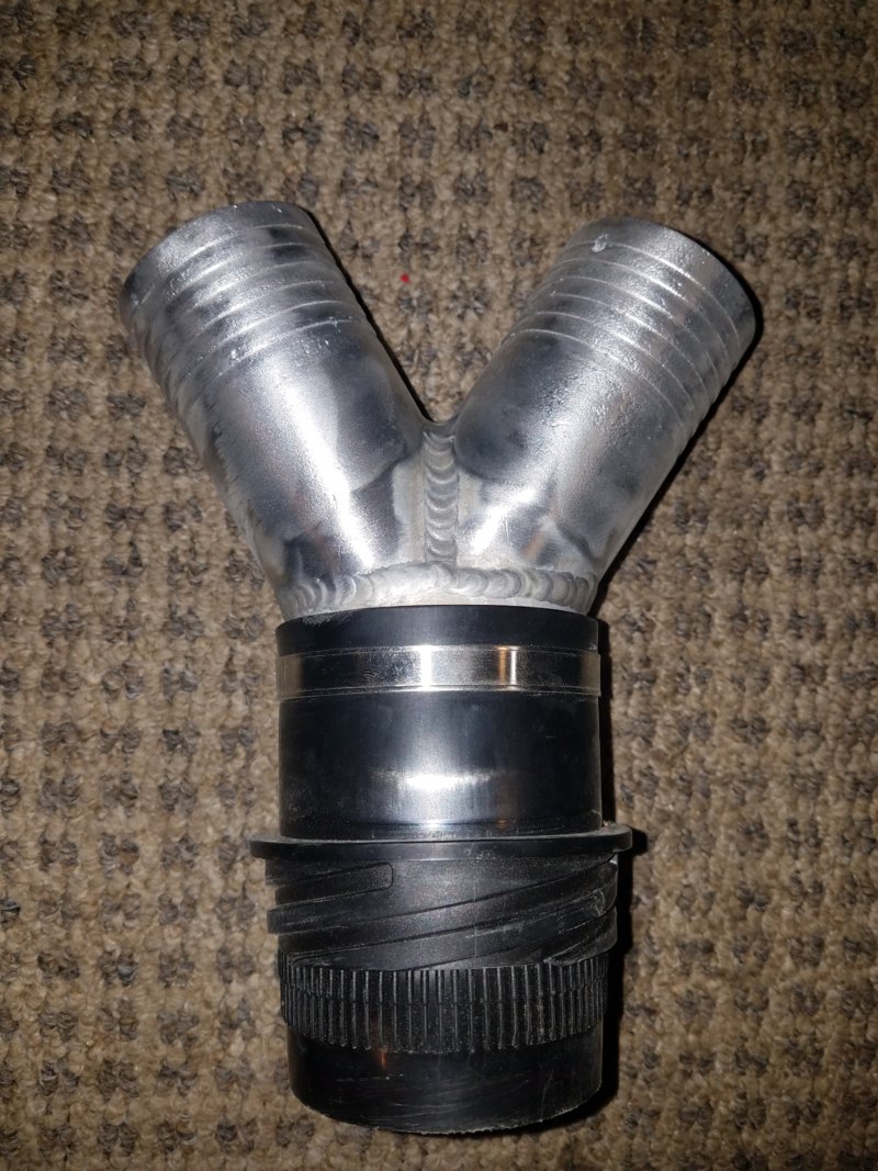

If you want to try it out I'll sell you this for $40 plus shipping..
Able 1
Apr 12, 2008
6,469
Keith
This 90 is sold by that guy in California, CMS or something I think Greenie worked there at some point?
