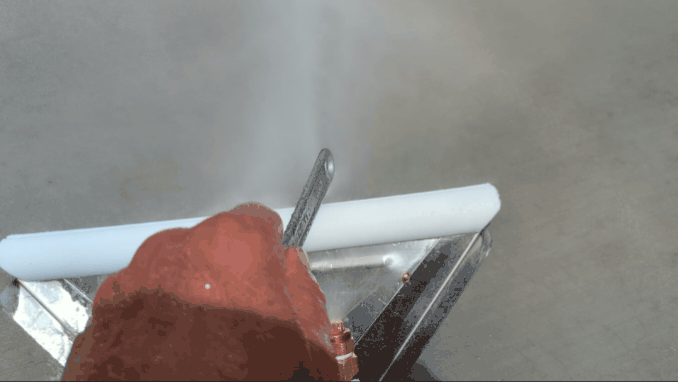

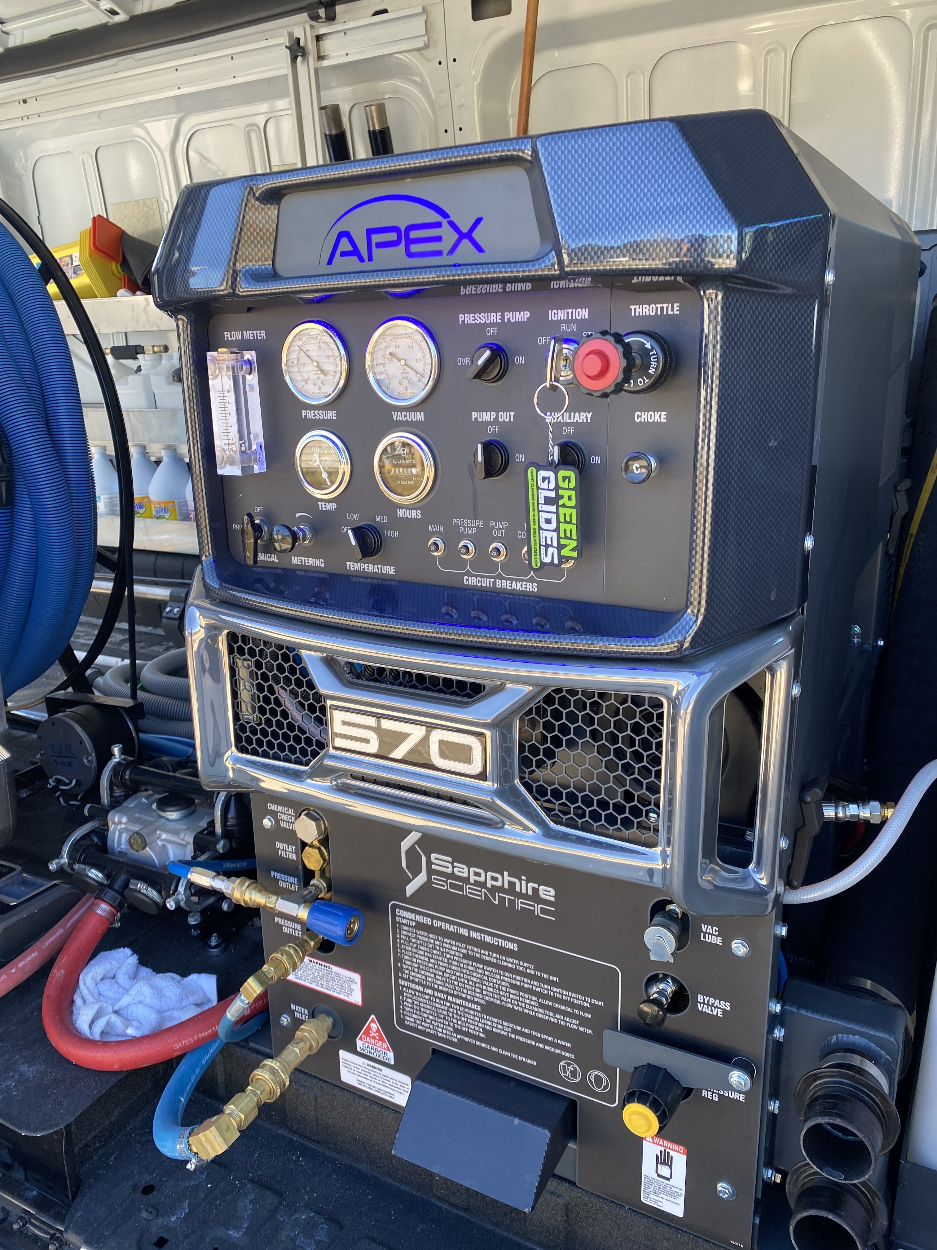

At 100-150 they all feel the same to me, with exception of a 33 blower. The 570 definitely put out more heat, but the extra CFM didn’t seem to benefit on those residential runs… that’s why I didn’t buy it. All the steam looks cool, but I’ll take 180 and just scrub first like I should anyway.
If I did long commercial runs, the 570 would’ve made sense.
