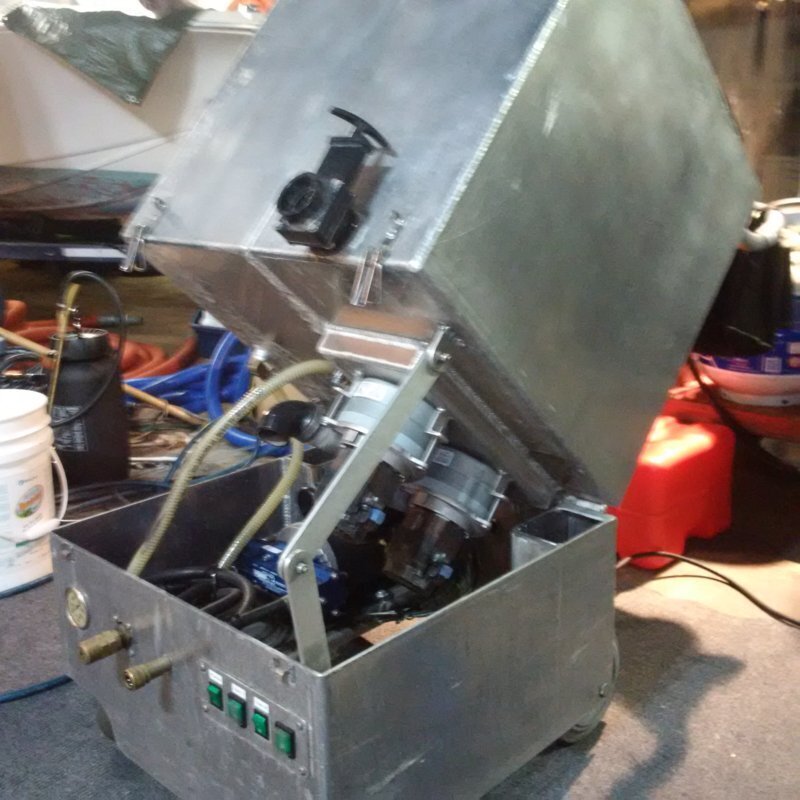

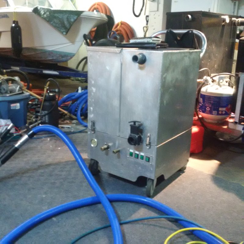

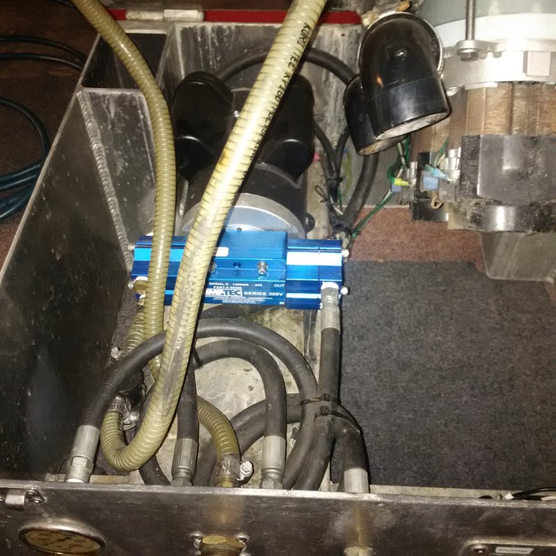

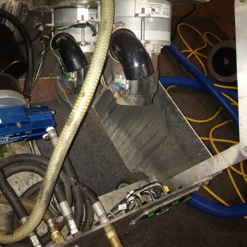

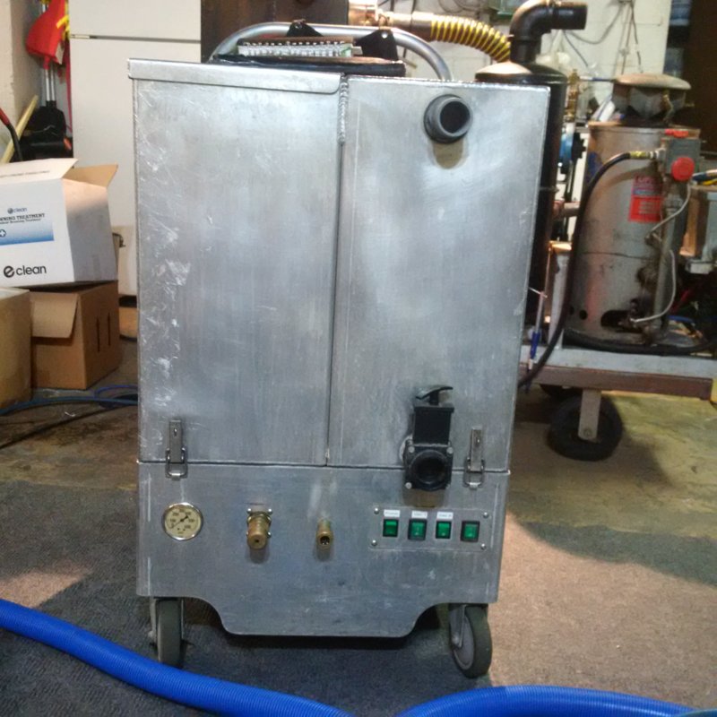

I couldn't find a portable to do what I wanted with out blowing all the circuit breakers, so I built my own. 24 gallon solution and recovery tanks, 500 psi pumptec pump that lets me use a 5 flow wand if I want, 2 hp 3 stage vacs in parallel running through a custom manifold lets me hook up 150ft. of 2 inch hose and still have more vacuum performance than a standard portie. Takes 2 days off a 64 floor complex that I do and does a better job.

What did you use for tanks? The classic problem in building porties....

3/16 marine aluminum.

Internal pics are a trade secret. Heater is external (edic heat and run) weighs about 150 lb's. Elevator's only, doesn't go up and stairs easily.

Sorry for the extra pics, pushing all the wrong buttons. Will take some interior pics
28,101
Here's some interior pics

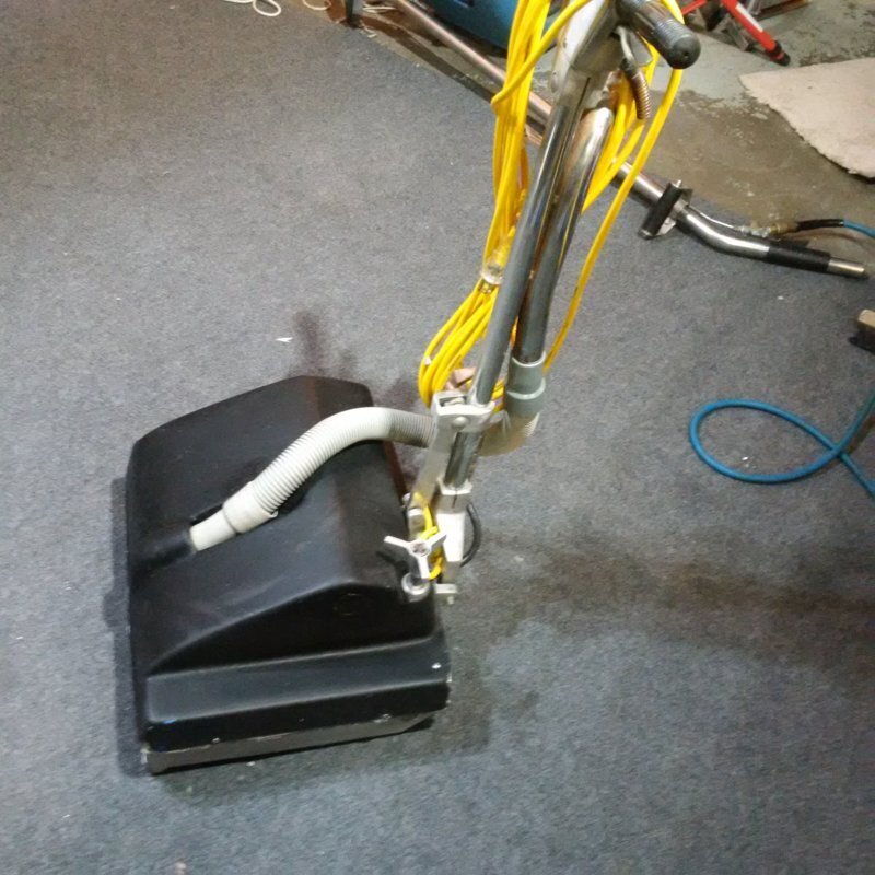

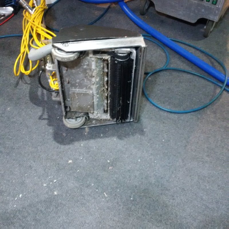

Showing my age a little but when you really need to get the job done, you use a steam valet. 14 flow, 1/2 hp motor driving a cylindrical brush, old and slow buts eats rotovac's for breakfast.

We had the EDIC version of that... I haven't used it and actually tossed it after I was done trying to make it better.. I guess it was good for its time..

I can vouch for Ron's homebuilt porty. Awesome machine ( I took pics at DK one day and posted them here before I knew it was yours Ron:icon_redface:)

@Cleanworks
Looks like a great porty. You obviously got a much better grade in fabricating classes than me. I really like the simple design. I can bet it would be more than a handful on stairs.
