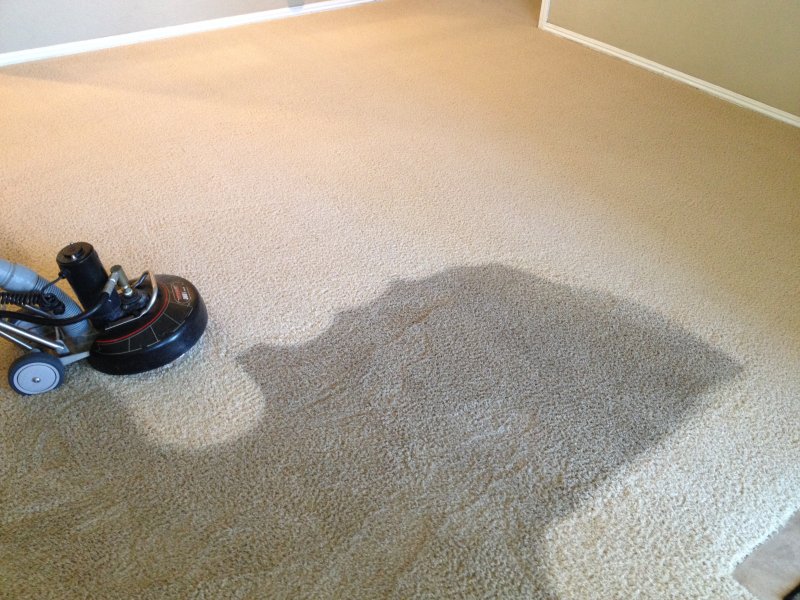

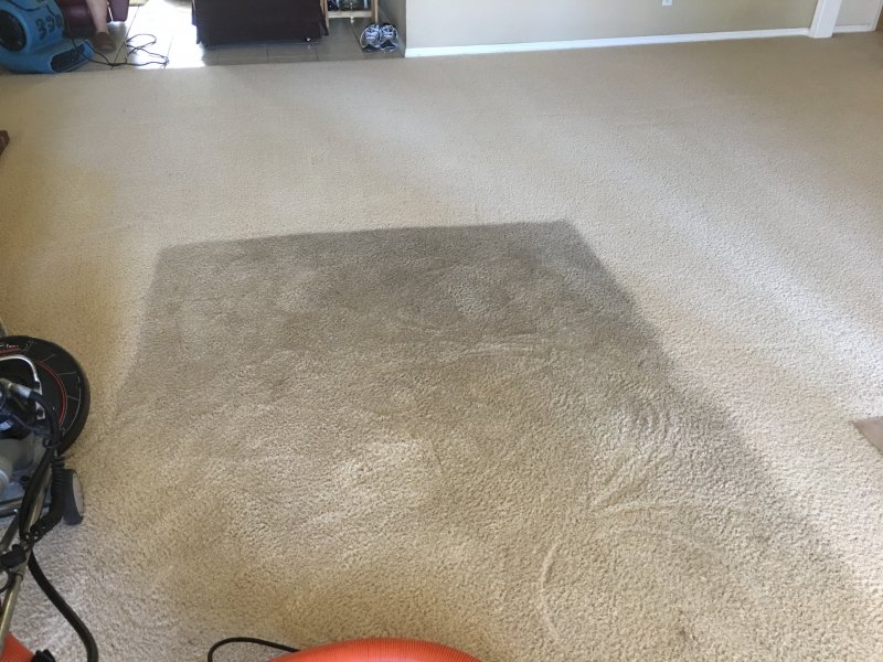

This was my Rotovac job today while the bottom picture is of the last time I cleaned it.
