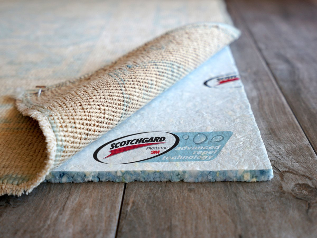

I guess for urine issues it's good to have for protecting your subfloor against contamination. But for flooding, it sucks. I have a place where the hotwater heater gave out and flooded about 30sqft of closet and entry. I got all the carpet dry but am spending a second day drying out the pad. Everything under that pad got no airflow due to the thin plastic 3M liner. Something simple turned into a 3-day adventure. I'm not big on this type of pad after seeing how is locks in the moisture.

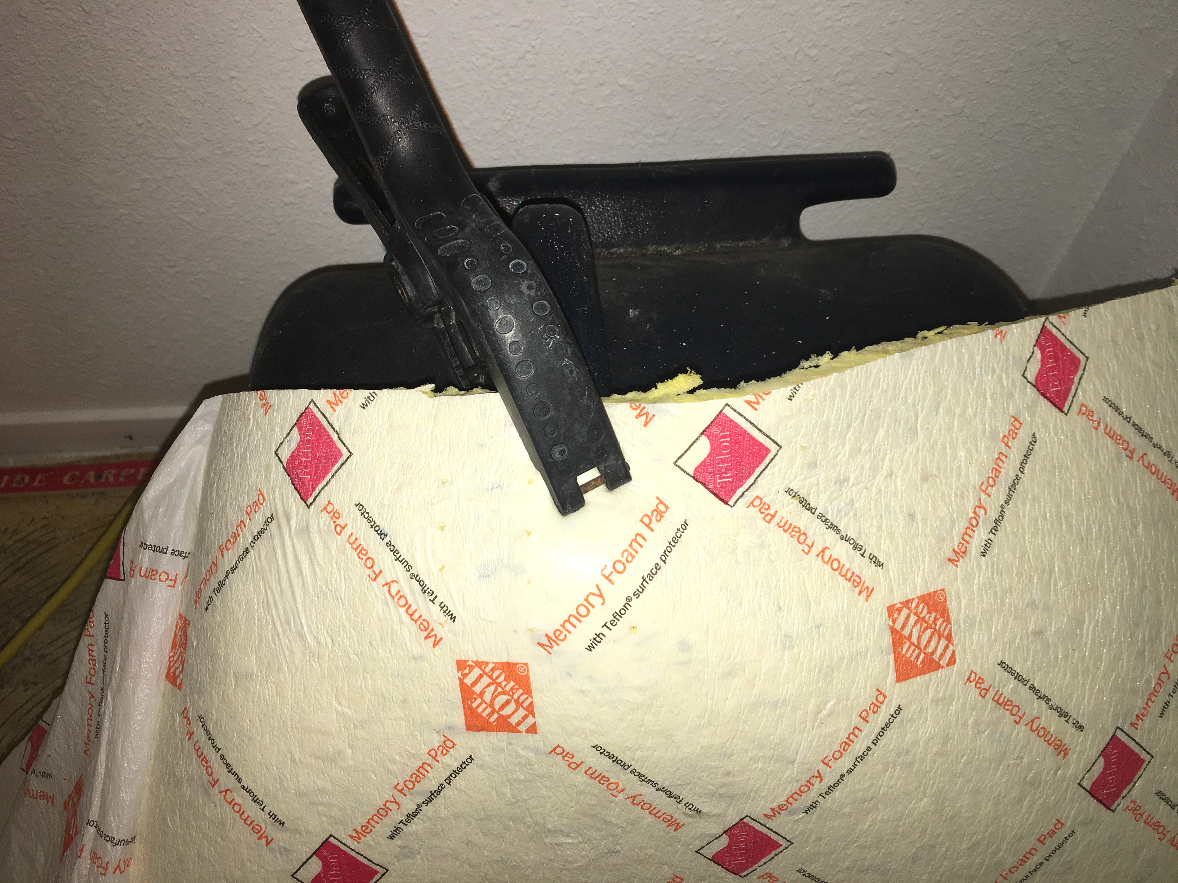

Went back this morning and everything was dried out. Collected my fans and patched everything back together. I took a pic of the actual pad. It was some sort of Home Depot teflon stuff.

Interesting that it says 3M Scotchgard on one side and Teflon Protector on the other.

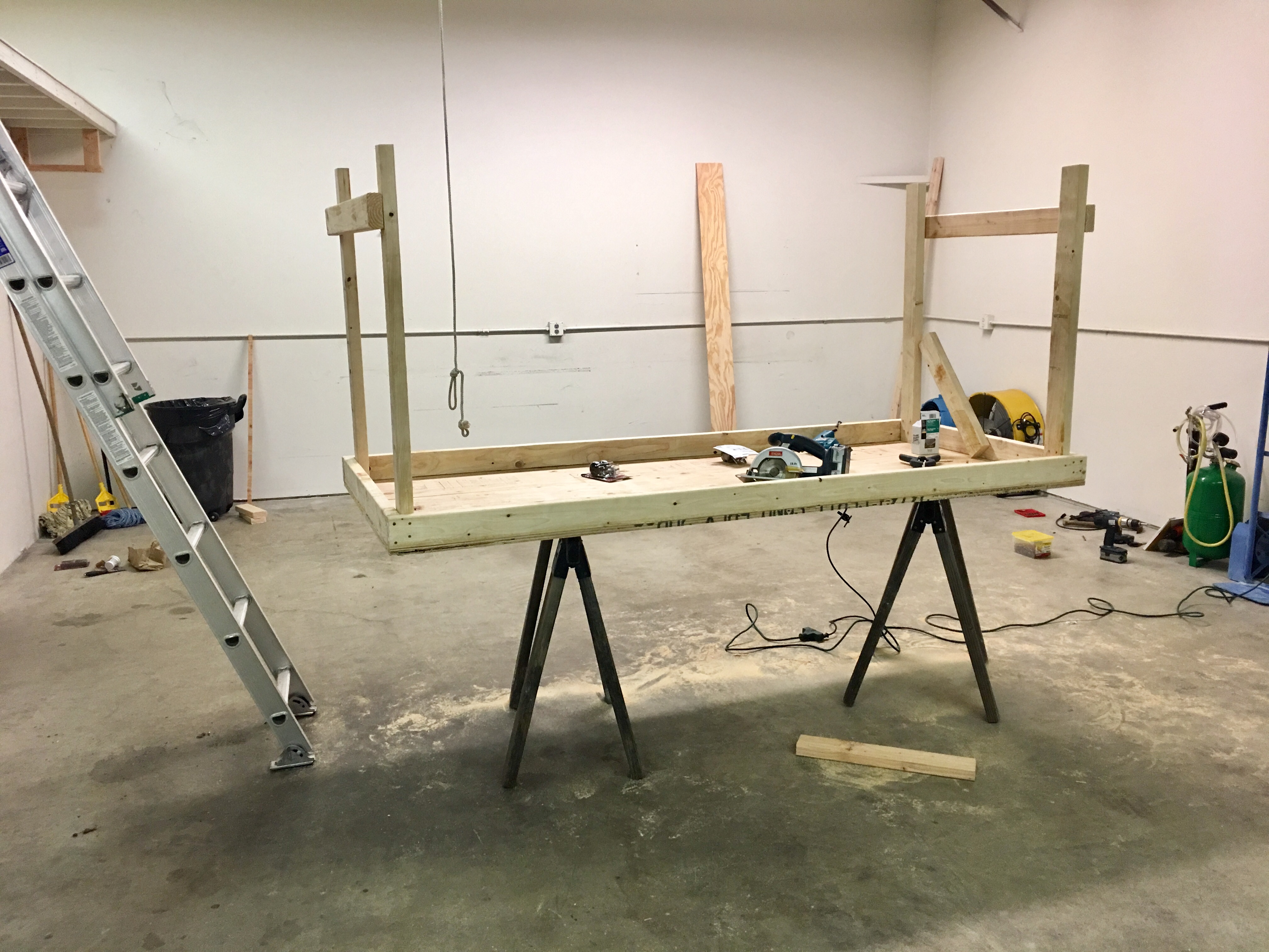

way too much effort to build a shop table. I just use framing joints and connectors. That would be built so fast. And plenty strong

Oh i’m just beginning. All screws are counter sunk and holes will be filled with wood putty. The bench will be sanded and stained three times. Then four coats of urethane will be applied with 400 grit wet sanding between coats.
