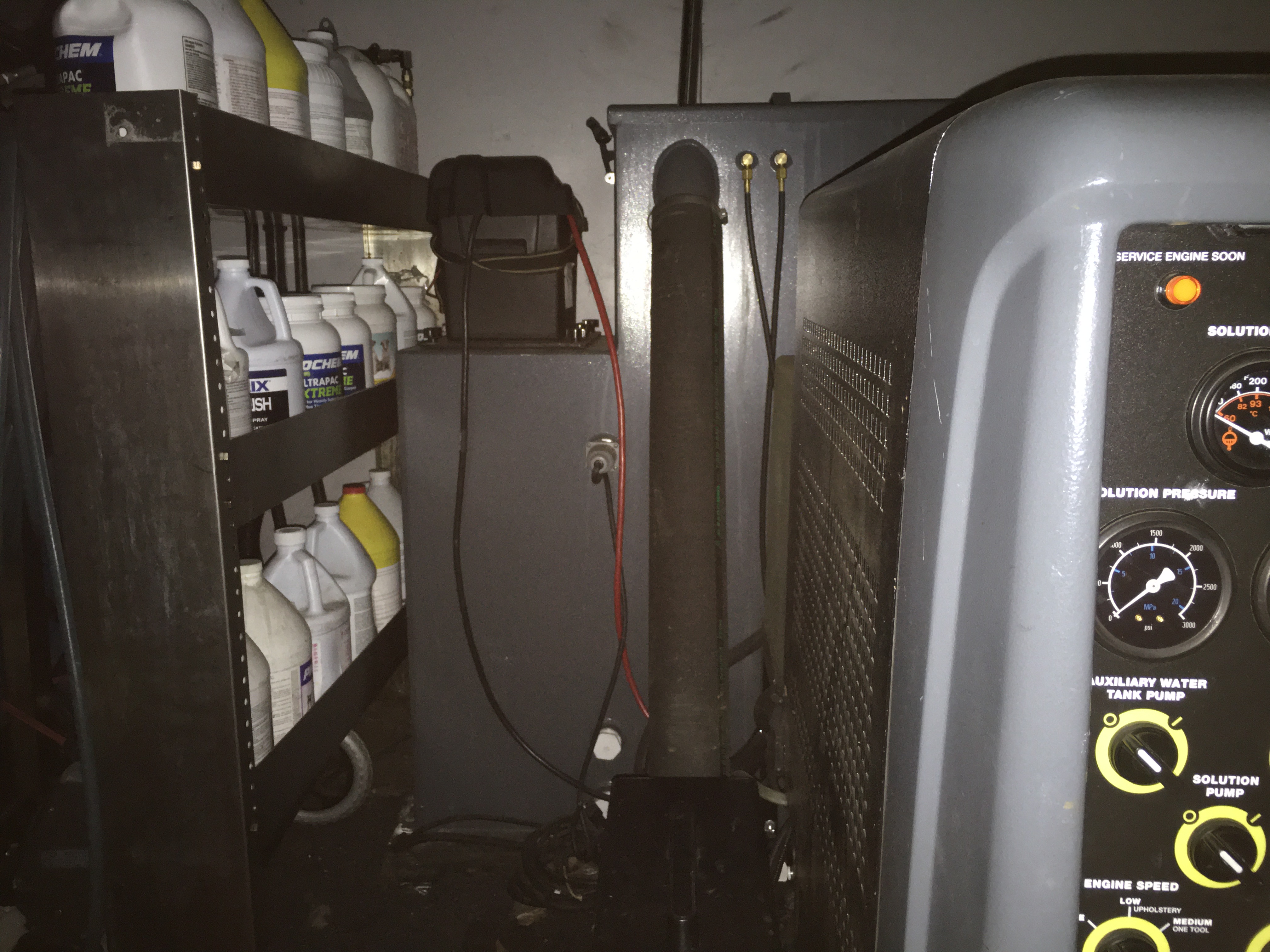

The filter box on the floor next to the truckmount
13,732
Georgia
Is an awesome filter, BUT... it’s in a terrible spot!!!
Can any of you truckmount manufacturers comprehend the statement, “ITS IN THE WAY OF ACCESS TO OUR MACHINES!”
I see some of the steam actions have it routed next to the vac reel where IT SHOULD BE!!!
Does anyone else agree? If not, you probably never work on your machine
23,897
Redding
Poor Matt
13,732
Georgia
I like the basket filter, just not the location. The hoses and water pump underneath the machine have very little access and they could’ve designed the waste tank to where it pointed out the back
I don’t want that goofy looking inline filter
I already had several in the past. The basket filter is the best.
13,732
Georgia
Can't you just unbolt it and move it? Your machine has plenty of power, it's not like it would affect your results any. I'd move it back to the reels like you want.
Nope. I would have to install a 4”diameter elbow pointing to the back. I don’t want to do anything like that.
