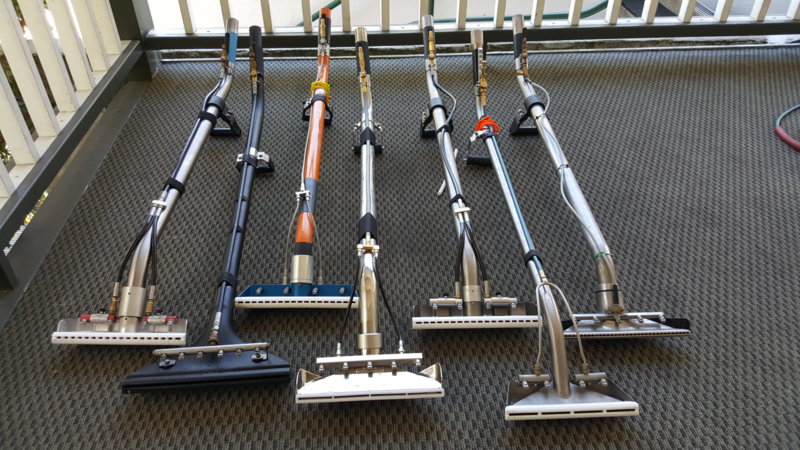

If you recall Tom when I dropped the pressure from 650 to 450, the SS12 spray pattern got way better.
Tom's wand score big points for jet/ manifold adjustability.
The Dang, Mytee and Interlink were totally non adjusting.
We all agreed that the Mytee handle should have been on the other wands
They all cleaned well with no noticeable streaking or soaking

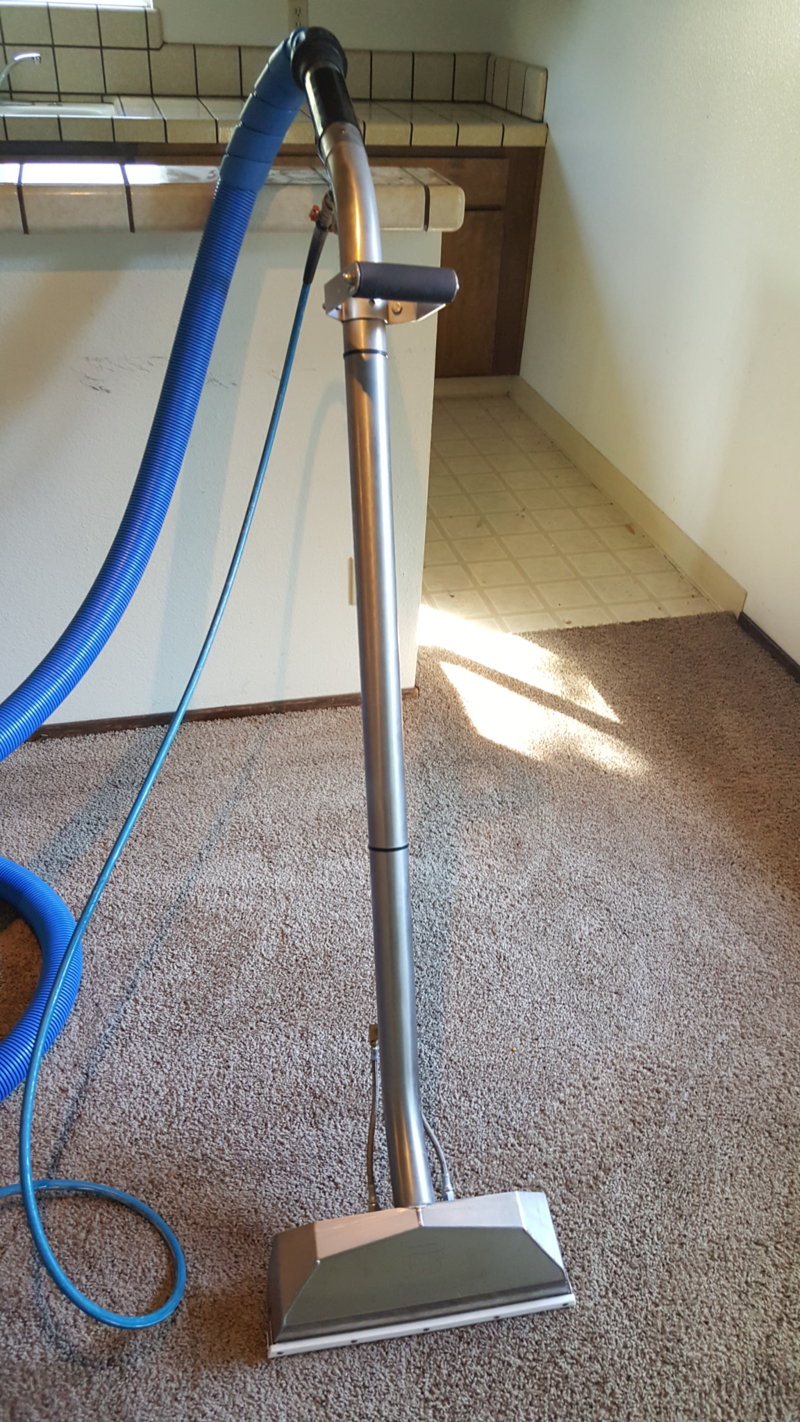

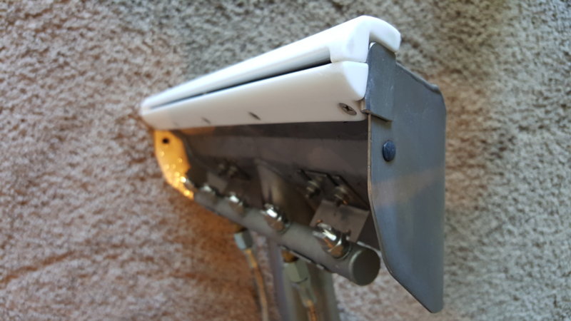

While worthless when the 370, its VERY NICE when the Vortex.
Manifolds need a bit of adjusting but at 15" this thing is a production workhorse

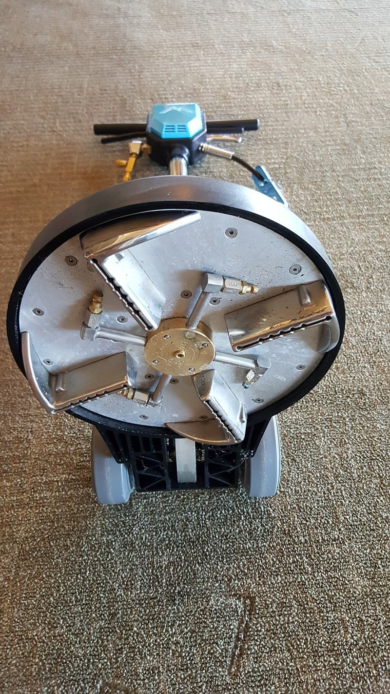

I forgout to mention the TRex Jr..
The mini RE was a life saver today in the worse of the worse areas. Very smooth, great recovery, very aggressive.
I can't say if it's more aggressive than a RV brushhead based on just one greasy CGD job, but its far more than a regular RV or HOSS.
Probably just needs a few inches of brush strips under there...
I would like to see the speed adjuster beefed up and relocated.
Also a clear tube would be more effective than the clear elbow for seeing color and flow.
The extra ten pounds over the 360i was noticeable in use and transport.
Does the TRex come with any type of teflon/plastic glides? My RX20 old style was a scary tool around ceramic and wood transitions. Then I got the GGlides for the RX, and those made it a lot easier and safer to use around hard surfaces.
Now, my Hoss is a lot safer with it's teflon interchangable glides.

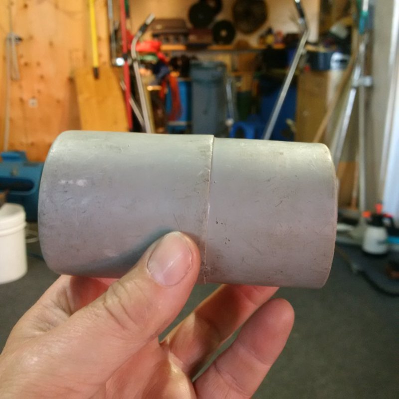

Very close, the SS has the edged do to the forced 2" hose use
The Mach 12 has a 1.5 cuff, the SS12 has 2"
The one piece round glide on the SS leaks less air.
The SS manifolds are not as adjustable
Same valve and assist handle
I have been looking for a new 1 1/2 wand. I was looking at the mach 12 but if you think the ss 12 is better, I can get locally. Seems odd they would have a 2 inch cuff on a 1 1/2 inch wand but I have adaptors that let me use a 1 1/2 whip
