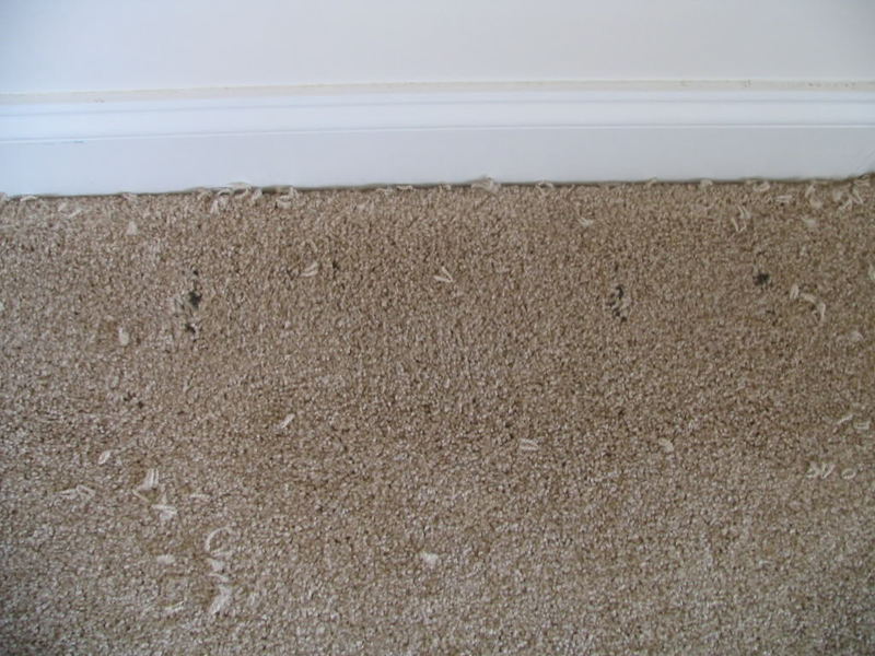

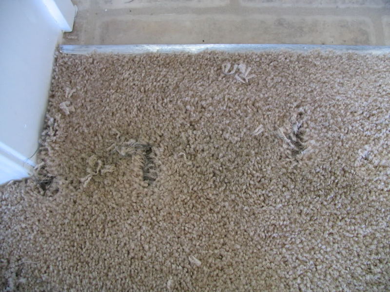

Thought this might be an example of what can happen when someone does not set the pins of a power stretcher far enough into the carpet. The consumer was baffled by this and could not figure out what was wrong with his brand new carpet, it was losing tufts when he rubbed his hands over it. Just sharing an interesting power stretching situation.

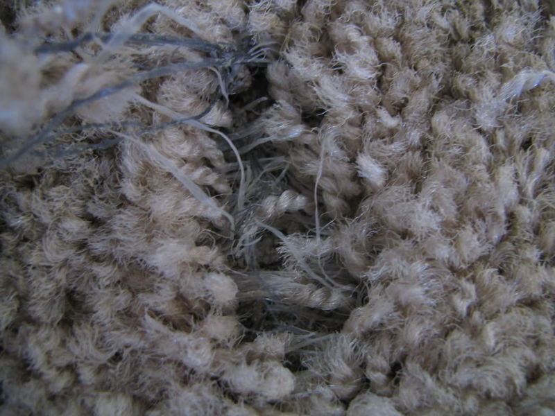

Notice the primary is split / cut and the secondary is still in place
Hope you enjoy

Steve, pardon my ignorance, but the slice in the last pic shows to be a very straight cut going across the carpet.
Least that is what it appears to be to me.
Could it be from a razor blade/stanley knife type of slicing action :?:
I would have thought that a power stretcher would tear the carpet with tearing going towards the wall and be jagged :?:

Good eye to catch the secondary backing and understand which way it shows, and yes it is across the carpet but that is just the way it was stretched 4 different ways and this was a stretch wall so he damaged it as well.
It could have been from a bent tooth in the power stretcher as well but when you see the bigger picture in the room it appears he just did a sloppy job and tore the face. Easy enough to do, that is why we are told to 'slam' the head into the carpet and penetrate the primary and secondary. This was not a knife cut but was trauma from force, the pattern points to the power stretcher.
Hope that helps explain some of it.

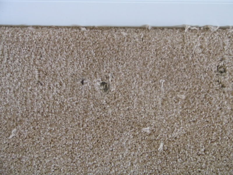

It looks more like knee kicker marks. I've seen some installers use the kicker on these base grade carpets. They call it the going home stretch.
Stevea
Feb 3, 2007
436
If you look closely at the second photo, you can see the outline of the power stretcher head. Knee kickers can certainly cause problems as well, have it happen somewhat regularly in classes by ones who take the challenge and think they can move a carpet with a knee kicker the same as one could with a power stretcher but a power stretcher can really make an interesting mark, just like the ones here.
