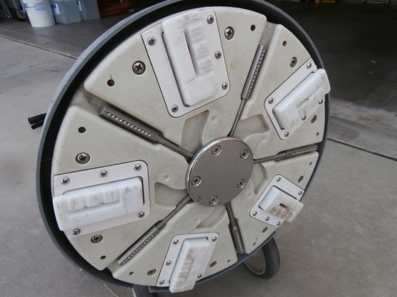

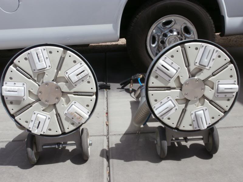

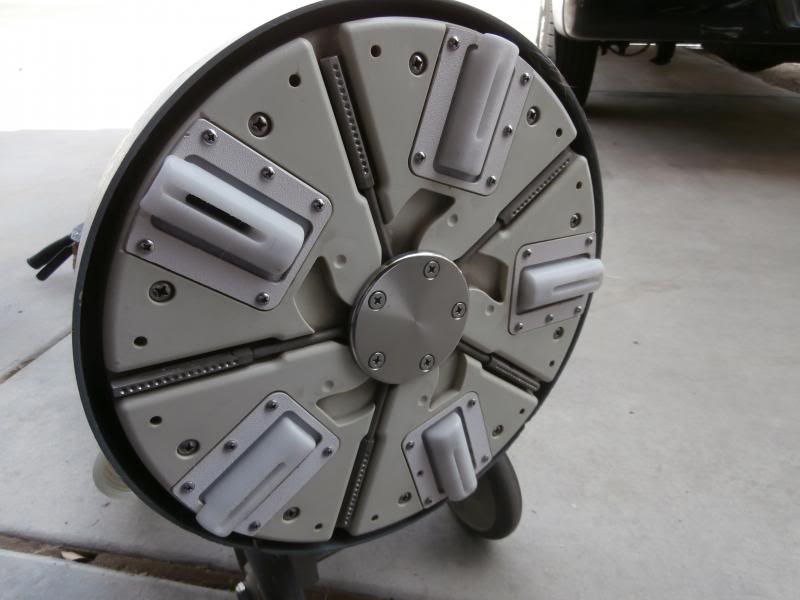

I have been testing the square polymer vacuum shoes on my Hoss since just after MF in February......what a difference that it made on this machine.......and just like a glide on a wand.....they brought this machine to another level of clean...I did a number of side by side comparisons with the metal and the polymer... it was already smooth with a great recovery with the metal ones...the square polymer made it feel like it was just hovering over the carpet....but still standing the pile up and giving me better recovery and dry times...
Not to long ago I installed the round polymer vacuum shoes on my other Hoss...Got a great clean...but my dry times were not as good...If you are running a real high flow truck mount...then you will need the square ones...If you are going to run the Hoss with a portable........then you will need the round ones.....
IMO...you are not going to find a better rotary out there.........from flow to recovery...this thing is made to cater to every applacation out there from portables to high performance truck mounts.....It will flush everything out of the carpets..hold the heat in the fibers and still give you the best dry times of any one of them out there.....Polymer vacuum shoes..was just the icing on the cake.....

Jim, thanks for the review, just curious:
  1. Were the end results significantly better with the square glide than the metal glides?
  2. How long, assuming 5 full days a week. Do the square glides last, before they flatten out?
Jim Martin
Arizona
Jim Martin
side by side the carpets were drier with the polymer square ones....in the time that I have used them I have put them on just about every carpet out there including some wool area rugs.......
I have had them on my Hoss since around the end of February....I use my Hoss...5 to 6 days a week...3 to 4 jobs a day...
aside from a few scratches from going over a tack strip...they are not showing any type of wear.....

Jim;
Looking at photo of all three extraction heads ;
It's pretty obvious that they shortened the actual length of each vac slot on the polymer versions.
It looks like at least a 33% decrease in slot length on the polymer designs.
Do you think that higher airspeed in the shorter slot,
accounted for the increased recovery ??
Larry

I do not know......

Jim;
Looking at the two TM extraction heads:
1. They look to have roughly the same surface area for contact with the carpet.
2. They both have leading slots
3. Slots are only about two-thirds the length on the polymer TM design.
Decreasing the slot length on an identical blower system,
should increase the lift generated at the carpet interface.
And consequently, the slot air velocity.
Same principle as Hydramaster did on the RX-20 HE.
Larry

If you are referring to the half slot...cone jet head....then I don't think we are comparing apples to apples.......but this is pretty standard across the board when it comes to comparing the Hoss with any rotary out there......
On the RX you have metal vacuum shoes that planted them self's down on the carpet and locked on...just like a UN-glided wand..loss of air flow..so then..RX came out with the half slot vacuum shoes.....we already had a full slot planted down onto the carpet...and now we have a half slot locked down...most people did not really like them and went back to there full slots because the dry times with the half slots were honorably bad...........Finally...someone came out with a glide for the RX ..( just like our wands )and it brought this rotary to a entire different level.....
Hoss has there metal vacuum shoes...but they are entirely different from any other.....out of the gate you are already getting better recovery and dry times because they are not thin like all the others..they are wide and rounded.. and they have a grove cut into them and allow the air to flow...so they are not locked down to the carpet...square polymer...same theory from what I see.....not quite as rounded and groves cut into the leading edge......the rounded polymer for portables is not grooved...but when I put them on my Hoss..it was like the machine was on a smooth sheet of ice.....it got away from me a few times because it moved so easy.....but with a high flow..my recovery was not as good....with a lower flow....like portables..it will work great...this could also explane why some people liked the half slots and found they worked better for them....(?)..
then add in the way the water is delivered.....all others are lifted and they spray...........the hoss uses flow bars and everything is low to the fibers and has a very fast flush and recovery..........

How much do you think the metal Hoss vacuum shoes make a difference In drying? The video claims a squeegee effect from one side of the shoe being deeper than the other side.
