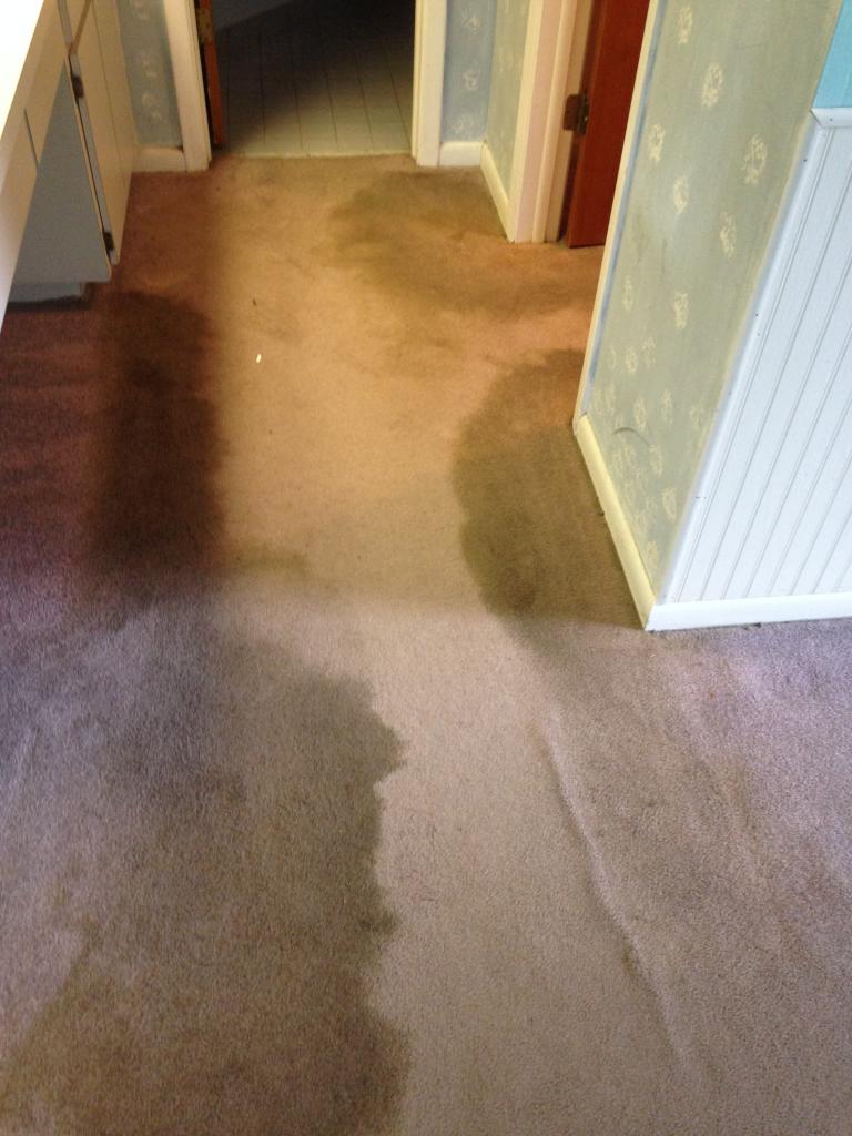

That sculpted carpet is the biggest pita ever.
You've asked to compare two tools that couldn't be more different than each other.
Zipper = Ultra fast, Mega flushing, Fast drying. I own 2, and couldn't operate my business without them.
Hoss 700 = Ultra Slow, Insane restorative cleaning ability, Smooths and Blends worn traffic lanes. I sold mine to Billy Lewis, It just didn't fit into my business model, as I don't do allot of trashed resi carpet, when I do, I use a combo of Insane flow (24) and a post padding with an Orbot or Trinity to bring the nap back to life and remove any remaining stains.
View attachment 4617View attachment 4618[/QUOTE
