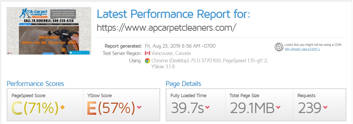

My SEO person is working away for me behind the scenes. Here is where we’re at so far.

Dump/get rid of that self hosted video on the homepage and upload it to Youtube then embed it. You could easily put that caption in the video itself instead.
I'd start here first. All that other stuff won't matter much if this sucks.
Don't pay much attention to the letter grade but rather the fully loaded time. Sometimes a better letter grade can slow down the load time.
the site is gtmetrix dot com to run the test.

If I do that will the video still auto play?
Yes but you have to add some parameters to the embed URL. New versions of Chrome block autoplay if the mute video parameter isn't called/activated in the embed code.
I'd still edit the video with some captions explaining what you're doing. Spend less time showing off your machine and more on you carefully setting up so Mrs. Piff knows you're not going to knock over her knickknacks. Even though she lets Fluffy use her house as a toilet.
Use the homepage to talk more about why they should choose you, add awards, certifications, other trust factors, and make the reviews more noticeable. The homepage needs to draw them in and win them right there, or make them want to learn more about whatever service(s) they want to hire you for.
Then put that video with added captions on the carpet cleaning page at the top.
Edit: I hate autoplay videos and so do most people, especially any video with sound. Give the user the control of what they want to view instead of forcing it.
