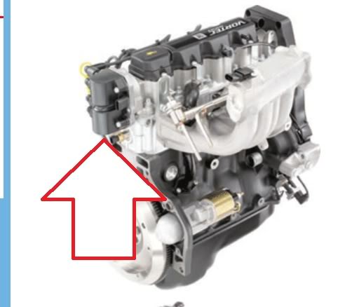

Good find Fred!
this is what the board is for.
if I were in that situation, I would do what Jim suggested, I would find a tech that can read the codes off the computer.

Jim is probably right about the heat being the coil killer....likely from the head rather than ambient
Can you put some type of insulating material between the coil and the head?

Does it need to be mounted to the engine?? Why not put a spacer between it and the head, half and inch would make a big difference if its sinking heat from the head.

no...doesn't have to be mounted to the engine....plug wire and harness length would limit how far you could move it but I doubt it would prevent a half in spacer
