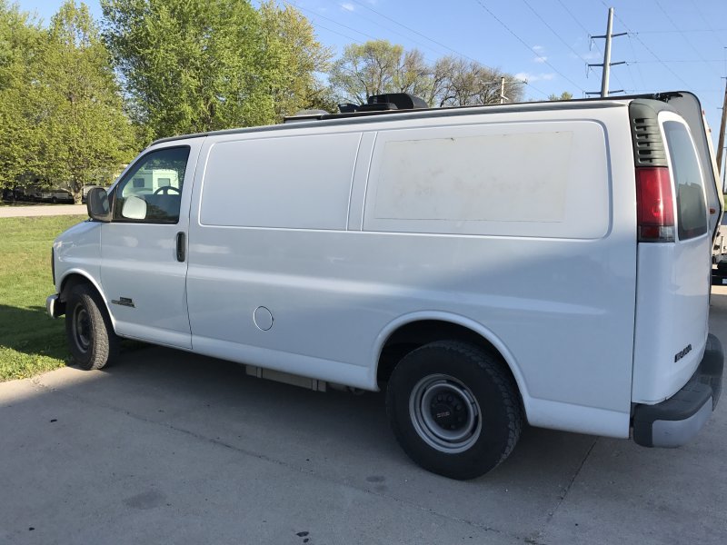

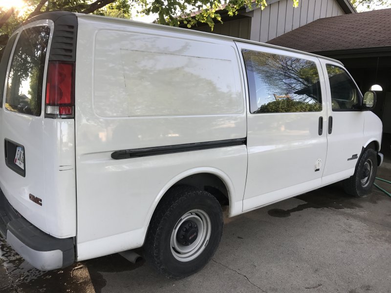

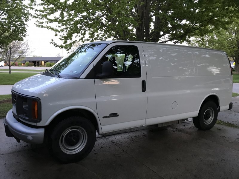

Previous owner didn't wash the truck or remove his magnets before showing it off to me. It was remarkably filthy.
You can see another outline of one of the fabulous magnets that were on there in this picture. Up front in the lower wheel well I had to replace a plastic trim piece. The body is very true and straight and the wrap should make it look great! Probably wheel covers or something cheap for now on the wheels...

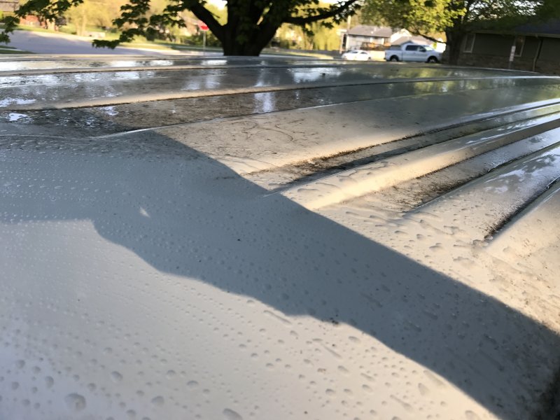

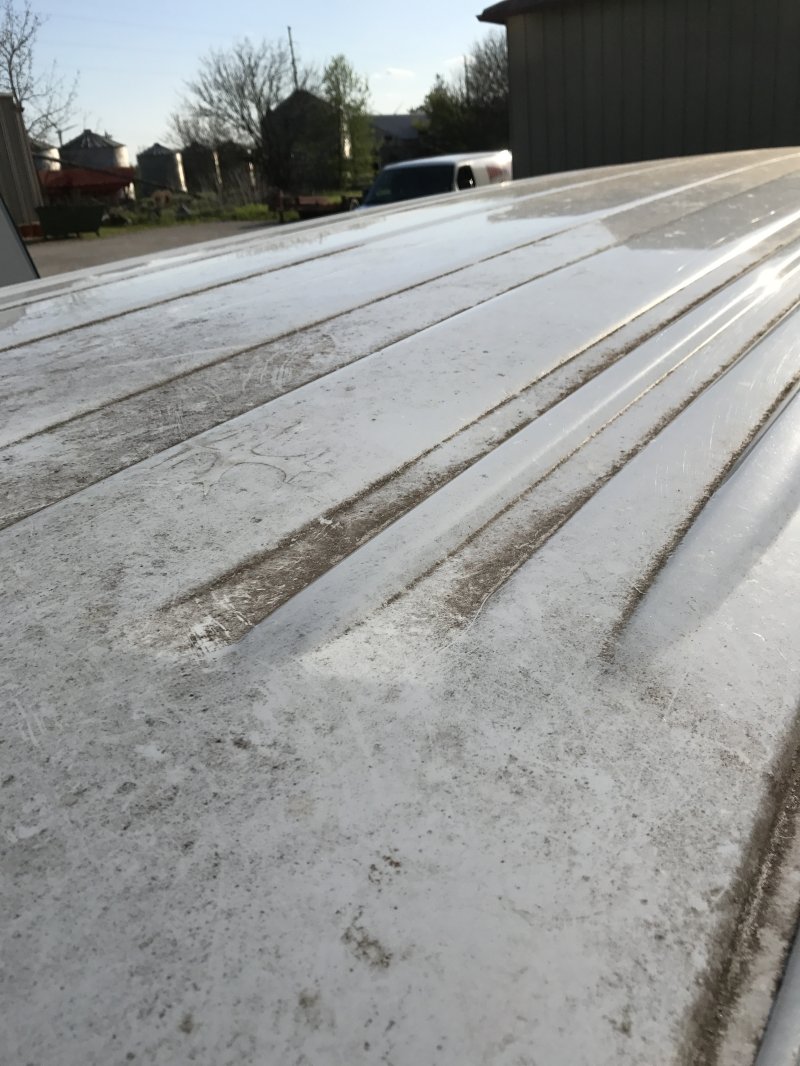

I think the roof is going to be great when I'm done with it!
This was after rubbing on it for probably an hour and a half. The inside will happen in the future sometime.

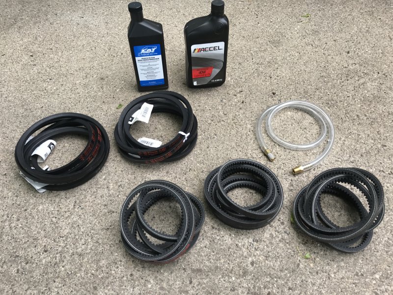

The belts and fluids came from Butler today. I'll have to install another day.

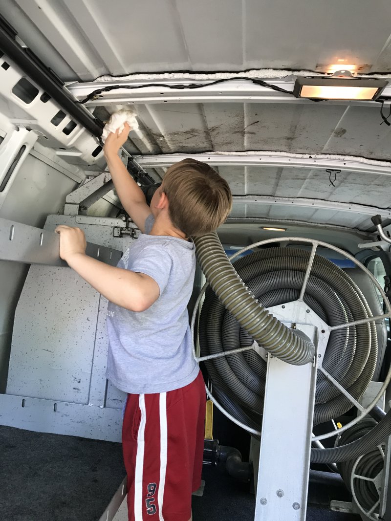

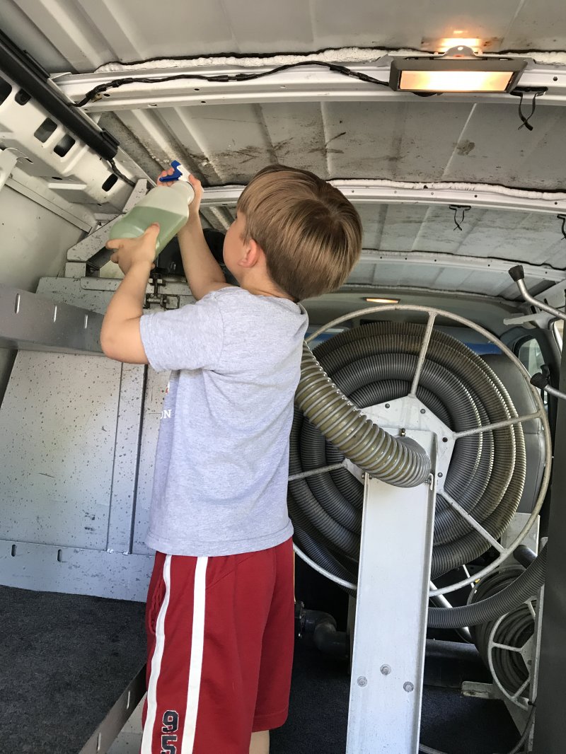

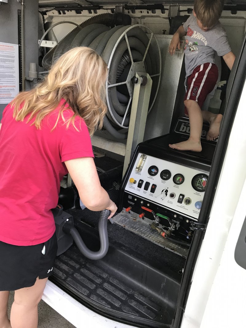

We scrubbed and vacuumed for about 2 hours. The inside is almost immaculate now.

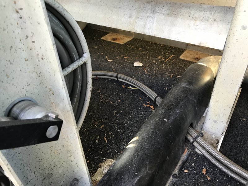

The chem hose is caked solid from lack of use...it was empty...except for hardened pieces of something in the bottom. The solution line is jumping all over the place. I'm replacing the hose and going to try to get the juices flowing.
Everything is right in my face when I lift the lid and Saiger is on speed dial!
This is going to be great once the kinks get ironed out. Turns out the dirty old Butler is super clean!

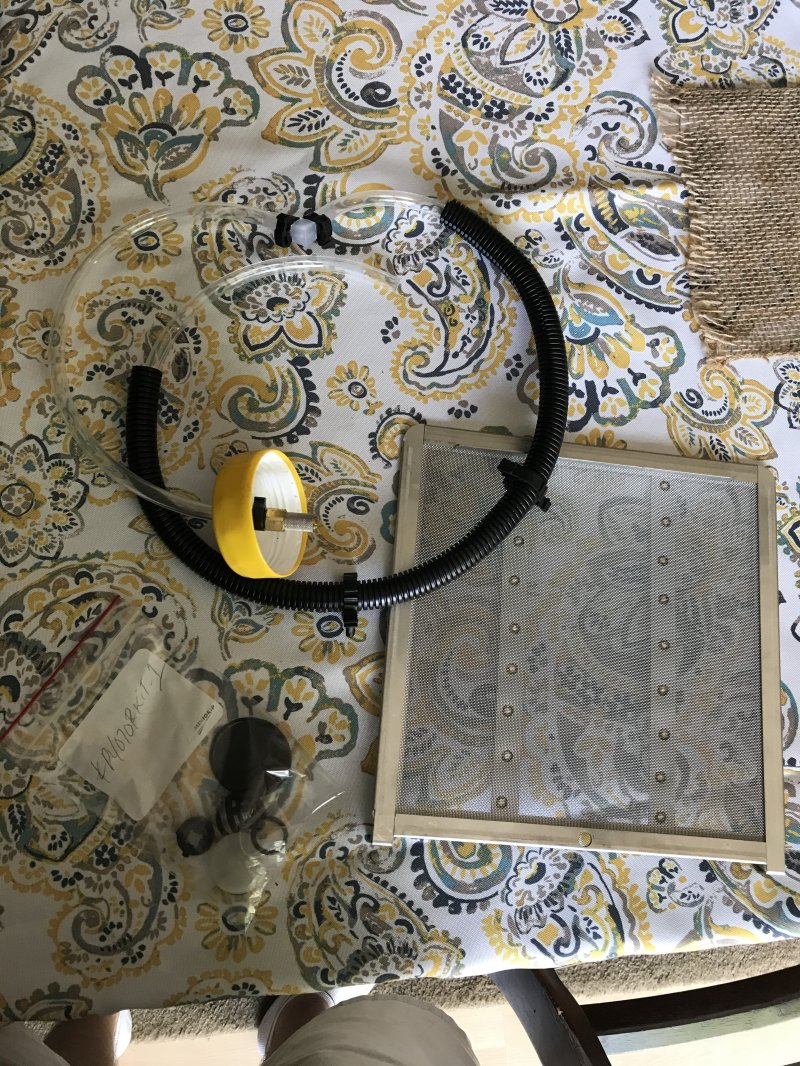

I got a rebuild kit for the chem pump, a new chem hose, and a new stainless blower protection screen.
Pricing on odds an ends through Butler has been very reasonable. I sort of expected to be hit by some kind of Butler tax but that hasn't been the case.
