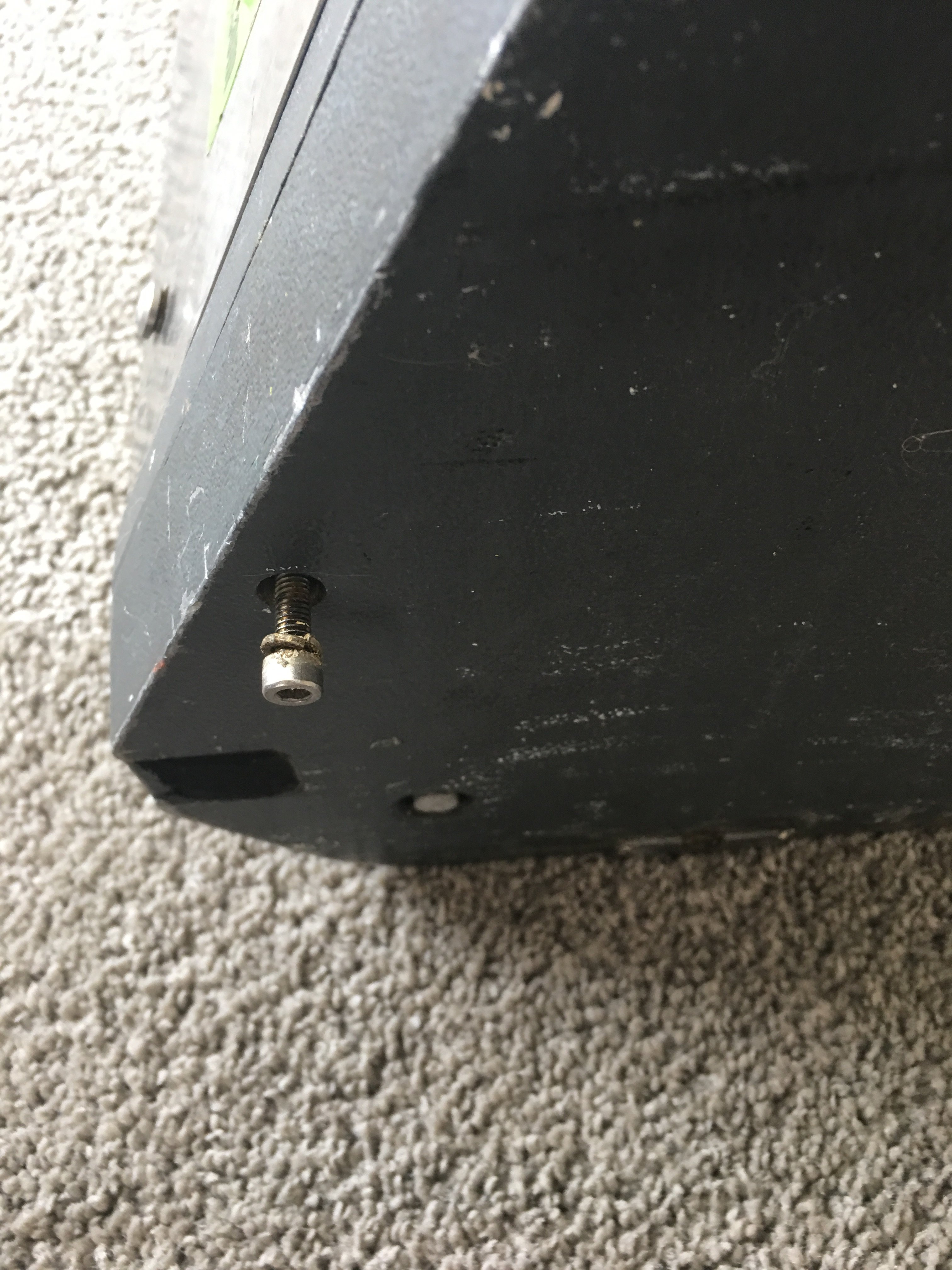

Mine started making a lot noise. Kind of a laboring and squeaking. I loosened the screws that go into the center brace rod that goes between the brushes. Noise is gone. Don't know what would cause it to become to tight. I had never touched them before.

went to grease the gears on the Brush Pro 20 and cant get three of the screws out. never put them back on that tight. Tried liquid wrench to no avail. Any suggestions?
Same problem here. You may need to send it in.

You can use a hack saw or grinding disk to cut a slot for a screw driver in the screw head. Sometimes pliers work.
You should be able to get hex head screws at local hardware store to replace them. Worse comes to worse hit them with a chizel and use pliers to get get the screw out.
Or send it in.
But get get hex cap screws to replace the Phillips.

No room to swing a hammer and the sides can crack. Granted I wailed on mine but I did crack it.
Easier to pop the heads off the screws. The shaft will screw out easily unless it's been in there a long time and is corroded.
Using the right screwdriver helps too. Use a #1 Phillips or smaller.

If the screws are steel in an aluminum frame, they have corroded.
Replace them with stainless. Larry is exactly right with the impact driver, it takes a momentary shock to break the corrosion.

yep, impact screwdriver did the job no problem. Screws had corroded a little. I don't use the 20 inch much.
