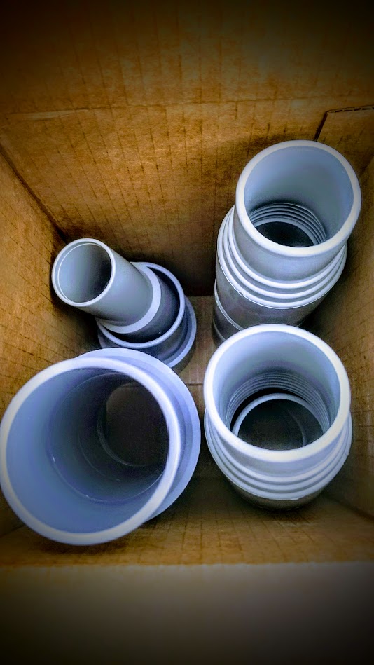

Never ever used a cuff myself on a hose. If they come with cuffs I just remove them.
And always used stainless 2 inch thinwall tubing for joiners.
Zero leaks.

DO NOT GLUE THE CUFFS ONTO THE HOSE. If you do, that cuff is useless if you get a split etc... use Teflon pipe tape, wrap the hose about 3-4 times, twist on the cuff.... and yes, SS connectors are the cats back end.... you lose the ability to have the hose swivel, BUT YOU ALSO LOSE SUCTION AT THAT JOINT.....this is exactly why I suggested doing just this a few months ago..... EVERY SPOT THAT HAS A CONNECTION, WILL LEAK AIR IF SOMETHING IS NOT DONE ABOUT IT..... take the time to ‘fix the leaks’, and a guy will be amazed at the results.....
VIVA LA SCREAMING WAND!!!!!
Reactions: vibra-vacster
not "glue", but 100% silicone works great
if/when hose tears/split happens and cut/recuff is needed, you don't "unscrew" the cuff, you grab a rib of hose with visegrips and pull .
It tears/pulls right out in a long curly rib string

So use electrical like Teflon tape?
thats a first....
yep...that is all I have ever used since day one........tighter fit and last much longer.......
make sure you put it on the same direction that the cuff screws on so it tightens the tape...not backwards so it loosens it...

and when you are wrapping it..... don't forget..in the world of vacuum hoses and cuffs.....righty tighty... lefty lucy...goes completely out the window....
