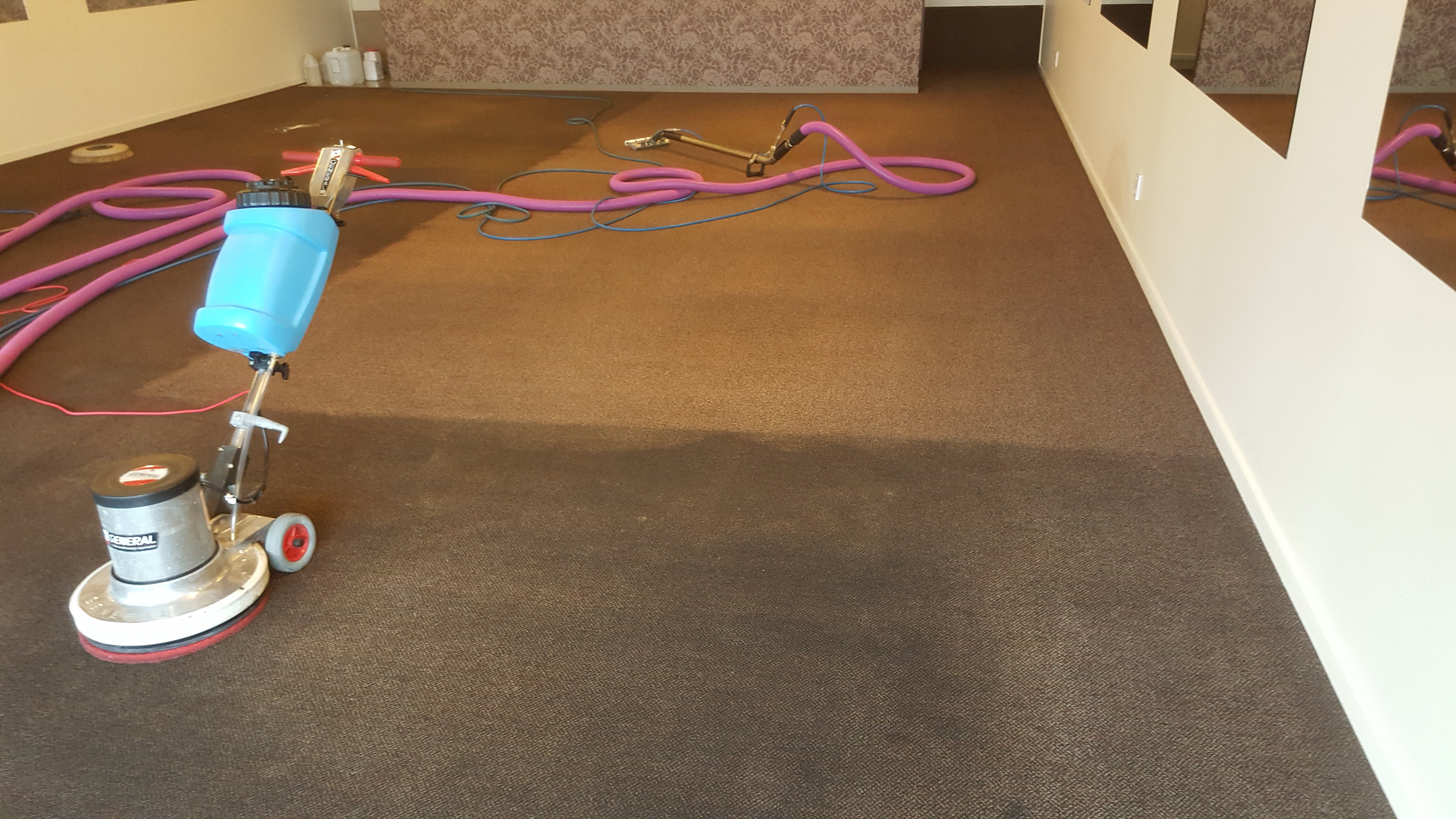

Serious question- would putting down some prespray with HF, then using a 175 with brush and shower feed not cut through it better?
24,146
I did all of the Cal-Fire buildings with the Zipper. Took me 23 hours total. Everything was dry-passed.
Jun 20, 2016
6,564
Jeff T
Derek said the same thing, yes it would but I dont have a shower feed tank and wont be buying one for just this job which I'll probably lose soon due to my constant price hikes..
Reason I ask, I’ve got a job similar. The tracks from the kitchen into the carpet are as black as night, and if I tap my toe on it, it sounds like hardwood. Last time I did it, i tried my CRB, and it did NOTHING to break it up. In desperation, I brought out my little Oreck, threw the tile brush on it, and it started to break it up. It was so aggressive, it damaged the carpet.
I’ve got an old 17” variable speed Clarke. I ordered a brush head for it, and a tank. I’m waiting for another grease pig pit to try it out on.
