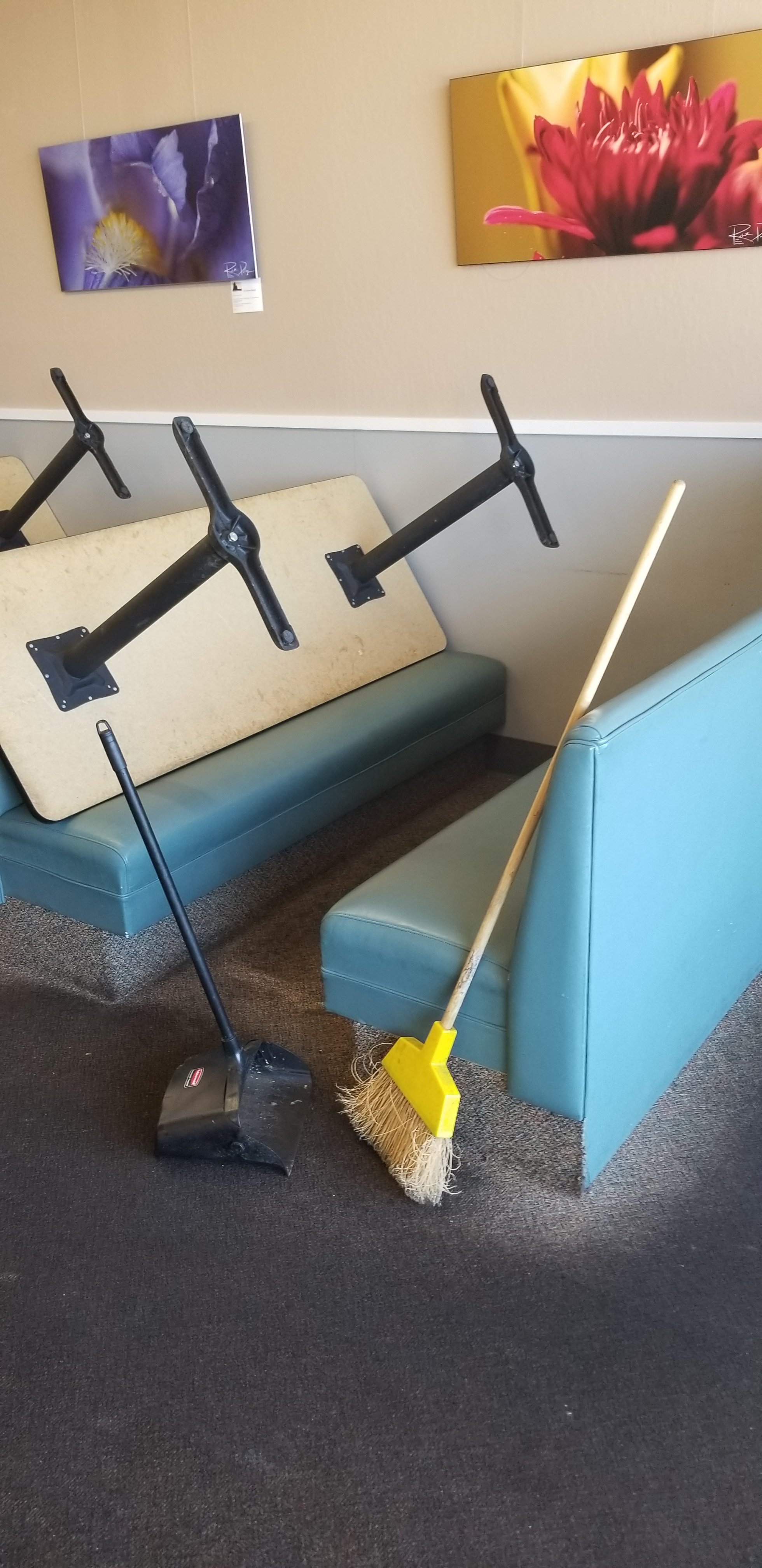

Chevy's carpet was deep fryer oil (from loose tortilla chips) mixed with "other" kitchen walk-off mixed with customer tracked in soil over a 5-6 week period. Took me many cleanings to find a repeatable routine. Staff was responsible for all debris and helped me quickly stack chairs on tables. Hose down every sq/ft and huge amounts in the traffic lanes. Got that shit down as soon as the last chair was moved. Always hosed the areas I'd rinse first. MINIMUM dwell 20 min. Not going to get into my pre-spray here, it was 3 things mixed. RX20 with propane fired booster, 230 out the machine, no drop in temp. If today I was sentenced to only clean restaurant carpet I would still swing a rotary with some boosted heat if my machine couldn't keep up. I fu.... around long enough with a big wand and lower temps to figure out heat was essential in a greasy load. Speaking of load, cleaning them is like a load in the pants. Wait to get paid, no glory, no job satisfaction, no loyalty.
