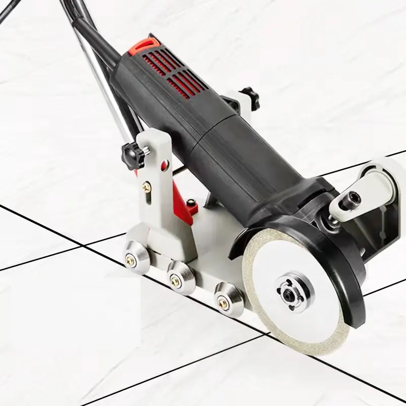

Thoughts on this tool?

Why not?
I've tried everything else on the planet.
Host crb's, 10" and 20" Austrian crb's, 175's with grout brush, mytee OPM with grout brush, bonnets with scrub strips and manual brush's on a pole.
I've always imagined a tool like this might come in handy.

It would probably be good in a beefier version....didn't makita on a stick guy's contraption do this (could be another one I'm thinking about)
edit: I may be thinking these and similar

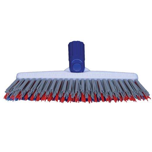

George, a chiseled edge pole brush will be faster and more effective.
Are you talking about one of these type of brushes? If so, I agree that they are a "must have". Especially for reaching under toe-kicks and edging.
Do you scrub all the grout lines exclusively with a pole brush?

I would definitely be willing to try the groovy grout. Especially, if it's high rpm. Besides, it's compact, light weight and will fit perfectly with the rest of my grout tools hanging in the rafters of the van.
