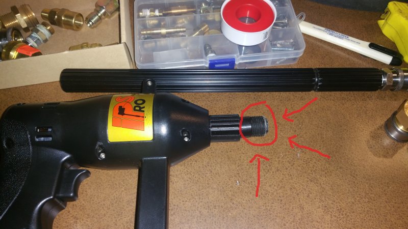

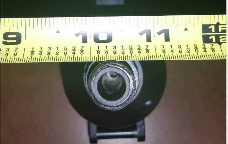

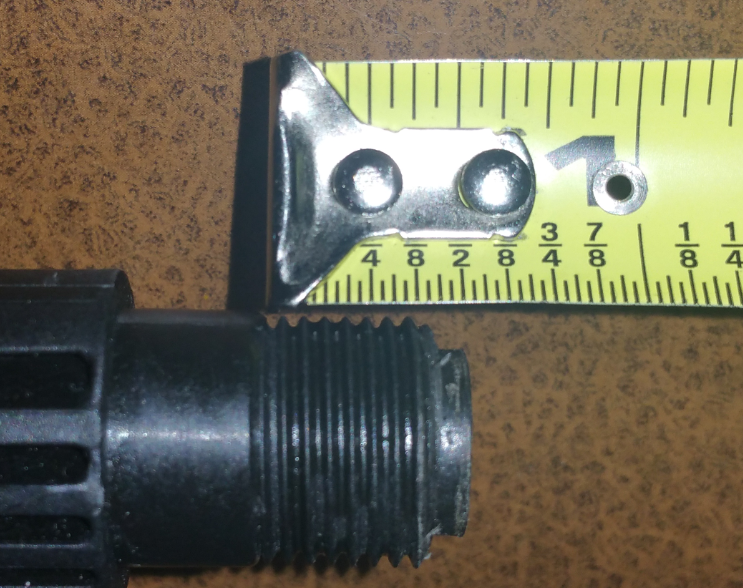

It measures 5/8".......But NOT NPT........so what is it?
5/8" "Hose thread".....?????

Looks very close to 3/8 BSPP (British Standard Parallel Pipe). Your pic looks like parallel (non-tapered) threads, same as BSPP. 3/8 BSPP has a major diameter of 0.656 and 19 threads per inch. BSPP seals at the end, not by thread interference. Looks like your fitting seals at the end.
You measured 5/8" (0.625) - could it have been 1/32" fatter? the BSPP thread is 21/32" (0.656).
If you like to tinker then buy a thread pitch gauge - really helps to identify mystery threads.
https://www.amazon.com/Grip-Thread-Pitch-Gauge-SAE/dp/B004ROIU2A
Note that 3/8 NPT is approximately the same diameter but is tapered and has a pitch of 18 instead of 19. A 3/8 NPT fitting would probably start like it was going to fit, but would balk after a thread or two due to the different pitch, and would bugger up the plastic threads...
