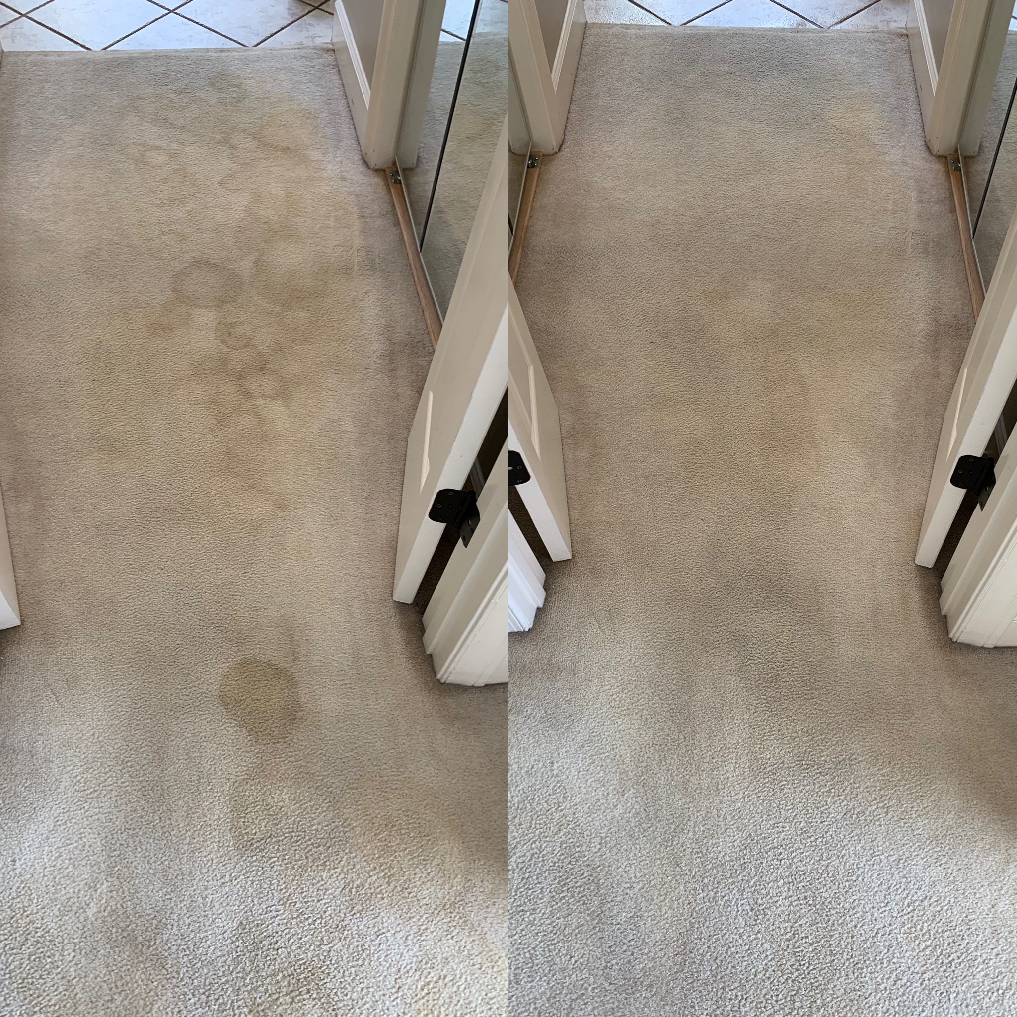

It’s really difficult to get away from using a peroxide as a surface treatment for pet urine(not guaranteed). It’s cost effective, very potent on the salts and staining. The pic on the left is the smelly dry state and the pic on the right is just 15mins after treatment(no extraction. 90% of the stains and 100% of the odor is gone before extraction(to pull liquified urine). Every carpet and urine contamination is different, but of all the product types I have access to, peroxide wins most of the time when it comes to a top down treatment.

I get good results with acidic urine neutralizers. I only use the peroxide based products like Osr or Pet Zone on the worst cases. The peroxide can lighten the carpet too much sometimes. It's usually my last resort.
14,632
Peroxide is my go to also. The only time I like to use an acid treatment is when upholstery and wool carpets are effected. Every other time, peroxide first, clean second, and peroxide last
