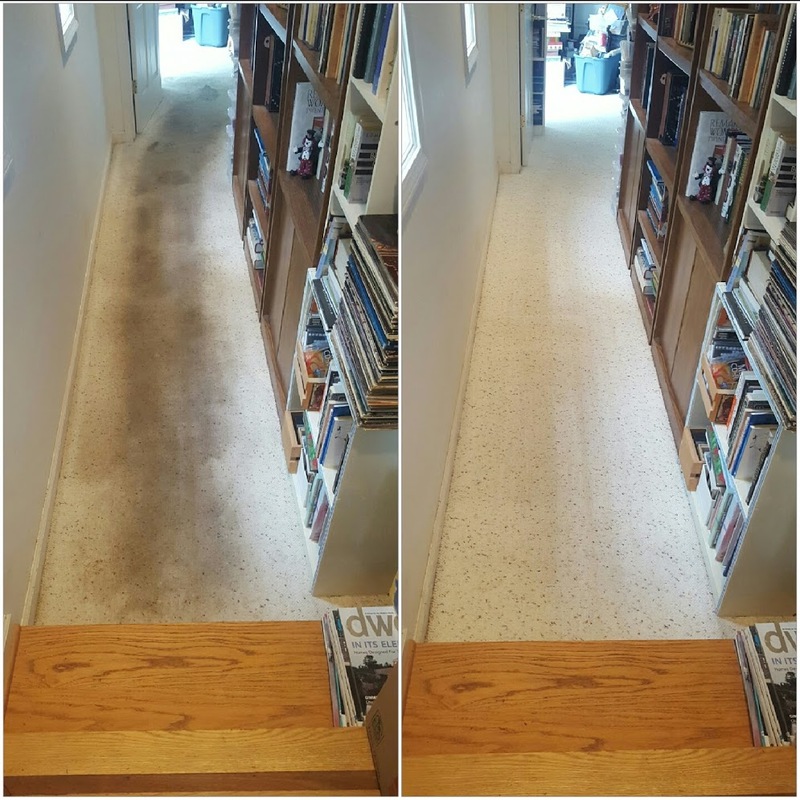

Took everything I had to get this one clean.
112,316
Eight months old, never cleaned.
nnPokTPFUkpIlIdNjG2DMw-xH0VhIjJh2U8_NeHIpip3Fi57cI47npEB6LkBfdEMiPQUENOnxZDfnkROdg=w1769-h995-no.jpg
I used Chemspec Enzall boosted with BioSolv and Oxyclean.
Red pad under the 175 got it to this..
3SGSaVNl0S3IBVXRKJiSg7SQt2EeBBF9p4FaSUgLApLwa3yRJk-eJkdC0lNPprgdHZ-a5yUM0UWGbGBguw=w1769-h995-no.jpg
Zipped it and while I flushed gobs of brown filth out it was streaked something horrible.
Pn1sorEhf0GbWNQNG3i0cTHQ29Pxa5jmxp7WS2DzJD7CTPUOi0G5WDaYYYnGf4Yyv7O60QJjvgGiHzp2jw=w1769-h995-no.jpg
So I pre sprayed again and whipped out the Miracle Worker..
I then went over it again with the Zipper to trim out and get out some additional moisture.
Used the SS Invisible to detail the carpeted baseboards.
Post padded and blow dried..

Mikey, that literally took you 4 times longer to clean. How did you price that first job vs quarterly?
Bryan Thomson
Jan 6, 2016
123
Phoenix
Bryan Thomson
I'll I can say is "WOW" what a fantastic clean!
Glad to hear the Cemspec cocktail worked well with the proper agitation and extra extraction
