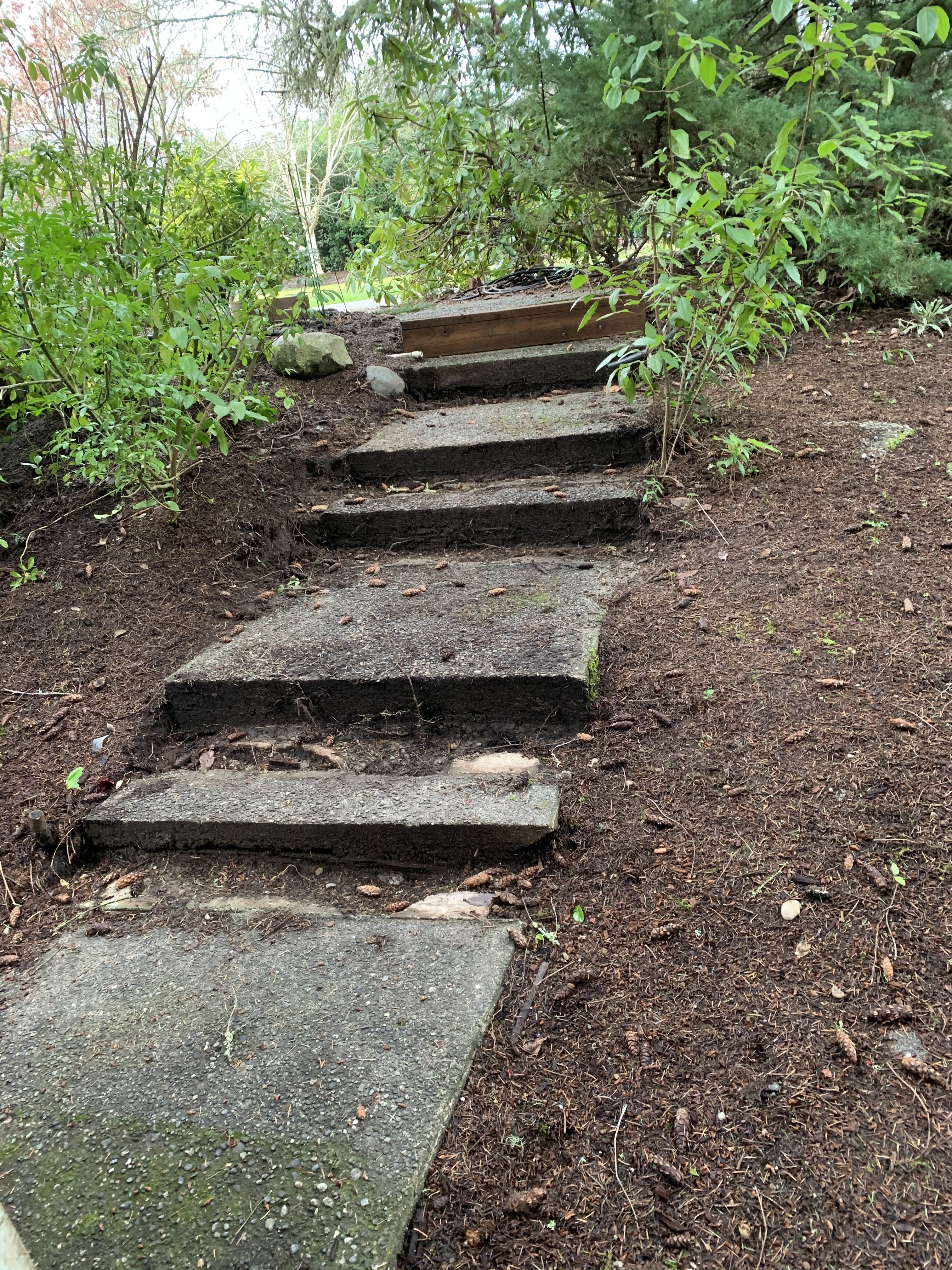

Brick is pretty easy to cut like grout. But it’s faster with the diamond blade on a grinder or skilsaw
Replacing RR ties used as the front of a sidewalk form for risers. They weren't 100% square so I have some areas I need straighten out in order to get PT wood flush. Worked great until RR rotted.

I’d use 4-1/2” grinder with diamond blade and also cup wheel. Are you counter sinking bolts through PT to concrete?
edit** I’d rent a concrete saw and just rip the fronts straight you have room to dig out sides. Would be clean and fast

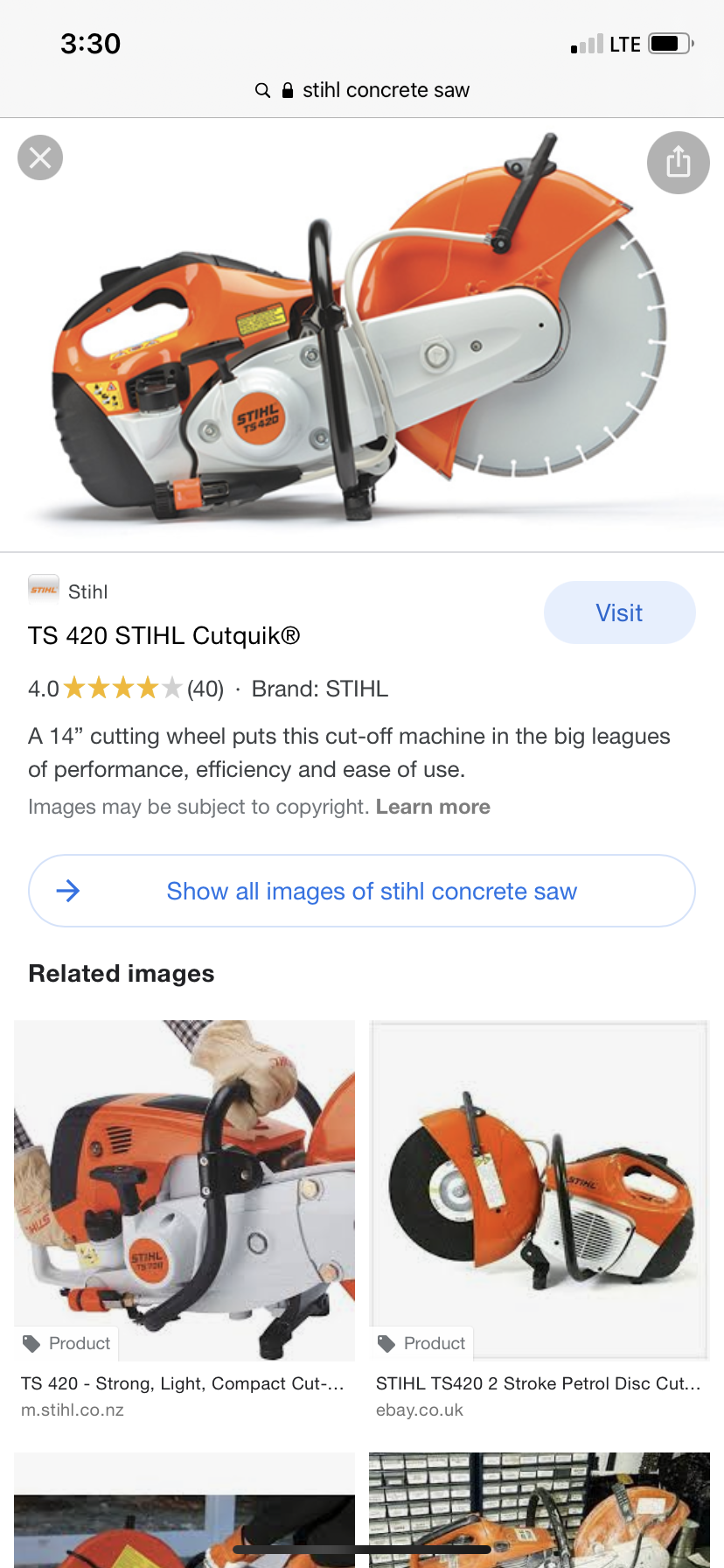

#This....
Make sure you hook up to H2O....
Fast, not messing around with under powered tools.
Yes Mike, I know how to use one, I spent the better 1/2 of 18 years in construction...7B65A3A8-23D2-4524-B057-CC26B35595A2.png
