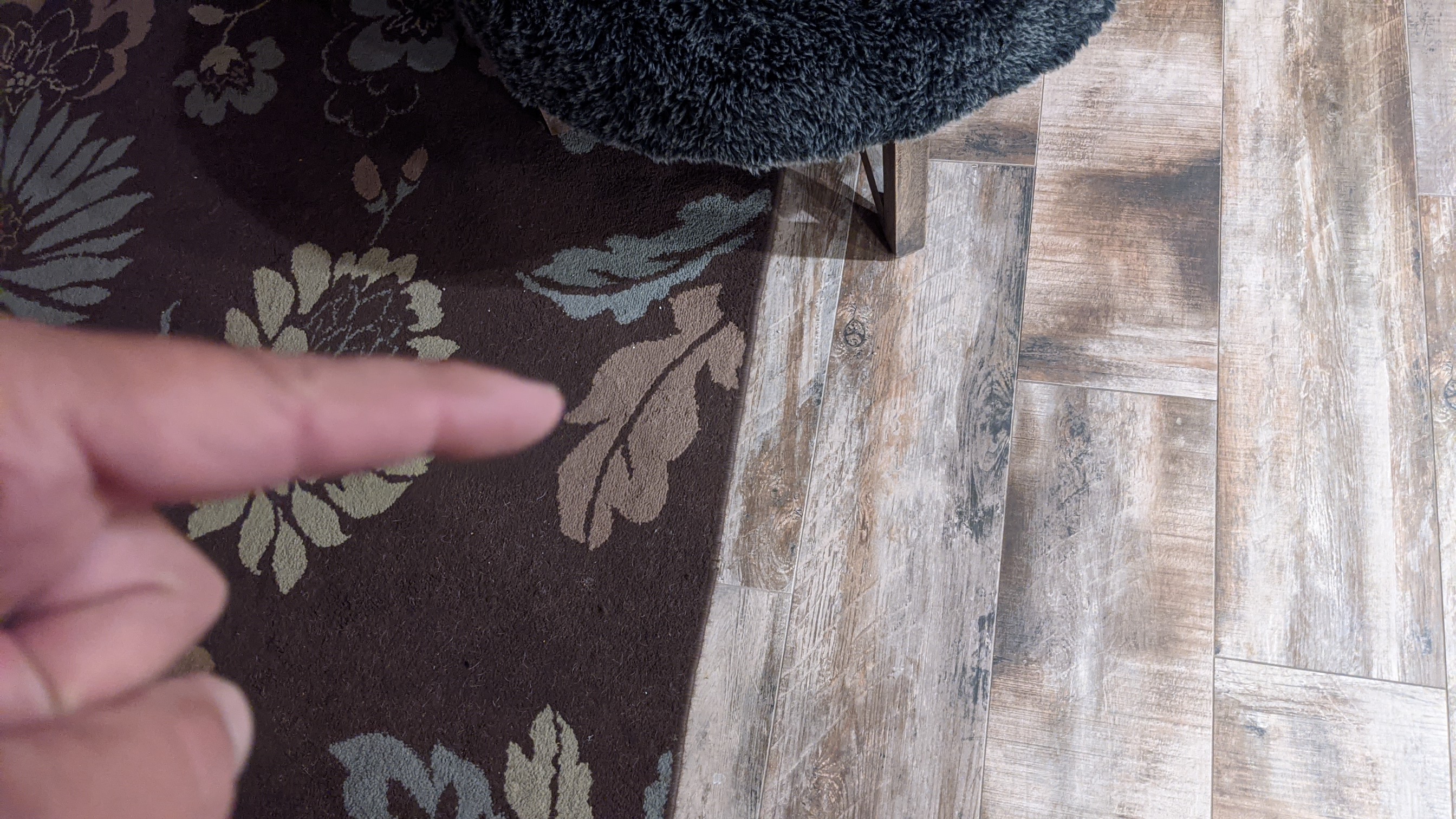

I poured an ounce on the leaf about a month ago undiluted with no blotting or extraction just let it dry....
The highest traffic lane in our home....

This is a good thing to do. When ever I get a new solution/chem. I spray/put some down at RTU strength in my heaviest traffic lane that is clean. Usually spray down in the shape of a letter so if it leaves a sticky dirt attracting residue it will appear after some time. Most of the VLM products do not resoil but a couple have. Important to put it down in a unique shape so you can tell if its resoiling vs just normal soiling
