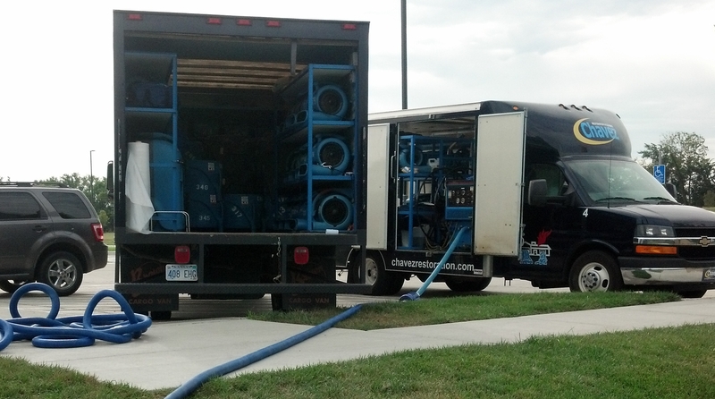

Cleaning Professional
I found this test useful in some situations we have encountered.
Right? You use a short hose? 50-feet on a job? :oldrolleyes:
we normally don't carry around sump or trash pumps on the truck
If they build homes with sunken living rooms why do you not have one on the truck. We always carry one and we don't have Brady Bunch living rooms. :winky:
But I do understand Chavez position as he uses a butler and he can't extract that volume of water.
We use the Butlers to clean carpet. We use the Prochem's to extract water and we don't fool with deep water unless its a business where we can get paid for the use of submersible or trash pump. bitch! :winky:
