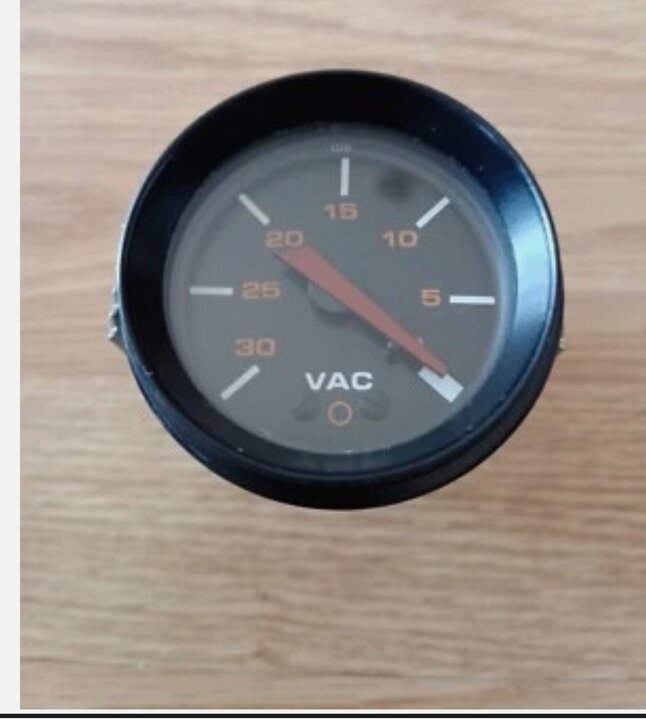

11,551
The vacuum gauge will look like this

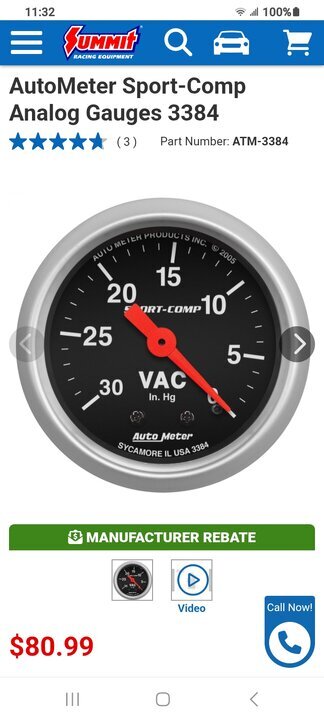

Dwain Ray
Jul 22, 2020
1,175
Yes sir. The mercury hg should be measured in increments of 5
Can you show us a pic of the gauges just to see exactly what you're looking at?
Vacuum guages don't necessarily just read in increments of 5. Most all that I have and or have had read in increments of 1 but all go down to 30.( yes i said down to, pressure goes up vacuum goes down)Some also have an additional center scale, KPa (kilopascal scale) which is generally only used by scientists in Laboratories and or countries on the metric system.
