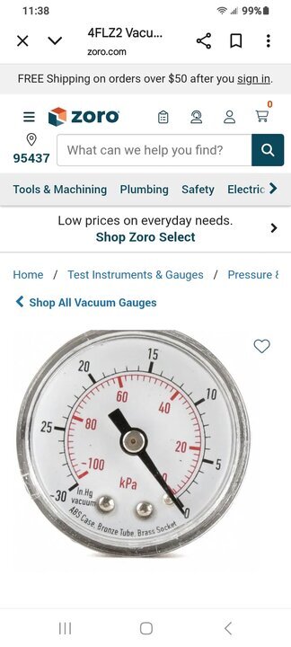

is your mercury hg set at 14-15 on the vacuum gauge? Not sure about this one. The only mercury I see is for Chemical tank. Am i missing something? And yes I am New. Please forgive me.

Yes sir. The mercury hg should be measured in increments of 5
Can you show us a pic of the gauges just to see exactly what you're looking at?

Vacuum is measured in eighter inches of mercury or inches of waterlift. Virtually all Vacuum guages read inches of mercury from 0- 30". 29.92" of mercury is considered perfect Vacuum at sea level. inches of water would be 0-407". 1 inch of mercury = 13.6 inches of water lift. Vacuum readings in inches of water are generally speaking used in electric Vacuum motors. And portable machines with electric vacuums you might see specifications stating 180" or 210" of water lift. But the guage on the machine will still read 0-30 inches of mercury. in short when mr Big Wood said set your mercury hg he was trying to say set your machines Vacuum relief to read between 14-15 on the 0-30 Vacuum guage. I hope you don't have mercury in your chem guage cus if you do you have some serious problems. Hopefully this clears things up for you
11,471
The vacuum gauge will look like this

Vacuum guages don't necessarily just read in increments of 5. Most all that I have and or have had read in increments of 1 but all go down to 30.( yes i said down to, pressure goes up vacuum goes down)Some also have an additional center scale, KPa (kilopascal scale) which is generally only used by scientists in Laboratories and or countries on the metric system.
