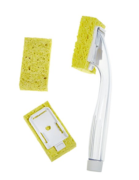

Put some fabric softener in this and Ziptie it to the vac stack with the sponge downwards, at the right level.

All you have to do is soak a sponge in liquid defoamer And shove it to the back of the defuser tube... that's the ticket , trust me .then get the 15 gallon waste APO

Would that have the same effect if we put a soaked sponge in the filter basket of our waste tank?
It should.......have yet to try it on my porty...but it makes sense in theory.
I was trying to think of some way to slowly introduce a defoaming agent directly into my waste tank if needed and was thinking of using a sponge, but then the sponge handle thingies made perfect sense.
I have knocked down porty tank foam with a quick shot of fabric softener before in a jam, I see no reason why it wouldn't work if it can be delivered slowly over time.
I was considering fabric softener because it is a thicker liquid, not because I am a hack of course.
