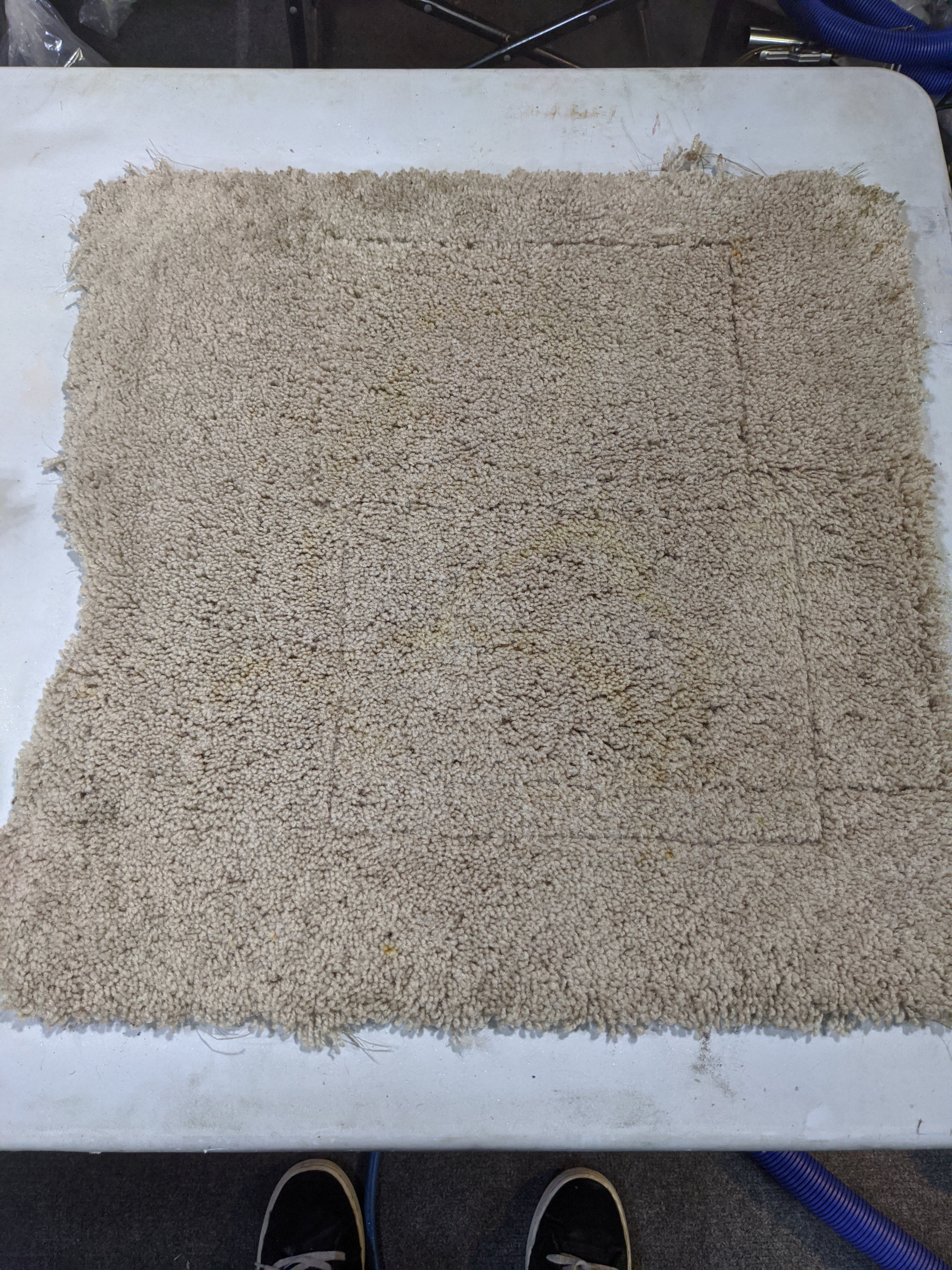

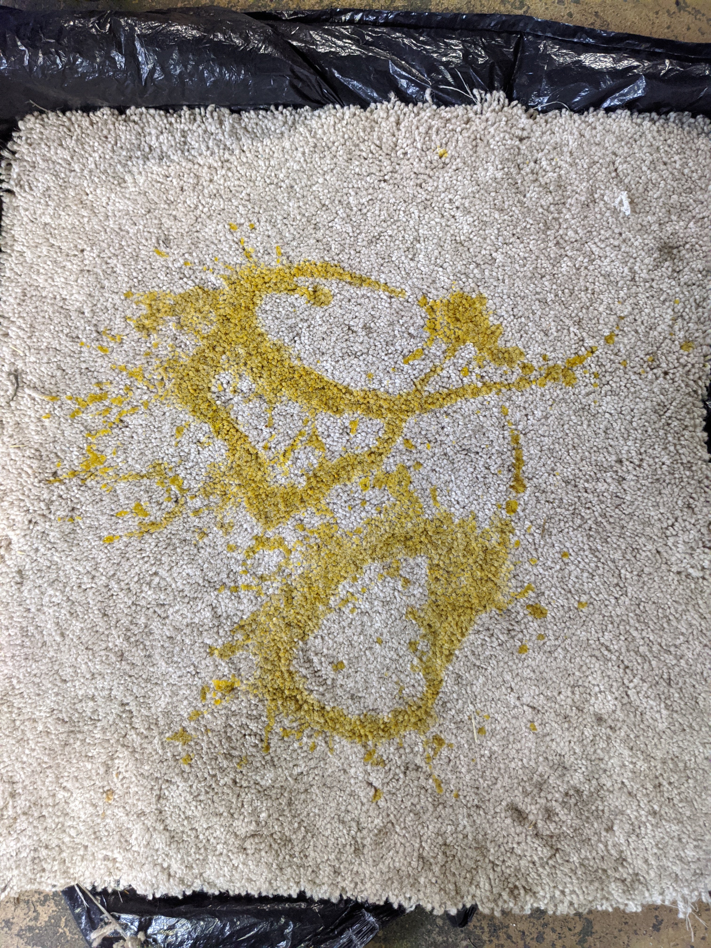

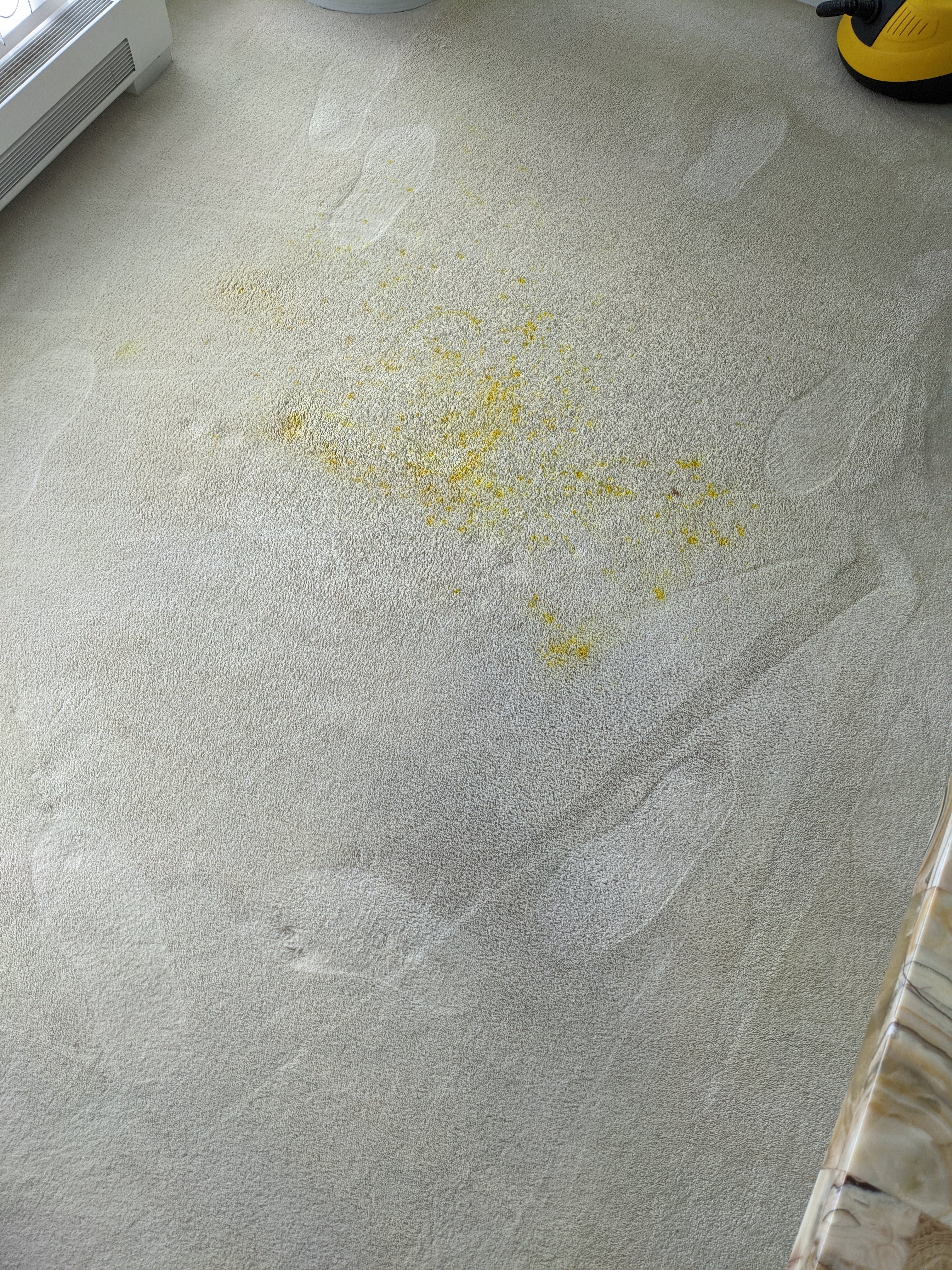

Here is a photo of a carpet sample that I stained today with tumeric and water. Will be practicing my stain removal techniques in preparation for the real thing next week. After rinsing, I will be using a peroxide/ammonia solution (vanish) along with a steamer. Any other suggestions that have achieved good results for you?

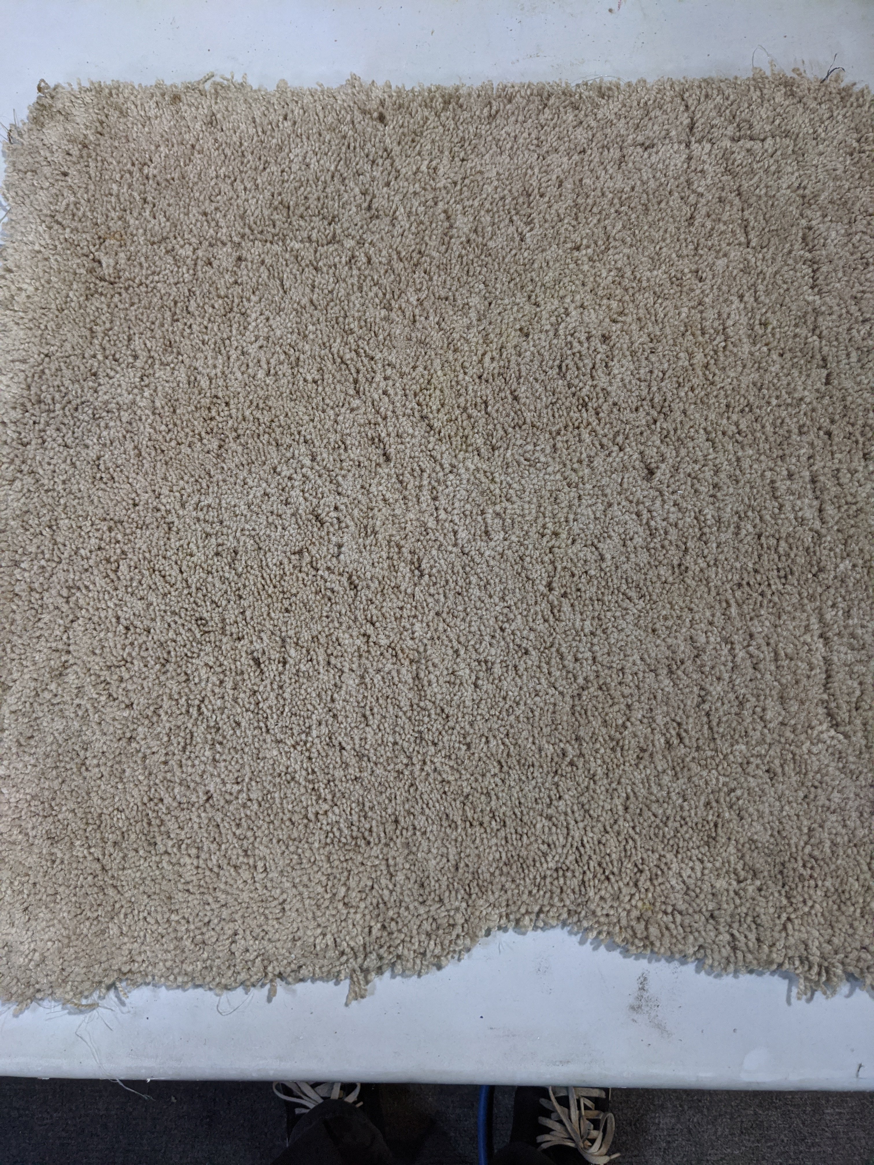

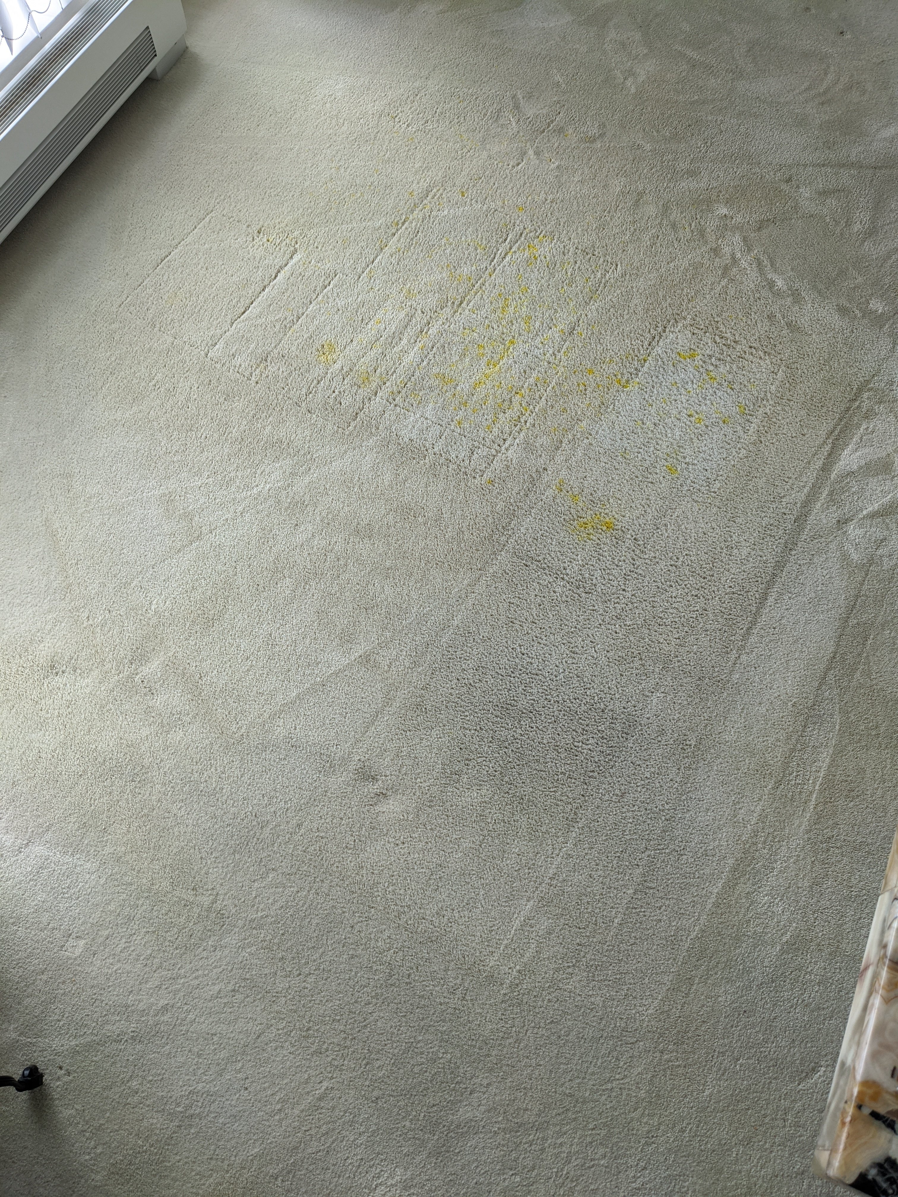

Here are the cleaned photos that I did today.

Here is the final result after treatment. The tumeric seems to be gone. I started with straight ammonia, which turned the tumeric from yellow to red, rinsed with a neutral cleaner to remove any loose product. Mixed my vanish 50/50 and sprayed heavily. Used the wallpaper attachment on my steamer for aprox 1 minute on each section. No rinsing. Left the peroxide on overnight to dry. Next week I get to see if it works on the customers carpet.

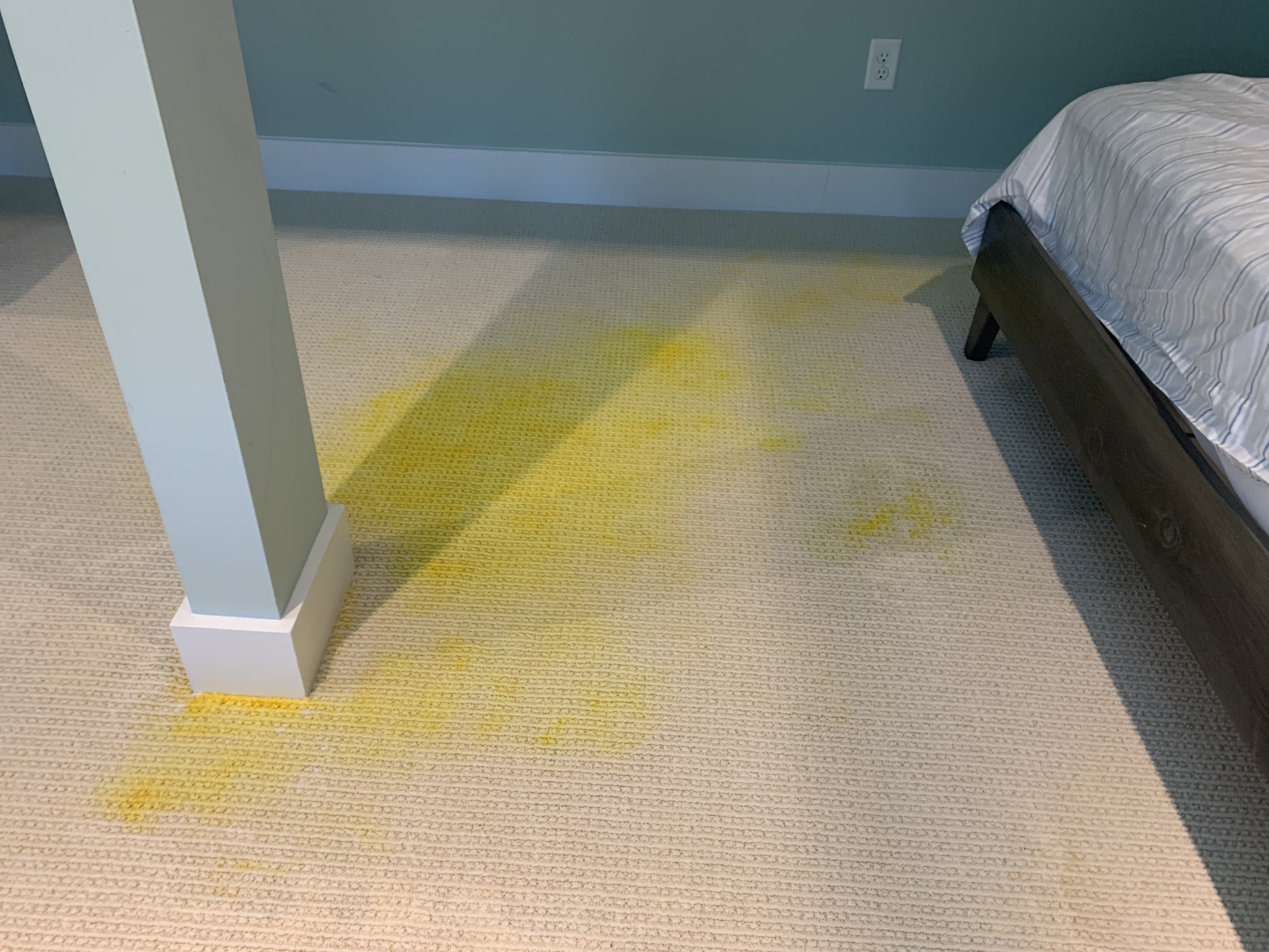

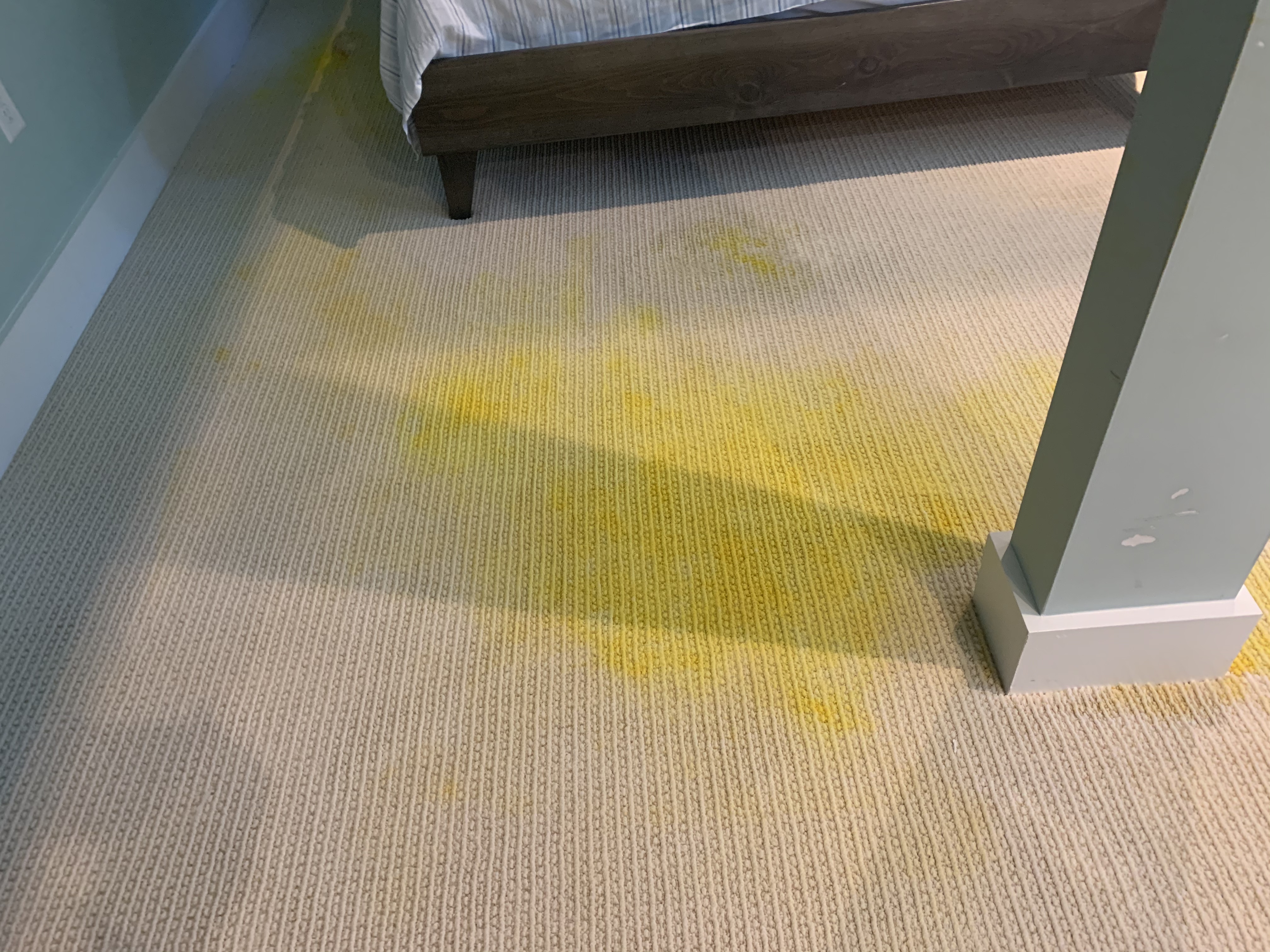

So, in real life, the stain removal was an abject failure. The drink he spilled was a mixture of hot chocolate, tumeric and ginger. He tried at least 3 different products before calling me. I started pulling color from the carpet without completely removing the stains. Faded it but it's still there.

I left enough peroxide to last probably 6-8 hours. It helped a bit but not enough to think a repeat treatment would work. He has enough carpet to effect a repair.

I doubt it. There were too many contaminates. Too many products were used before me. The one I did in the shop was just tumeric and water. Cleaned it the next day. The one in the condo sat for over a week. The owner used at 3 different cleaning agents before calling me. If he had left it alone, I may have had more success. I have removed curry stains in the past but it's always a mixed bag.
