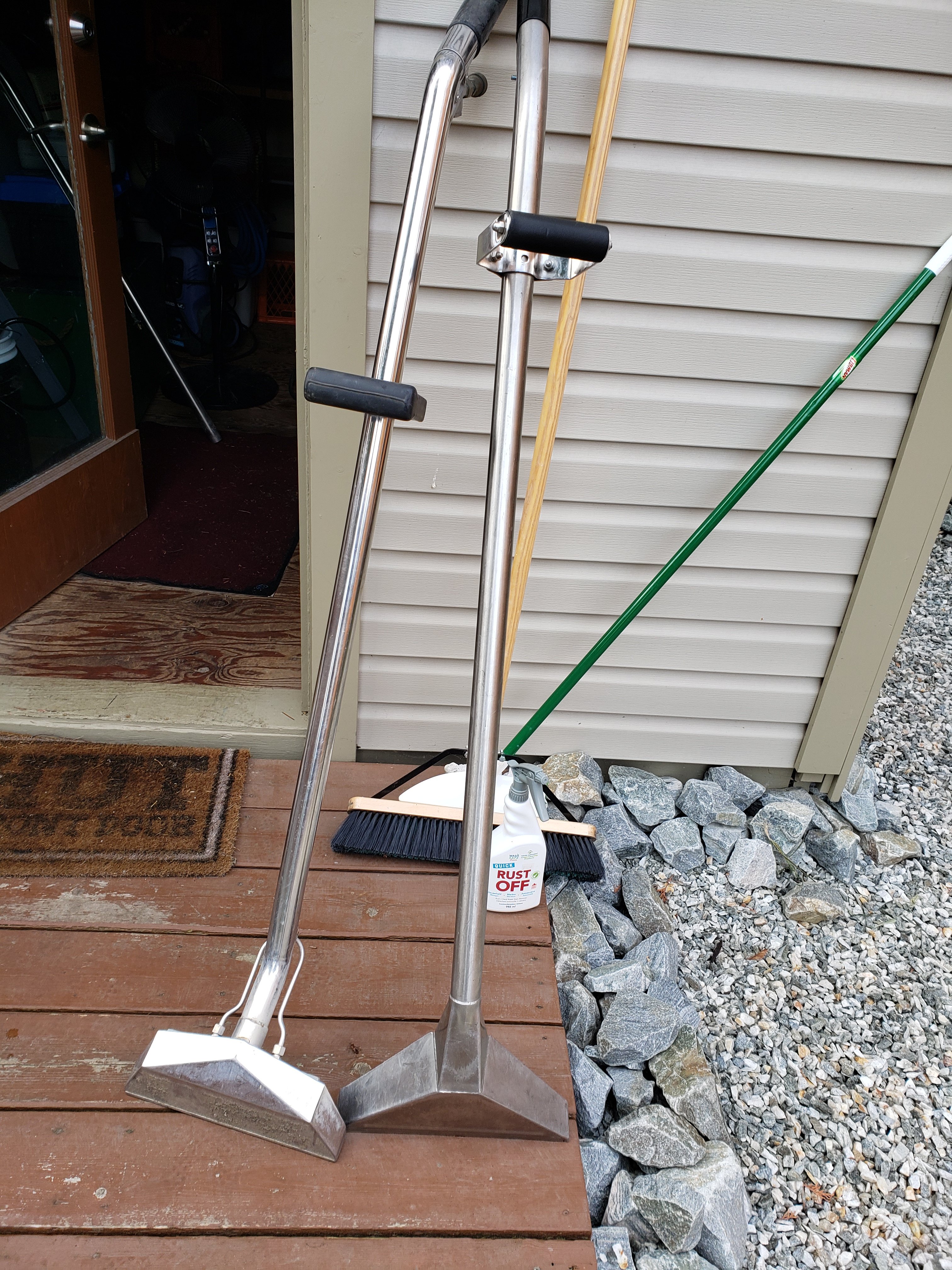

I have 2 wands and I'm retired.🪄
Reactions: Mike Pailliotet
Willy P
Oct 2, 2007
10,952
Willy P
Anyone know what the 4 jet 14 incher is? I was given it last week.
