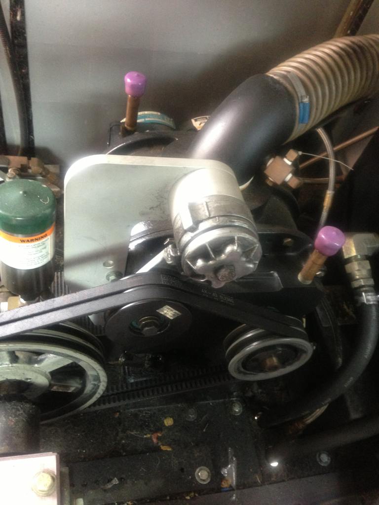

this is the 3rd blower in 7 years..
first one on this truck was a grease blower and went out after 2k hrs..it was warrantied (love that)
then the blower in our other truck went (bearings went on both) not warrantied but replaced with a dual splash
now today after 2500 hrs the blower froze on my truck mid job..i ran out and shut everything off and checked for broken belts or anything
that could have caused it..i was even hoping for the driveshaft being bad lol..
after calling armand for some advice we trouble shot it down to the blower..ugh!!
dealtimeman mink is searching for a replacement for me also but i will see what butler can do to help monday..
this thing only has a few thousand hrs on it..
guess i will be scrambling to get the judson dialed in easter sunday and crossing fingers that she runs like she is supposed to..
i love my butlers more than anything but man ether im running the dog crap out of them or i am just pulling the unlucky lottery ticket on the bad batch lol
fingers crossed that butler will help me out on this being such low hrs on it..we will see.

Yes I service them monthly. I'm a maint freak.
I run hot water through them and wd40 through the service port.
Oil change with synthetic every 400 hrs instead of 500 and we never let the sit more than a weekend without running them. The longest they have ever sat is 4 days.
Larry I sure will
Thanks
davegillfishing
2,229
st augustine fla
dave gill
Side tension?
When I take the belts off the blower I can get a tiny bit of play when I rock the pulley back and forth. Just a little click. Then when I spin it I get some grinding like a bearing or something.
The other 2 that went were grease fitting blowers. This is a dual splash.
It's crazy because its been running perfect for several years. Not a peep. Then all the sudden bam like something just popped.
I am the one that does all the maint on the trucks because I'm kind of a nut with all my vehicles and toys. I like it almost over maintained if that is even possible.
Are they rebuildable? Even worth rebuilding?

i run with windows open unless its raining..dog house lid open at all times..metal screen filter cleaned once a month and we have the filter bags located at the back door and they are changed
every single day..
this is the 3rd blower to go on 2 different trucks..
i always run on full speed..never in mid range..so its ether idling or running balls out..we run 2" hose from the filter box to the wand..we by pass the live elbow because of restriction..
these trucks are truly babied and handled with kid gloves other than they are work horses..
on the grease blowers i was told that there were some problems with them..they were covered under warranty also..
but i thought i would get many many years out of this dual splash..
i run synthetic oil in them..its the aeon oil not the tuthill..

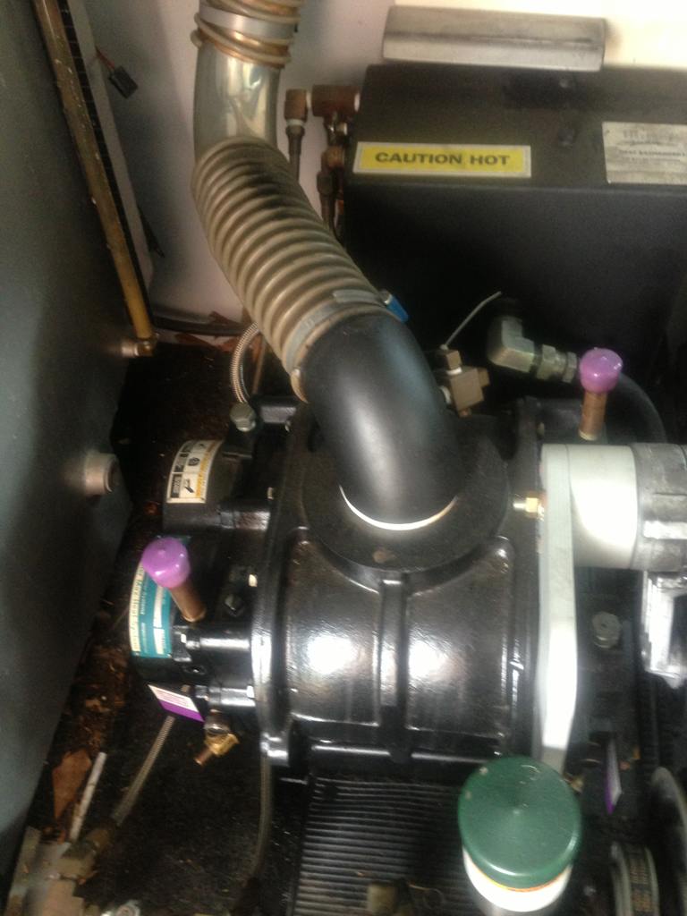

john i will post a pic of the blower..thanks!!
i am actually such a nut about checking the fluid levels DAILY that i will put anywhere from a 5 to a 50 dollar bill in the dog house a few times a month to spot check
the guys to be sure they are checking the levels before the fire up..if i dont get a call thanking me for the tip before they fire up the truck they are not eligible for their
next bonus..sounds harsh but i demand certain things get done and if they dont it comes with a consequence..

Hi Dave:
I've rebuilt a lot of blowers, and assembled quite a few Butlers @ MDPneumatics. One thing I've never figured out is why a dual splash is supposed to be better-because virtually everyone I ever worked on the problem was on the single “splash” end-never the grease end. Has anybody else noticed this? Give me a single splash blower any day.
Another thing I never figured out is why TM manufactures don’t demand a blower NOT made of all cast iron. The technology was out many years ago for a partially ceramic one, and nowadays plastics can stand the heat a blower produces.
Bottom-line Butler is not to blame-but if any TM manufacturer really cared they would demand blowers to be used in wet conditions. The blower manufactures love it that they don’t.
In looking at those picture-even though I’ve never had a Butler dual splash in front of me-it appears that the belt tensioned is no longer drilled/bolted into the casing like with the single splash ones. Is that correct? If that is so any 4007 MD (and possibly others it the casing bolt pattern is the same ) could be used.

i agree totally its not butlers fault at all in any way..its just a part in their beast..
it is a bracket that is bolted on the blower..it is one of the things i had to switch over when replacing the other blower in the past..
do you think this blower is worth rebuilding and keeping as a back up? or am i just better off not dealing with it?
thanks
Fort Worth , Texas
Spoke with my tuthill rep and she said the casing is different than that of a standard for ex 4007-21l2. So the bolts are in different places. Also butler has different milling to the end plates from a normal blower.
Which means if you don't want to have the tensioner milled or drilled for the holes on a different cased blower you have to buy it through butler.
