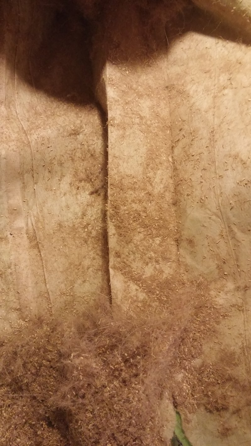

yes carpet looked like it does even when I hot water extract.
I did post vac the next morning.
here is the pic of the inside of the sweeper bag the next morning.
I'm using a proteam 1500xp at my house.
this pic is of the inside of the bag. The inside of the bag is usually white

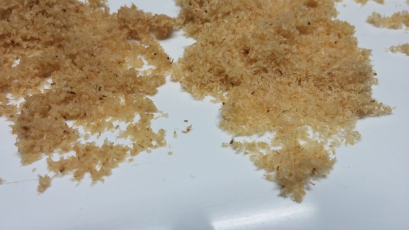

Here is a good pic for you guys.
side by side adsorb and brush pro, or is it brush pro and adsorb
