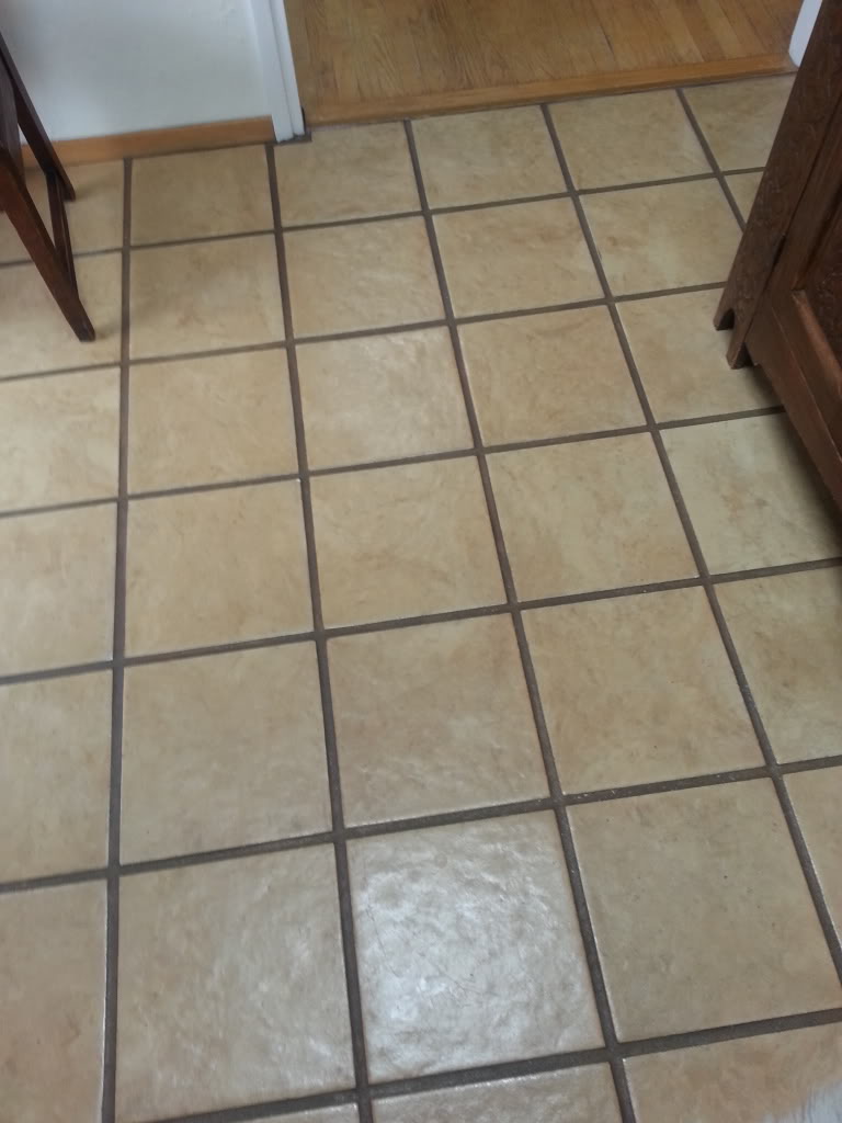

Area in best condition

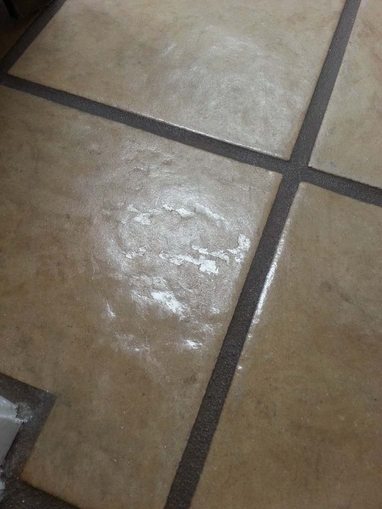

Close up of coating.

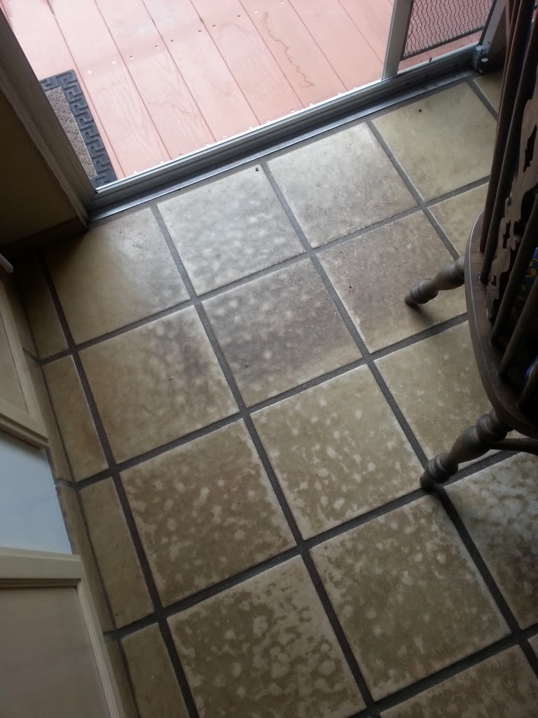

Area in kitchen where they recently stripped a few tiles themselves and gave up..

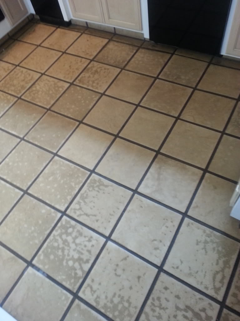

the worst of it all

Went back today to tes strip two tiles.
Tile is tough as nails, color is solid through and through
but lordy is this going to take a LONG time.
I need something stronger than Zep.
