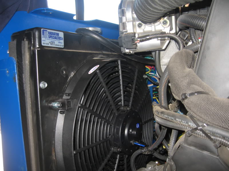

the only problem I had with mine in our heat was.....overheating because the fan was not pulling enough air.....upgraded the fan and never have had another problem.....if one can run in our hell heat..you should have no problems....

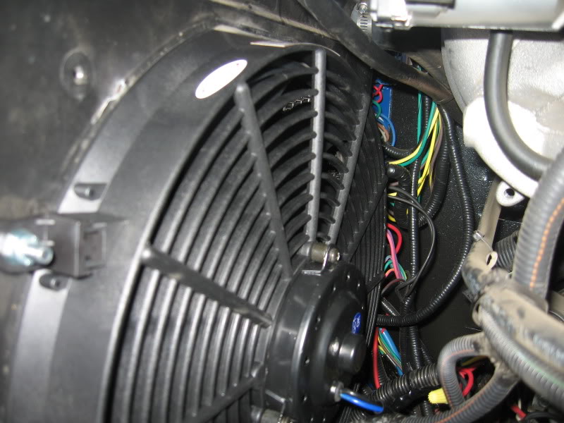

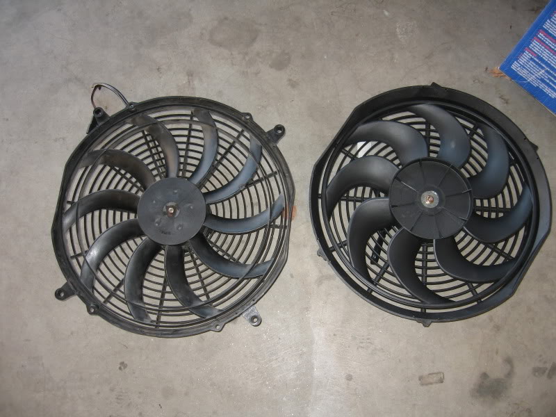

all one would have to do is put a thermostat/ temperature controlled fan on it......just like what is in most cars now a day.....

Thats right, they have little 10 inch fans at NAPA that move a ton of air. $50 if i remember.

part number VA08 AP71/LL...
the wiring harness is a bit different and you have to change it..and you have to drill the fan shroud for the new brackets....but this fan pushes way more air across the unit and keeps it cooler....I have had no problems since I change it and we get pretty hot here...
in some cases it is all about air.....where you live will set how you want to control it.....our winters don't get cold enough to worry about to much heat loss.....I will drop maybe 10 to 20 degrees in the winter...but I still have plenty of heat to clean with...up north if the ambient air temps effect your machines...then go with a stat controlled fan....you probably wont get great results.....but will to bet it will be good enough to clean with......
