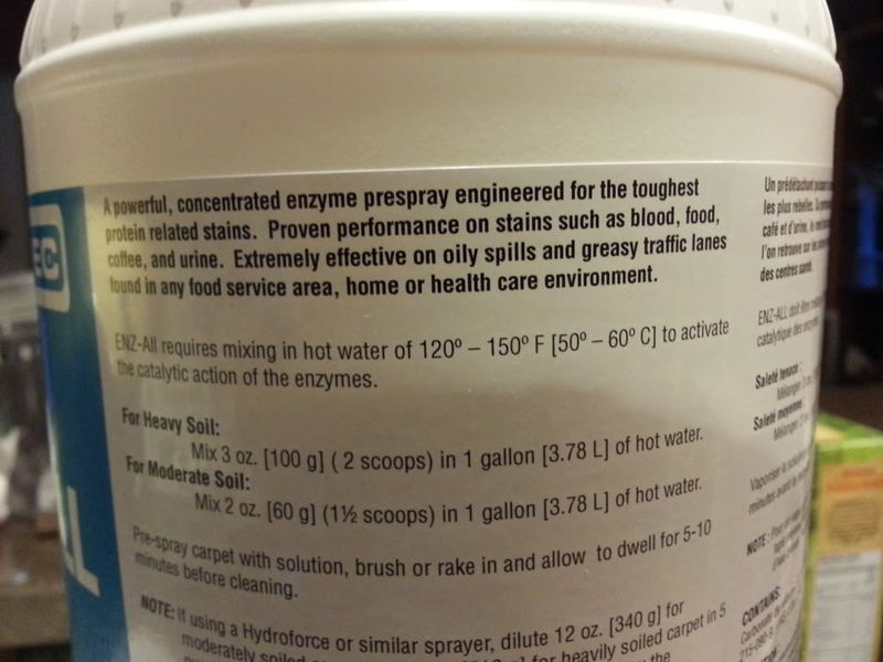

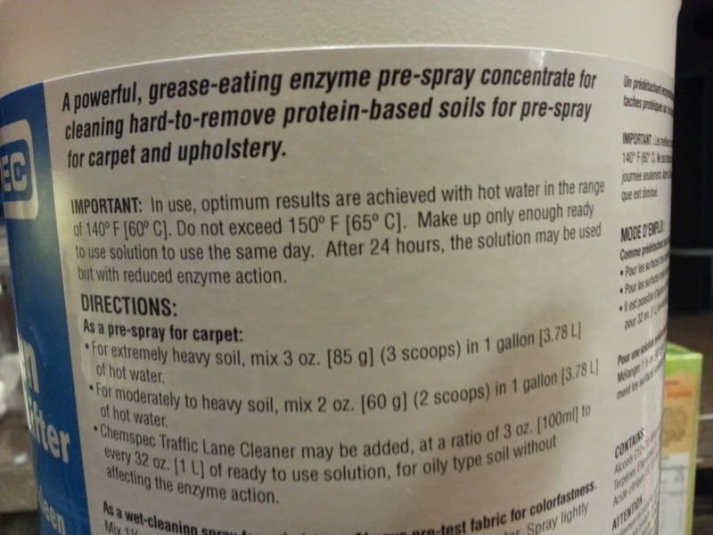

I got my Chemspec Prekleen and Enzall samples in the mail. It's been so long since I used PreKleen Id like to refresh my memory on the correct way to heat it up and put it down so I get the most from the enzymes.
Prekleen label
Enzall label
my question would be, is the water that I mix it with the concern or the water that flows through the Hydroforce the concern?
With only a 10º range to get it right I'm more than "concerned" that I'll be able to get a truckmount's heating system to produce water in that narrow range with out wasting time and water..
When I used Prekleen years ago I never worried about the heat much and got good results but I was nowhere near as anal about this stuff as I am now..

This is America...we don't use that commie celsius stuff...so relax...you have a 30º range to get it right
oops...only read the enzall label
edit:actually prekleen shows the same range on chemspec site
