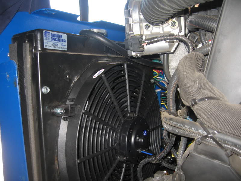

Very clean set up. I also have a Thermal Wave 2 and have the hardest time getting the heat under control. If I let it sit running for more than 3 minutes without running water through a wand or prespray after running the machine for 30 minutes or so it will overheat. The emissions light comes on a lot. I am pushing more for an Everest next I think. Ballpark for a setup like you have you are looking around $70K for machine, hoses, reel, truck, wrap, and storage?

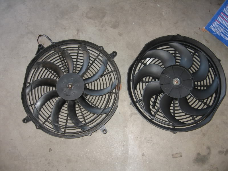

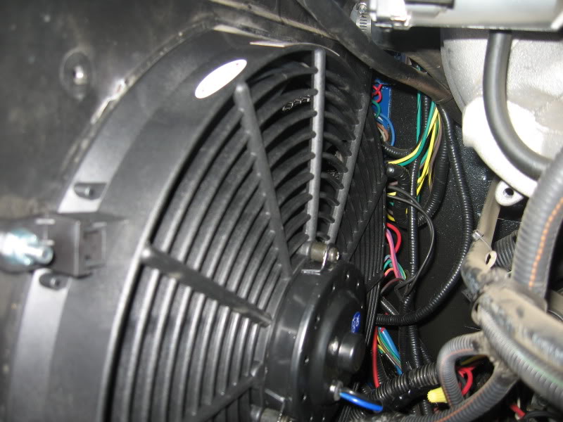

replace the fan....I had the same problem when I got mine...it just could not handle the heat here..
went to auto zone and pick one up....part number VA08 AP71/LL...
the wiring harness is a bit different and you have to change it..and you have to drill the fan shroud for the new brackets....but this fan pushes way more air across the unit and keeps it cooler....I have had no problems since I change it and we get pretty hot here...

I replaced mine as well and it helped a little but not as much as I would have liked. I was thinking of mounting one on the exterior and interior to push more air flow.

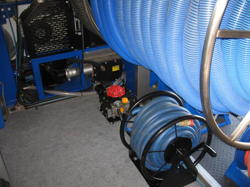

you can get it at home depot....they have all kinds of different style hook...baskets..just about anything you need to hang stuff.....

so that 2nd row is more to keep them from swaying around??
and the wand is just on the ground
Jim Martin
Arizona
Jim Martin
yes.....the second row keeps them in place when I have to stop the truck or when I take off...
the wand sits on the ground and has the top and second row to keep it from moving....
the wand i use the most hands on the hooks on the shelving...you can see it in the last picture up top with all the others.............
