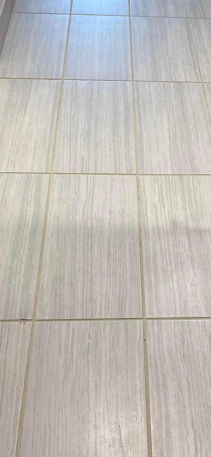

Here is the perfect example of which I speak
Nice MATTE finish porcealin tile, which could use it's grout cleaned.
Carpet cleaner guy sells them on his new revolutionary wonder coating that never needs to be stripped and reapplied, but rather scufffed and another coat layed.
The first coat is highly likley to do one of the following:
scratch
separate/lift
gouge
piss off the person who spec'd or chose the matte finish
piss off the person ('s) who can see that the coating is highly orange peeled
efflorese
look like crap.
AND LAST BUT NOT LEAST, RUIN THE SURROUNDING BASEBOARDS OR WALLS WHEN IT COMES TIME TO ATTEMPT TO STRIP IT, IN THE EVENTUALITY OF ANY OF THE ABOVE COMING TRUE.
and let's get down to the heart of why this plastic coating is going to make cleaning so much easier for the floor owner, the carpet cleaner instructed the owner to switch to a flat mop system.
add in the cost of furniture and appliance moving, relocating the owner for days, wall damage and many cleaners will go under, or worse.
scratch
separate/lift
gouge
efflorese
look like crap.
