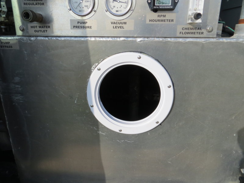

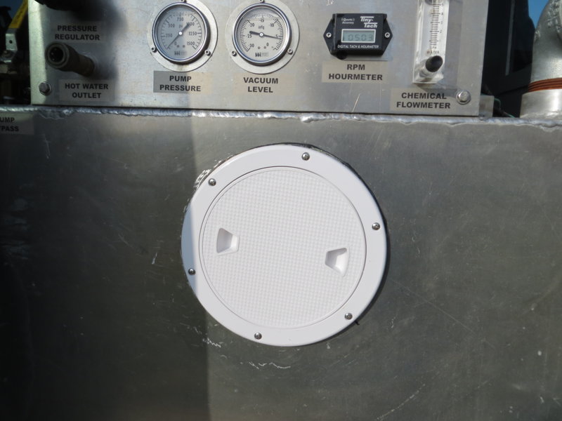

Here is what I did today. I've have the port hole for several weeks now but, just got time to install.

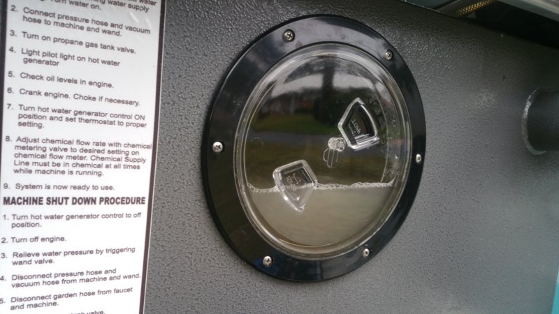

Dec 24, 2015 #3 dealtimeman Everyday is Saturday. Joined Sep 20, 2008 Messages 10,878 Location Fort Worth , Texas Name Michael No they don't, but you can spec it out with one. Just make sure it is a tough good and well made or it will collapse under the 16" of vacuum. Repeated flexing will eventually cause failure is why I believe they don't come like that.

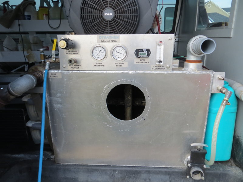

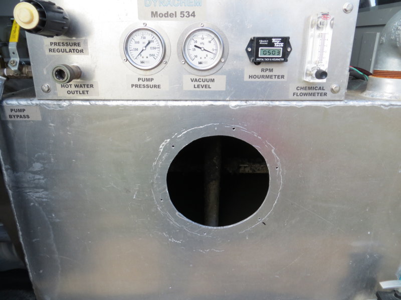

Dec 27, 2015 #6 GeneMiller Member Joined Mar 24, 2009 Messages 3,541 Location Boca Raton Name gene miller What did you cut the circle with
Dec 28, 2015 #7 realclean Member Joined Sep 4, 2012 Messages 429 Location Bossier City, LA Name Jesse Lowe GeneMiller said: What did you cut the circle with Click to expand... Jig saw with new fine tooth blades. I did make a gasket out of a very large rubber inter-tube. Reactions: dgardner
