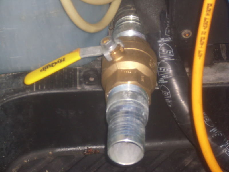

And be done with it... My PVC valve was a pita to open since day one. After I broke off both ears on the pvc valve I bought that one.
Art Kelley
May 19, 2007
4,200
Clawson,mi
Able 1 said:
That's a sweet smooth easy to open and close valve. You can get it at ChemDry, er, I mean Home Depot: they also have plastic ball valves. They don't cost much, certainly much less than the $99 White Magic charged me for a plastic ball valve that failed again in a year.
