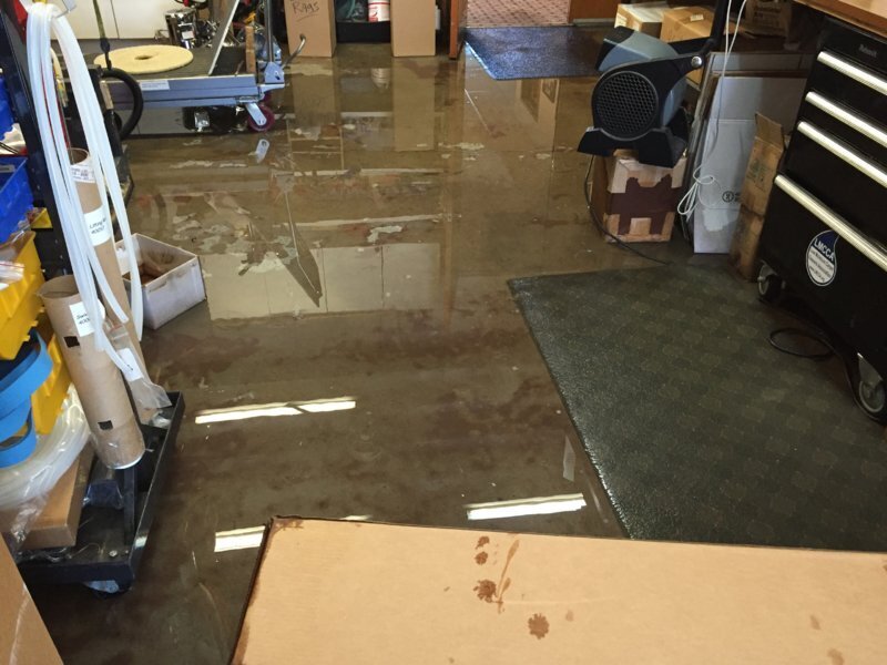

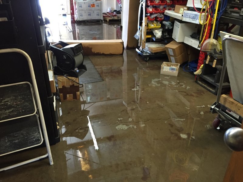

Here are a few shots. I took over 100.

It does look like most of the important stuff is up off the floor - could have been much worse. Did they determine what caused the leak?

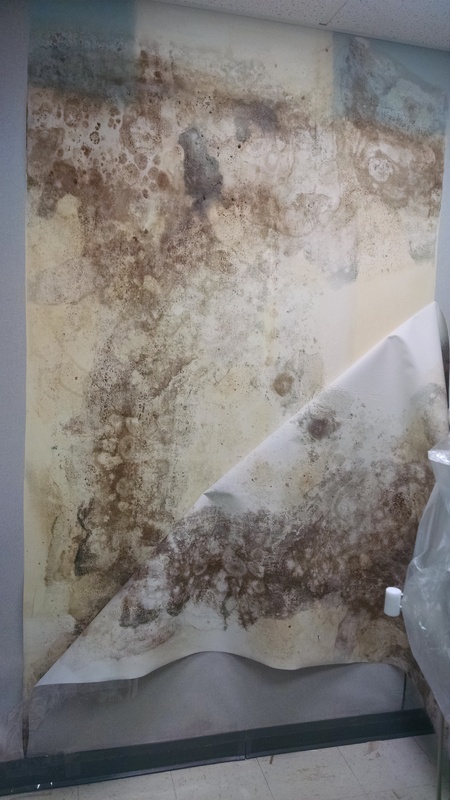

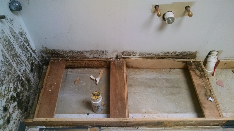

This is the type of damage possible IF you have any vinyl wall paper and moisture gets trapped behind it. This is a project we are currently working on.
This is also another area that should get attention when you get as much water as you did. Moisture gets trapped behind built-ins and if not dried thoroughly can cause you some problems.
Reactions: Shorty and Mikey P
Thanks for posting this Richard, many people forget or don't even think, that there can still be moisture trapped behind cabinets, etc;
These new FLIR IR cameras are getting cheaper and worth their weight in gold for finding moisture that the eye cannot see.
DON'T waste your money on the moisture meter with the IR camera.
Meter is good, camera is next to useless.
:yoda:
Bath tubs in homes is another area that can be overlooked.
Drying a home can actually be a little more challenging when there is a possibility of moisture trapped behind kitchen cabinets. You face a real dilemma when you have granite or some other expensive counter top over the cabinetry.
Don't let insurance representatives try to put the liability of the counter top on you the restorer. You can drill the toe kick and get air inside the box and then just cover the holes when dry. However the sure way is removal and that's where damage to the granite or other top comes in.
