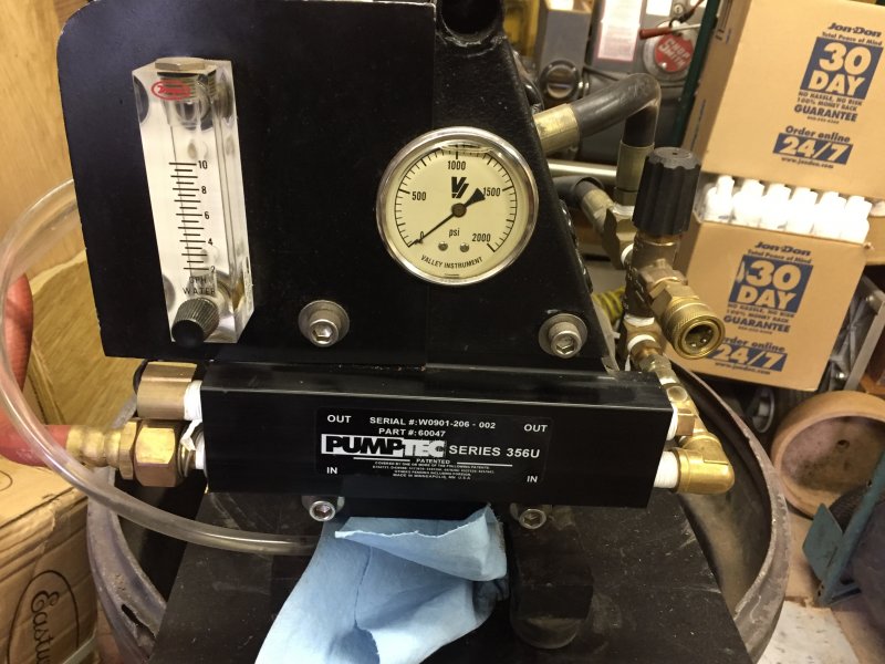

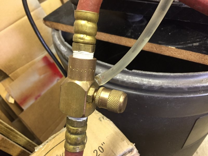

OK, here it is.
This is a J. E. Adams #7650 injector, 3/8" ports, installed just before the incoming water port on the 356 Pumptec.
On the other side of the injector is a 6' long piece of 3/8" hose that acts as a primer for the pump so it can operate gravity fed from fresh water tank, or will operate connected to a faucet under pressure. There is a brass one way check valve at the end of the 6' piece of incoming water hose, so the pump keeps it's prime even when disconnected from a water supply. This pump alone will not prime itself, but with the leader hose and check valve, it will.
The clear tube comes out of the injector and goes to the Dwyer meter. The 7650 has to be adjusted to either gravity fed, or pressure fed from a faucet, so it accurately injects chemical into the incoming water stream. The 7650 adjuster is a knurled knob on the injector with a locking nut so vibration will not affect the setting.
The second pic shows the modified front of the Otter in order to install the Dwyer on the front of the pump.
With this setup you have a very powerful pump as it puts out 3.5 GPM.
Reactions: Spurlington

I gather you are saying that the chemical injector works when connected to a faucet. I have never been successful in doing that as the incoming water flow is greater than the outgoing discharge. Does that injector pinch down the flow somehow?
Bob Savage
Cleaning Professional
1,288
Bob Savage
When using this setup it does not sacrifice ANY flow going to your wand, that's why the Dwyer is added. You have also converted this pump to always being primed, so you can even draw incoming water from a 5 gallon bucket, fresh water tank, or a faucet, all features that the pump itself does not possess.
The pump also runs dual wands. We have done this with a 2" wand at 8 flow, and another wand at 6 flow, for a 14 flow total, with no noticeable drop in flow/pressure when cleaning.
A simple tweak of the knob for faucet or fresh is all it takes to set the incoming flow of chemical.
This setup works just as well as the Cat pump in another dual wand TM we use. The Cat pump will pull prime by itself.

So youre running detergent thru the pump .. do you rinse it out after using? I went onto J.E Adams website and looks like you can put the injector on after the pump. Did you have the plate holding the Dwyer meter made or can I get it somewhere? Thanks alot for the pics n description !!
Bob Savage
1,288
Bob Savage
I made it. It's a piece of aluminum painted black to match the pump.
Yes, thru the pump with the detergent. I have NEVER rinsed it out.
I also run detergent thru my Cat pumps, and one of them is 32 years old. I have rebuilt them when they needed it, but saw no signs of any other internal problem inside the pumps running detergent thru them.
