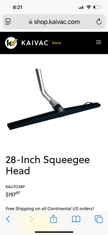

This with a Rigid wet vac is the cats ass for stripping small floors. I wouldn’t even want to get a good Mikey floor tool in that. It will swivel to even get behind toilets beloit or not.
It’s gone up a hundred since the last I bought, but it’s so worth it.

9,750

9,750
